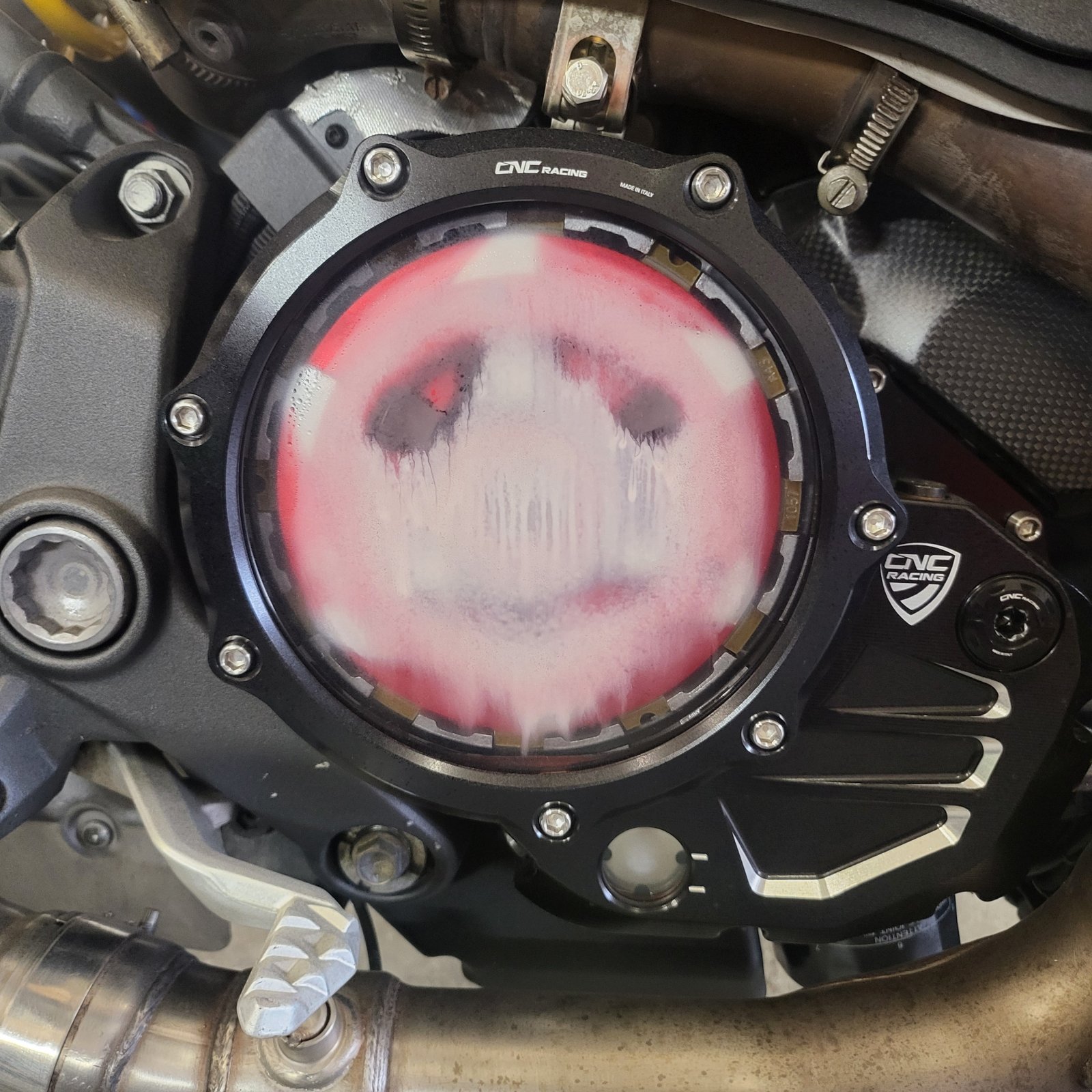

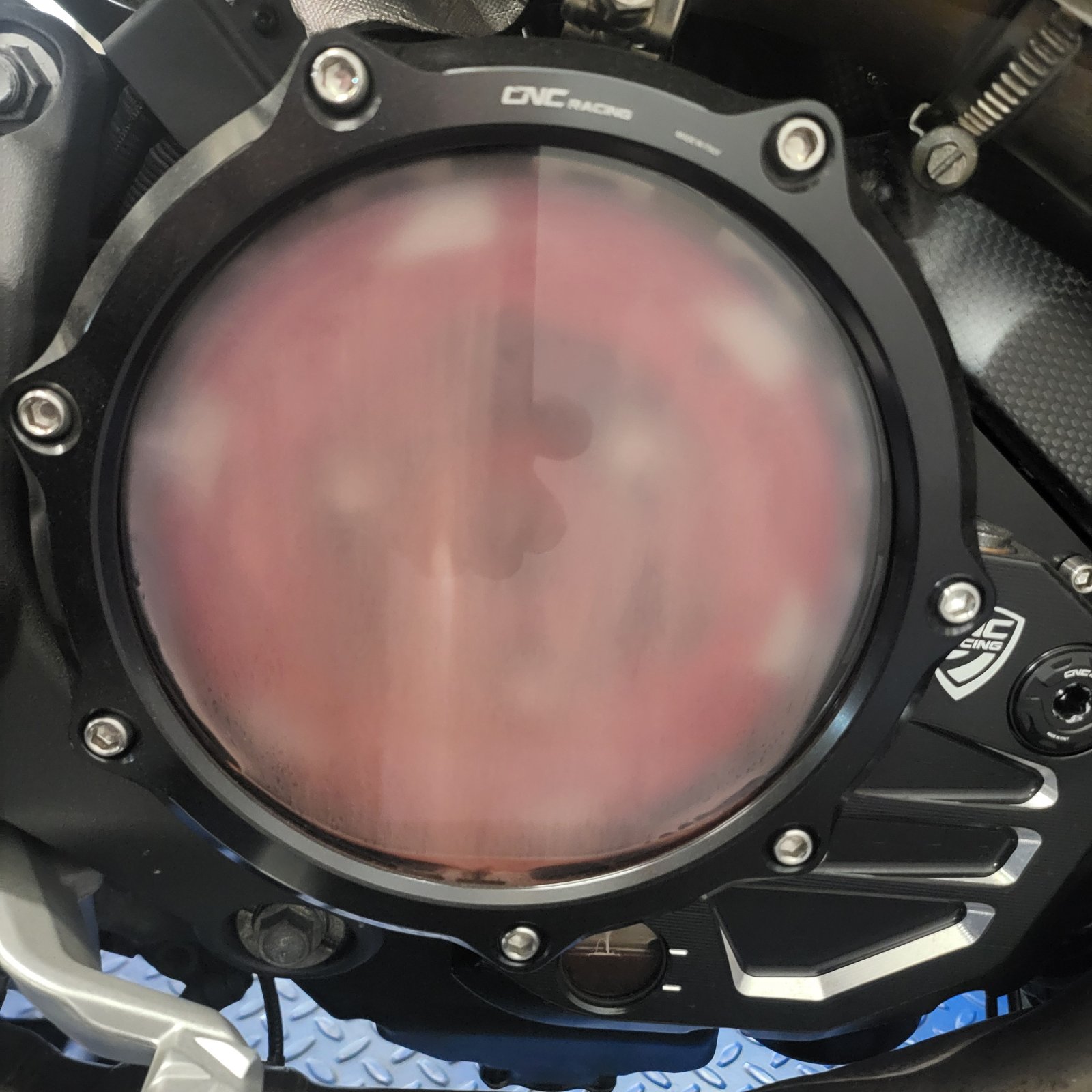

  1. Bike ran to temperature then battered on the dyno for 10 minutes. Still finding moisture in the oil. So unless you take the bike for a good 30 minutes ride I would say you are doing more harm than good.
    Ran it for another 20 minutes after this to clear all the condensation
