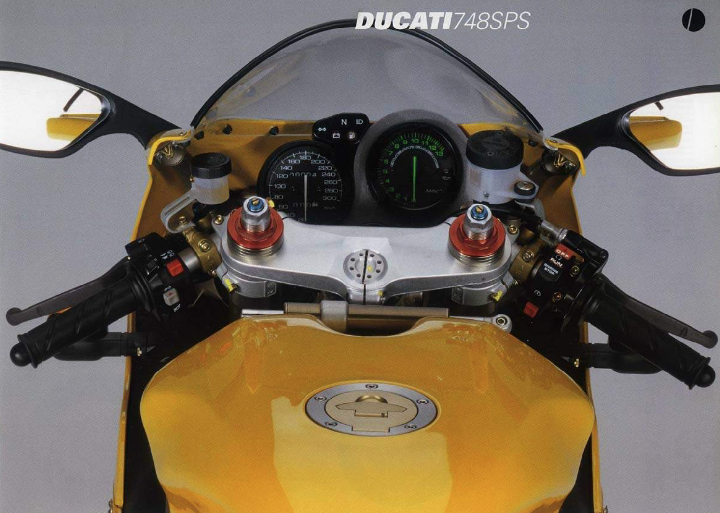

  16. The factory leaflet/data sheet for both the 1998 and 1999 748SPS shows their yoke clear of a plaque (see below). In fact and to the best of my knowledge, the plaque concept appeared rather late on the 748 range and is only to be found on the R examples of 2001 onwards (at least officially and in Europe).

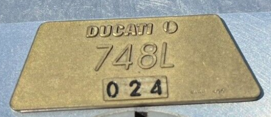

    The only exception to this is exclusive to the US market, where in 1998 some 100 numbered (with plaque) examples equipped with the base 748 engine (all mercury silver in colour and with some other cosmetic touches) were commissioned by Neiman Marcus retail store from Ducati North America and sold through that retail's store catalog (picture of the plaque of that model sourced online follows below).
