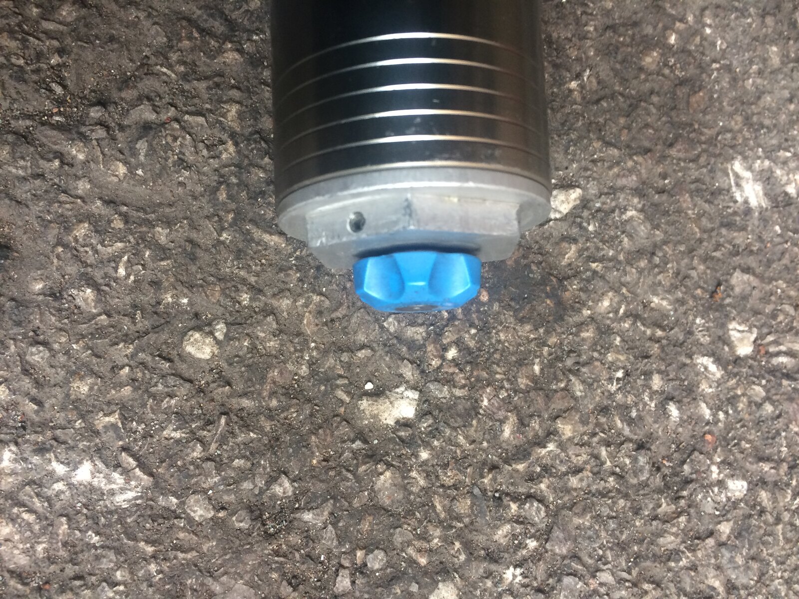

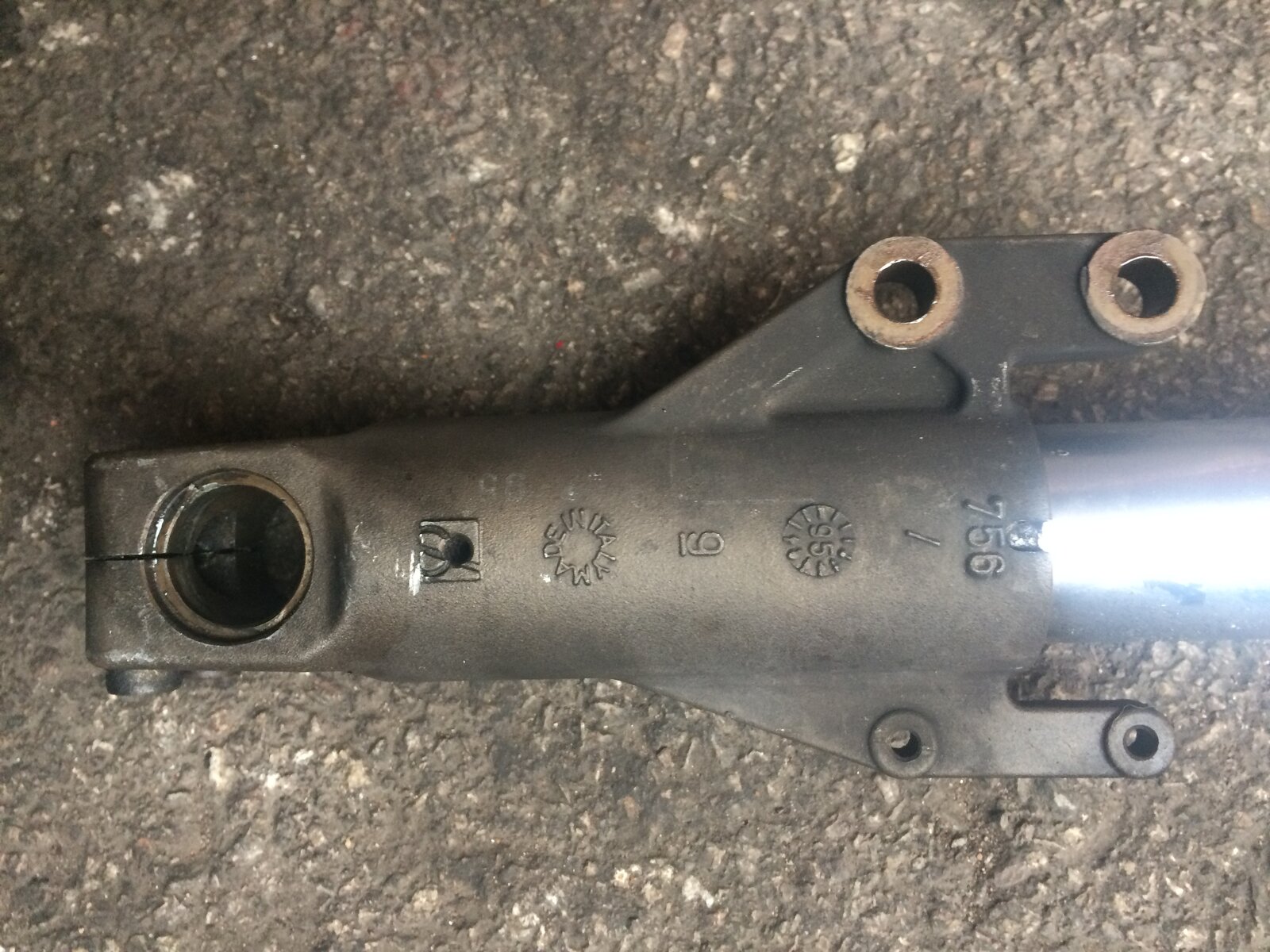

  12. A22E8F08-005B-43F1-8C51-599B93DD4A39.jpeg F155E040-4503-4802-BA31-4B259F69FF48.jpeg Now there’s a surprise, Showa forks fully extended (bike on Yoke stand) from centre of axle to join between ally top cap and fork 720mm, Marzocchi same measurement 725mm, I’m assuming they are Marzocchi, doesn’t say Marzocchi on them.
