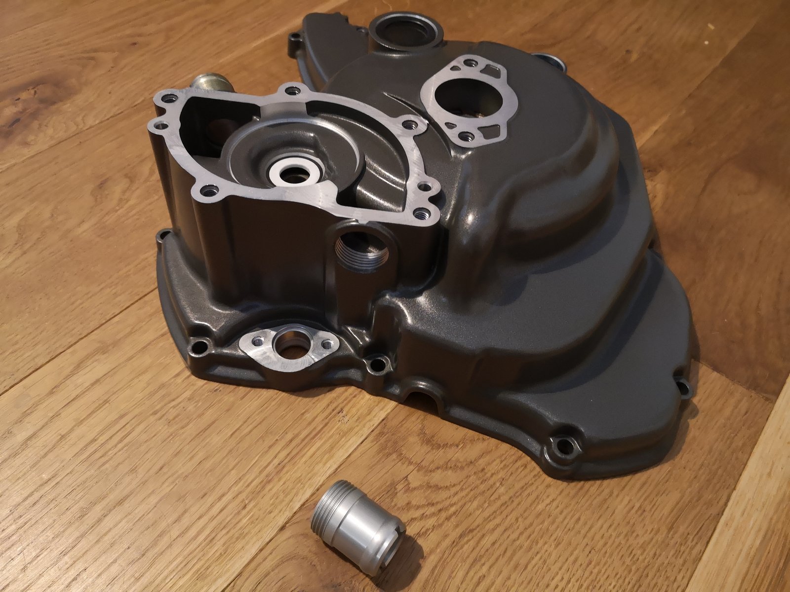

  1. Its that time of year to start doing doing some updates! Picked up a new LH side cover to replace the original which looks a right mess, leaking clutch SS caused.
    The new cover needs the coolant outlets fitting, anyone know what the the Factory used as sealant?
    I could use PTFE tape, Locktite Hydraulic sealant etc... however interested what was used in Bologna. Side cover.jpg
  2. Ducati liquid gasket (AKA three bond) 942470014 or TB1215 £18 a tube from a reputable dealer
  3. Yeah 3 bond mate
  4. Ok, thanks Denzil/Alistair, I couldn't find the info anywhere. Will do the job in the next few weeks.
