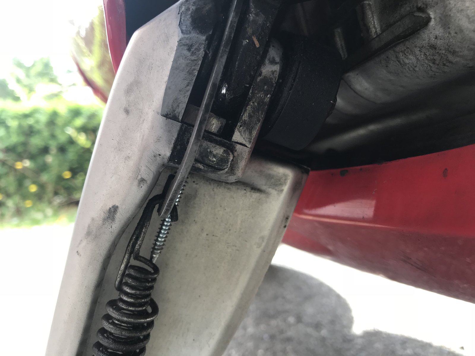

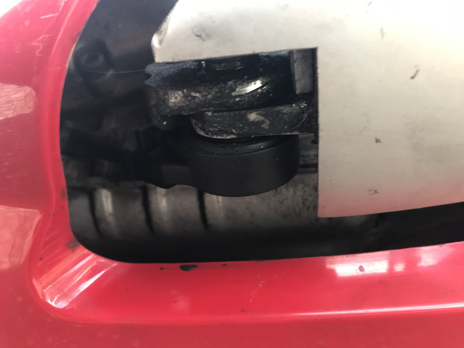

  7. Hi. That’s exactly what I was looking at doing. Can you tell me how you fixed the steel.
  8. I drilled a counter sunk self tapping screw (dry lining screw) straight through the steel and into the stand and counter sunk the head into the steel
  9. Ah ok thanks. That will work. Im toying with the metal weld stuff. I’ve never used it but I believe it’s quite strong. I’d you were to do it again would you use the same thickness of steel. Does this give you a “normal bike” lean now?
  10. If I was to do it again. I’d do exactly the same as it’s now got a perfect lean with steel touching steel
  11. If I was to do it again. I’d do exactly the same as it’s now got a perfect lean with steel touching steel
  12. Any chance of a pic of the repair?
    Thanks
  13. I’ll try taking a few at the weekend
  14. Hi Danny the would be great, mines just starting to lean a bit far, my street triple did the same but I didn't have that long enough for it to bother me
  15. Here you go as promised hope you can work it out from the pics
  16. thanks for the photos it's appriciated, it looks like inside the fork of the top of the stand you have added metal is that right?
    #17 xander296, Aug 4, 2018
  17. Yes that’s right. Gives a perfect lean now
  18. Nice one Danny. That’s really clear. I’m going to do the same. Going to try using metal weld instead of the screw. Really appreciate the piccys
  19. Less clear to me I'm afraid
    Maybe you could do a diagram Alastair??
