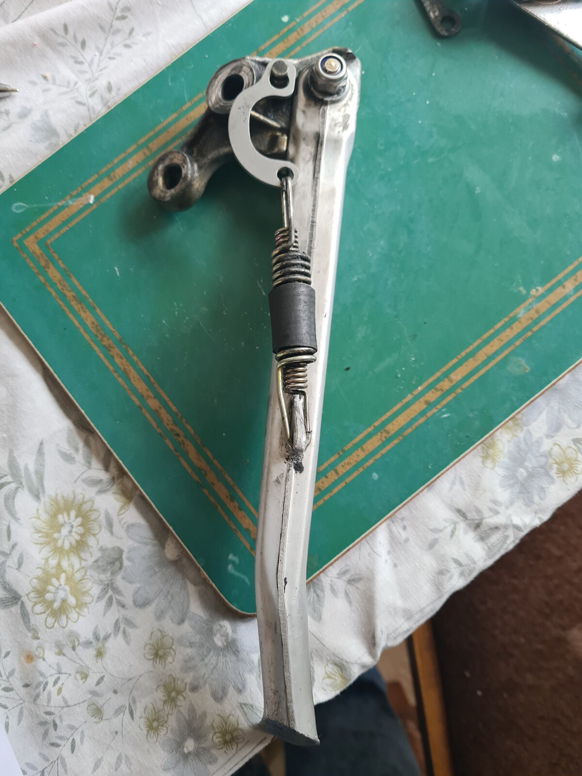

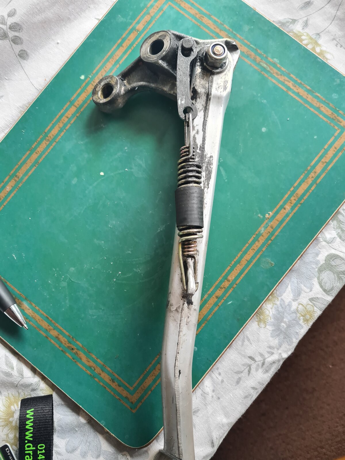

  1. Some newbie help please. i have just got my hands on a 748 2000 model. The side stand wont stay down and it does lean over an awful lot. Can you get a longer stand as there seems to be two sizes and i assume it just needs a new sping to get it to stay down. any help would be appreciated as now i have it i think i will need to be a frequent visitor

  5. The 748 of that era was fitted with a suicide stand, as soon as you stand the bike up, it springs back into its park position. Simplest fix is to fit a side stand assembly from an 848/1098. It is designed to stay down until you kick it up and as has been said, is a bit longer which reduces the lean angle. Andy
  6. as said, 848/1098/1198 stand and forged mount are a straight swap.

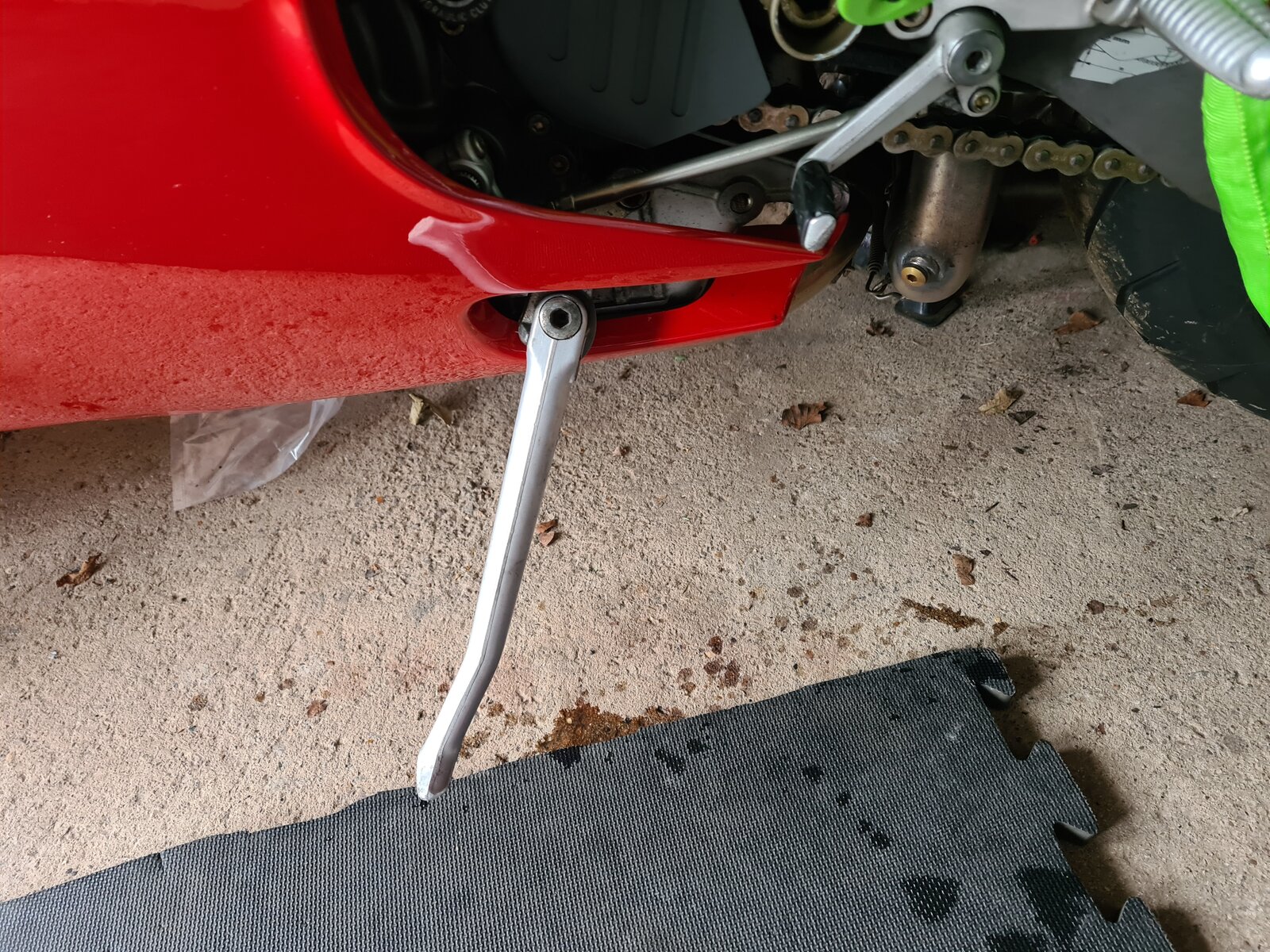

    Reason for leaning can be:-
    Worn or loose pivot or aluminium stand - easy to check visually as the stand "loads up" while you lean the bike to park it.
    Loose or damaged forged brkt fixings - this is fairly common and if only loose then it's a satisfying fix.
    Rear suspension has been raised considerably, this will make even a brand new, no-wear present, 748 lean over further than ideal.
    It could be one of these or a combination of any of these.

  8. I put the 1198 stand on my 996 big improvement
  9. I have fitted 848/1098/1198 stands on both my 916 and 998. Night and day! The stand only is plug and play. No need to get the entire assembly if you only mean to reduce the lean angle.
