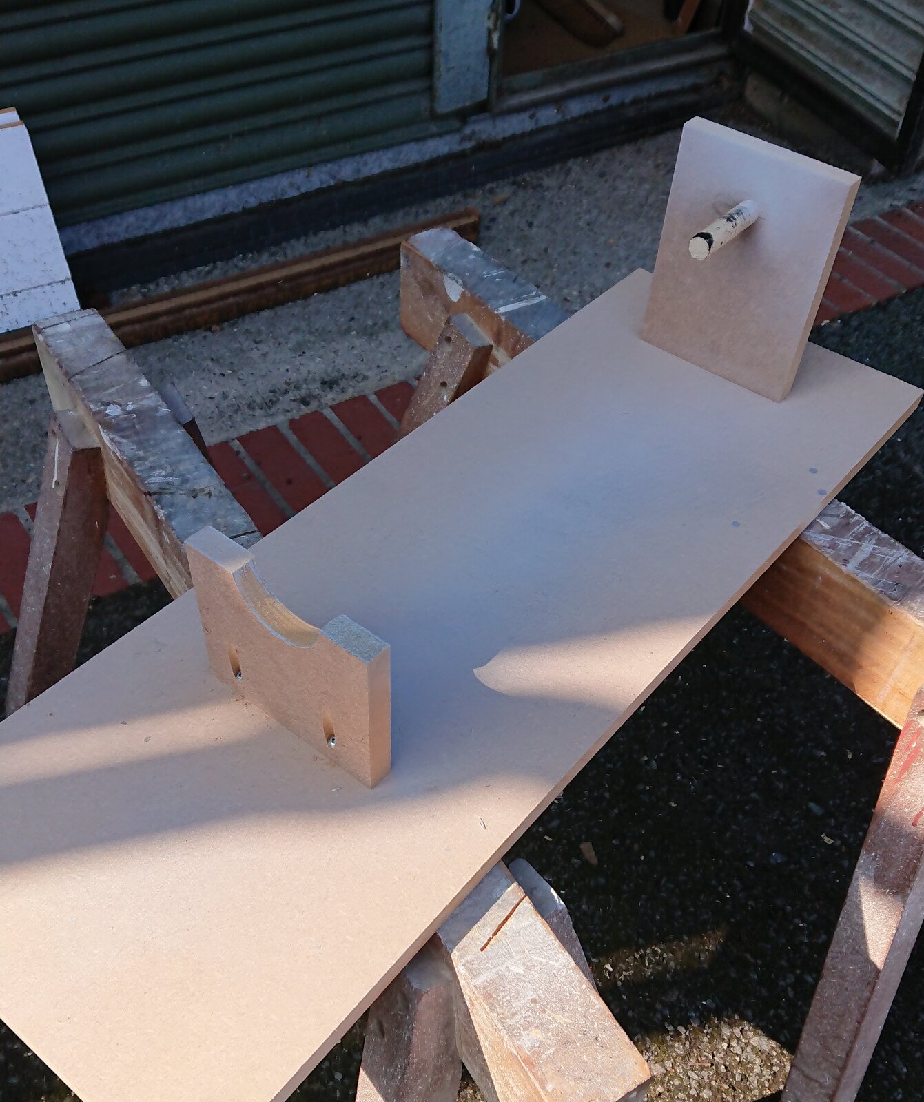

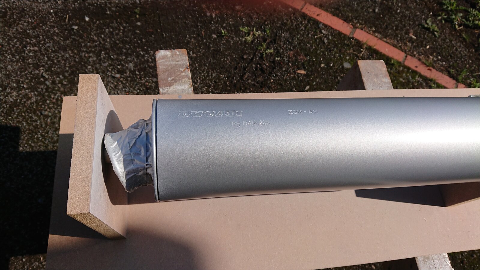

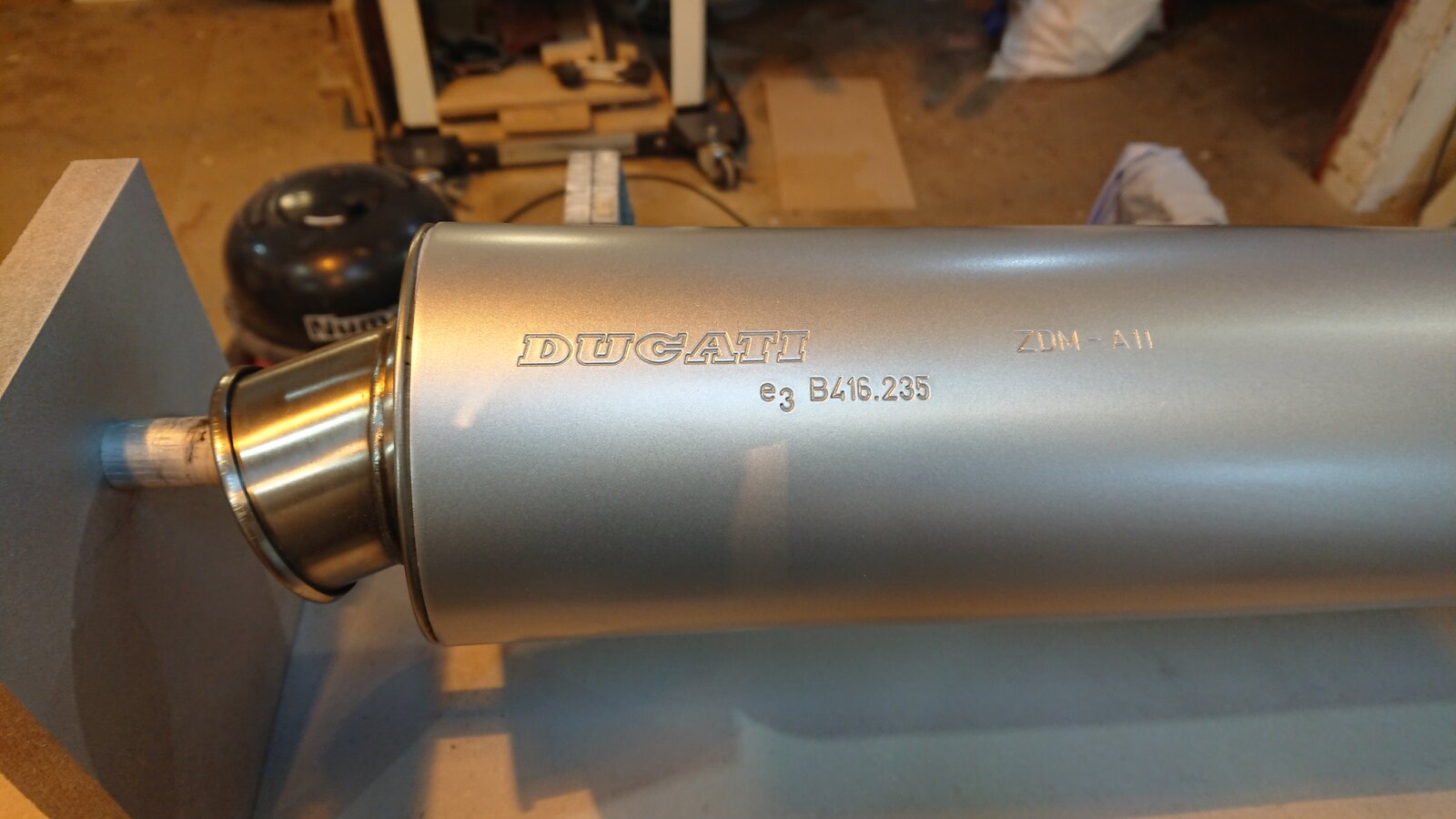

  1. My silencer was looking a bit tatty and had some scrapes so I resprayed it with RAL 9006 in an 2k aerosol and the results look good. I didn't drill out the rivets and separate the parts of the silencer - I masked off the end pieces with tape. This is 30% gloss and I used a white primer.
    Before I started I made a cradle that allows the silencer to be rotated along its length, this makes spraying the paint easier than having it hung vertically and makes sagging less of a problem. Cradle.JPG DSC_0169.JPG DSC_0170.JPG

  5. very nice, good work. (excuse me I know nothing of paint, presumably heat is not a problem?)
  6. I wouldn't use the same paint for the headers but l think it will be OK for the silencer. I used a paint that hardens chemically not solely through evaporation of solvent so I think it will be fine.

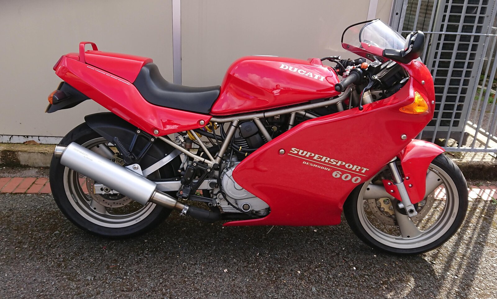

  7. Here you go.
