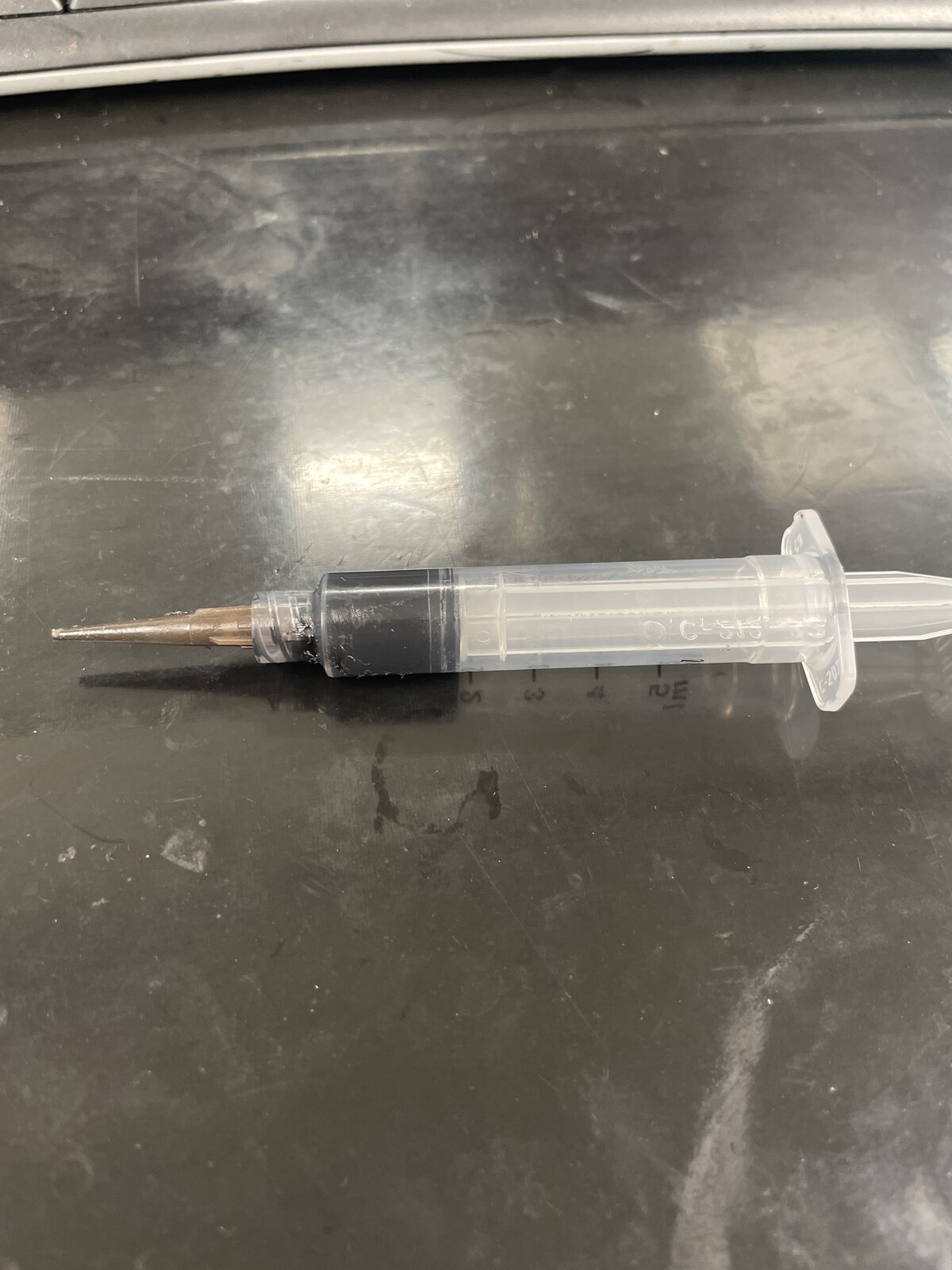

  6. Cheers boys... :upyeah:so when I next need to take the covers off it's deffo gonna go back together with RTV silicone.
    I do like the ones that come with an applicator mind as it's got to to make it so much easier to get an accurate continuous thin bead the length of the complex shaped thin walled multiple bolt hole covers - both have 10 screw holes.
