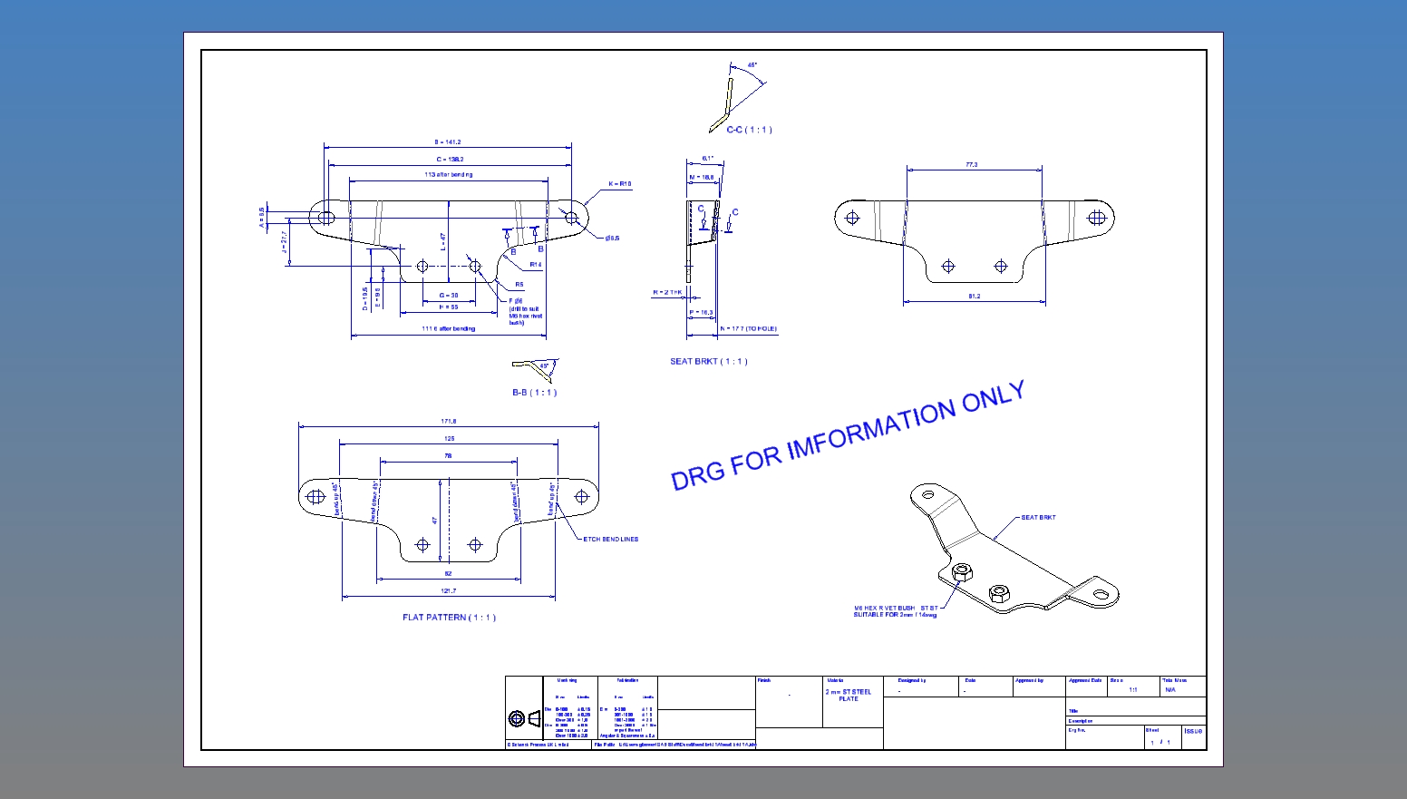

    I would give the painting a go myself, but would not want to spend all my effort on a seat unit that was not very good and cracked after a while. I have see some dimensions of a seat bracket (83011261A) on here but the dimensions were a bit hard to follow. If anyone has an original bracket I could measure up (around Rotherham / Sheff / Worksop / Doncaster area - no I won't knick it) or wants to make a drg with loads of dimensions on I could model it up and get a .dxf file for the profile if someone knows a cheap profiler. The bending does not look too difficult. If I can help with any profiles for anyone I will.
    Cheers Gaz

  17. seat brkt 1A.jpg All,
    I've done this if anyone wants to make their own. Hejira858 had an original bracket so thanks for that. Sorry can't help with back brackets at the moment.
    Image is just a JPEG. If you want the Autocad or .dxf file PM me
    If there is anyone out there that can profile me a few to check for a couple of sheckles or better still free (well Iam from Yorkshire) it would be appreciated or if you want the file and produce them yourself go for it, drawing and dimension supplied in good faith and not tested so don't sue my ass if something f@@ks up.
    Cheers Gaz
