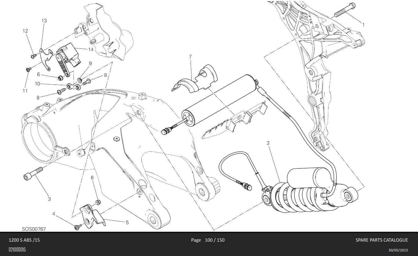

The original Skyhook suspension, as implemented on Multistrada 1200S MY2013 used 4 sensors (all accelerometers), see the Ducati training video: With the introduction of the DVT model in 2015, the Skyhook system was modified to include "new software, a rear travel sensor and the IMU refine the system and add more control to the damping in corners" (from https://www.morebikes.co.uk/16493/2015-ducati-multistrada-1200-review/). I've just looked at the parts catalogue as I didn't know where this sensor was located (item 14): Below is a description of the suspension of the 1260S model (from https://www.mcnews.com.au/2018-ducati-multistrada-1260-1260-s-1260-s-d-air/3/) The DSS (Ducati Skyhook Suspension) Evolution system has now been developed further. This evolved version includes a new Sachs fork with pressurised damper cartridge and low-friction stanchion, a sensor to control the action of the rear damper plus software that also handles data from the Bosch IMU and features new algorithms. Included as standard on the Multistrada 1260 S, the DSS platform has a 48mm Sachs front fork and rear monoshock, both electronic; this allows the DSS to continuously adjust hydraulic damper compression and rebound using semi-active control to ensure correct vehicle balance. In the DSS Evolution system, settings have been further refined to maximise performance, safety, and comfort. DSS Evolution technology analyses data from numerous. An accelerometer on the steering yoke, and one inside the control unit that tracks the DDS Evolution provide data on sprung weight while an accelerometer on the fork bottom provides input on unsprung weight. At the rear, another sensor measures suspension travel. The DSS Evolution processes this information via a semi-active control algorithm that, by referring to an imaginary fixed point in the sky above the bike, makes extremely rapid adjustments to the hydraulic damper to minimise vehicle movement in relation to this point. To smooth the longitudinal forces of acceleration and deceleration, the system also makes use of the Ducati Traction Control (DTC) longitudinal accelerometer sensor, the ABS system pressure detectors for rapid calculation and activation of a response that reduces resulting vehicle oscillation, and the data from the Bosch IMU which dynamically reveals the bike’s attitude on the two axes (roll and pitch). I hope the above helps shed some light on the mysteries of DSS.
