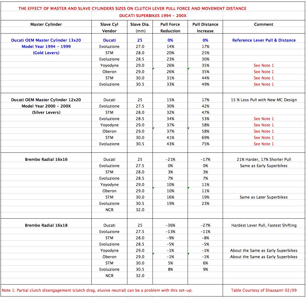

  2. Thanks Chris but something doesn’t make sense to me. Within a few days of bleeding, the end of my clutch lever is moving 20mm before it loads up (10mm after bleeding) and I then have difficulty engaging neutral. Total movement before it hits the bar is 75mm, so 15% reduction in travel is enough to cause problem.
    The Oberon has 29mm piston, the Ducati 25mm ref the table, so 35% reduction of movement! And yet many people report that the Oberon is fine.

  15. On my Multi 1200 switching to an oberon slave just exacerbated the air problem and I had trouble engaging neutral earlier than without. So if it's not the slave at fault you may find it get's worse before you replace the part that makes it better.

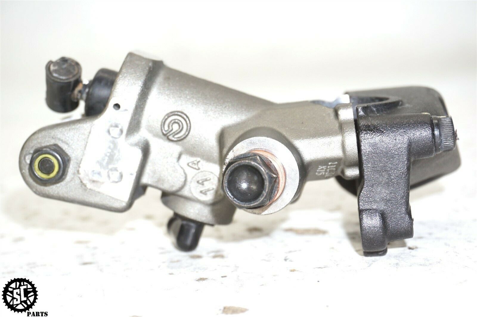

    I think you will also have a 15mm master but check for numbers on it like shown here between the banjo and the handlebar clamp
    When I brought mine it came with an extender for the push rod but it wasn't needed.
    Here's the chart with the Oberon included, as you can see it's one of the combinations at risk of bad

  16. I answered the rod length concernin that oberon supply their slaves with it, gave a newer version of the chart you are (observe the presence of Oberon) using and said how to check the piston size on the clutch master, what do you feel I've missed. :thinkingface:
    It's not like you helpfully told OP the Oberon was a 29mm slave when posting that chart.
