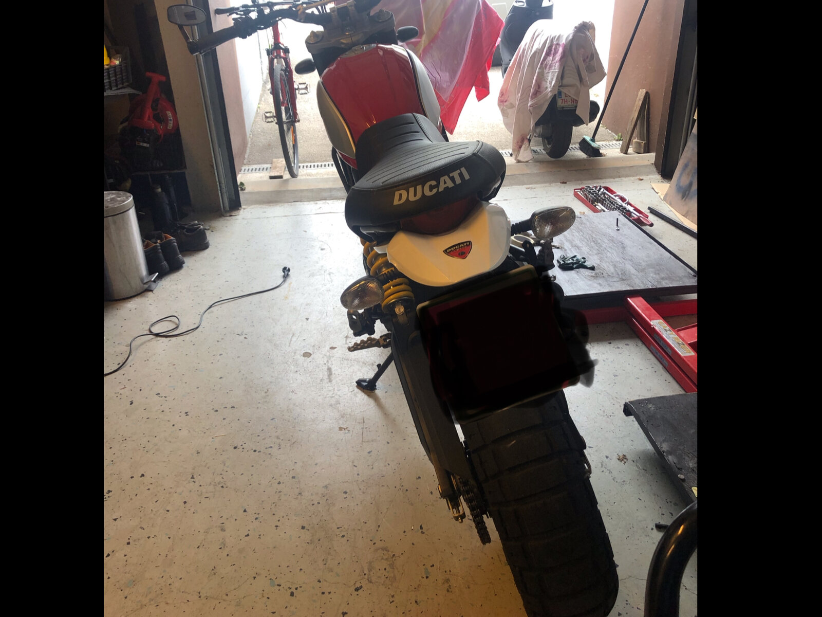

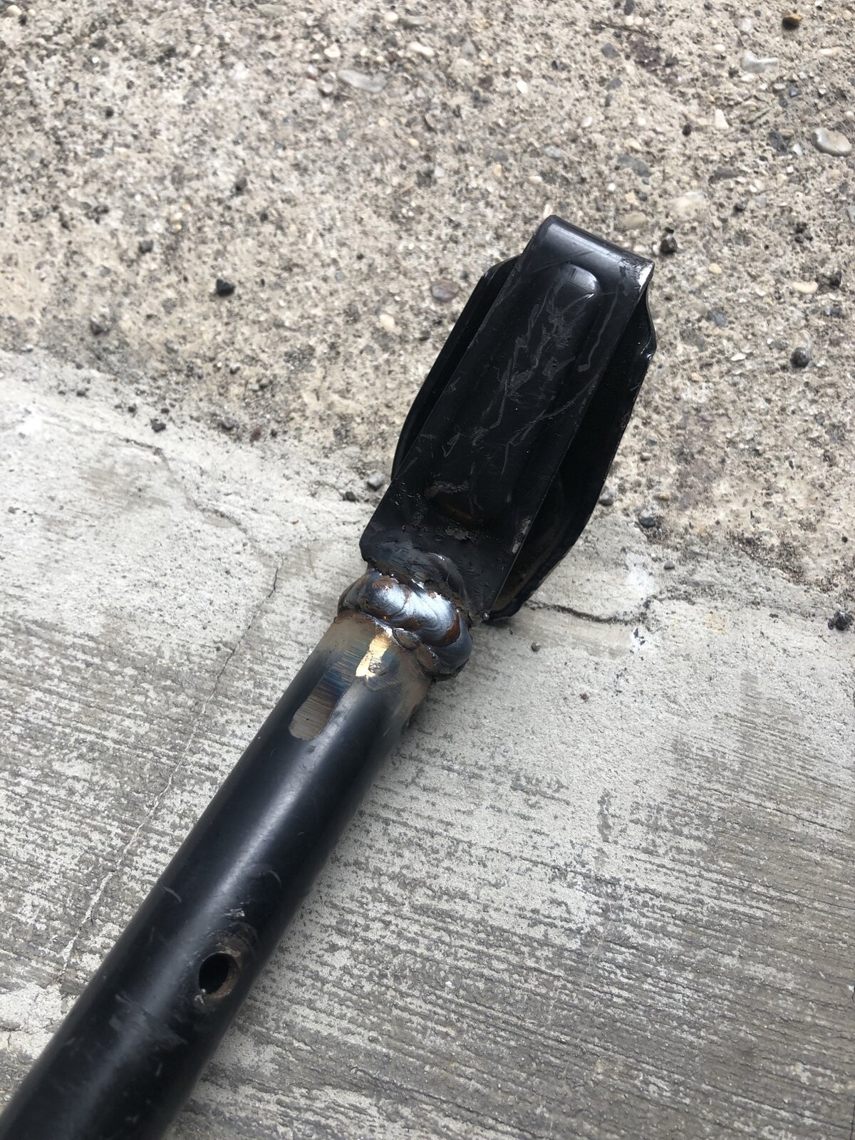

  1. FECC637B-3823-48E1-B3D7-D2315A426C06.jpeg 5884A920-C539-46CB-B50A-62A5B1E12DF6.jpeg The sled sits too upright on the side stand, makes it unstable if the stand sits on a raised area and being short always a problem mounting the bike, so I cut a bit out and dropped the lean on the bike, easier to get on and off plus sits better on parking. If Anyone is wondering why the screen captive rubber is screwed to the stand? When the stand is up being short found that it was hard to kick down the stand, tapped out a hole and screwed a screen screw and captive rubber to the stand.
