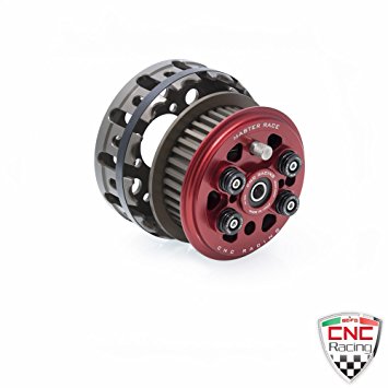

    This is how my clutch looks like, it was installed by the previous owner.

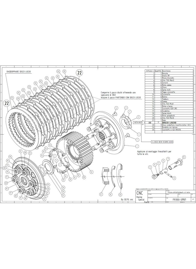

  5. So here is a diagram which looks totally alien to me. The clutch mechanics do not use a spider spring or ball and ramp to provide the slip which is far outside my experience so I am unable to offer any advice. I have been unable to find any set up instructions but I infer from one piece of infirmation that your clutch may be in a locked position which is engaged to use an external starter. Hope you find a solution. Andy
  6. In this picture, there are 4 clutch springs and then a silver peg. If the silver peg is still in place on your clutch then that's the issue. That is a locking pin to allow the use of a starting dolly.
    The parts diagram above, provided by Andy is for a 6 spring "road" clutch. If you have 6 springs then I can't help straight away. It's quite a unique design that I've not seen before... More info, pics of your clutch would be good.
  7. Yeah, I have the 4 spring version, which I guess is a discontinued product. I've never seen the silver peg and I've wondered what was its purpose since all the manufacturer's photos included it. But no, my clutch doesn't have it installed anymore. Do you reckon the 4 spring version has similar internals? The 6-spring MasterTech has "interchangeable cams" according to CNC Racing's webpage, but I sure don't have any extra cams laying around.
