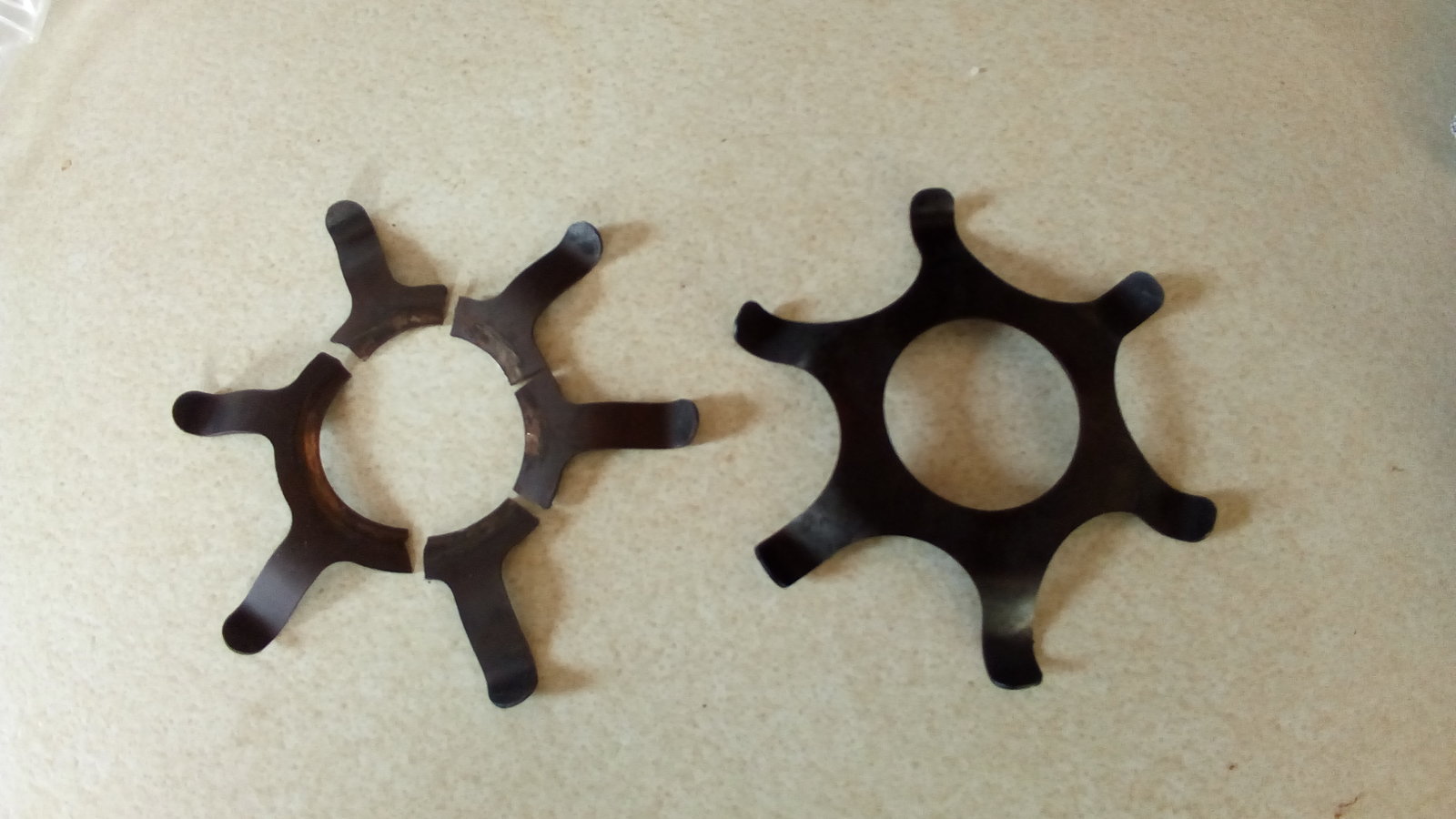

  1. I was puting the new pressure plate bearing in and as i was reinstalling it on the bike i noticed the flippin spider spring is in pieces...

  4. does it use the 'narrow finger' version (001MG017) or the later fatter type (as linked to above)?
  5. It's the narrow one...

  9. Is it the same as the one in the 'R' slipper?
  10. I can get the 'R' slipper spider Spring for £59 from alfs motorcycles, in Worthing.
  11. 749R? - not sure but the part number should confirm it - STM equiv part No is 110638
  12. yes Steve it is, if I ever buy a slipper new I would plum for one incorporating that or similar.
  13. it's close but a it doesn't look quite right and a combination of poor pictures and no cross-ref of part numbers would put me off risking it. If we all keep looking then could get a proper result soon :upyeah:
    EDIT - i remember this one now - pretty sure it does fit and lasts a bit longer than original due to design.
  14. I think im gonna go with the one from the 749r model but i have had some emails back. Oberon dont have them but Stm do one for €63, anyone know if theres a uk distributer?
    Cheers
  15. £59.06 from alfs motorcycles.
