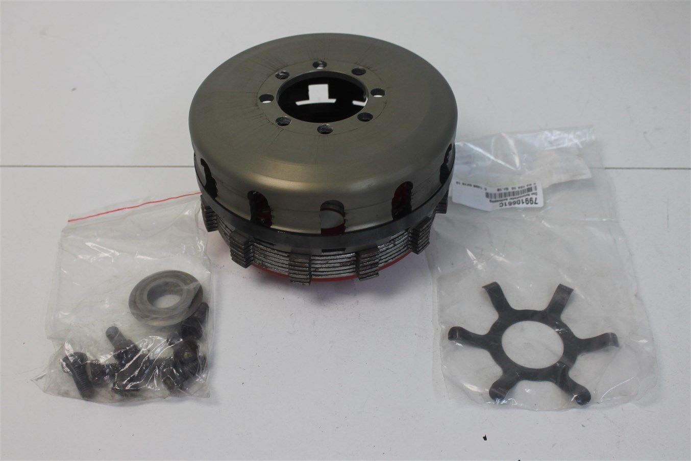

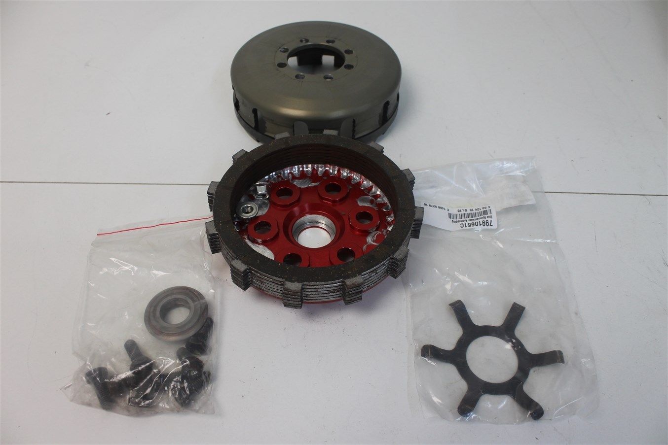

    Could I please ask for some advice from the expert knowledge available here on the Forum. I'd like to install a slipper clutch on my '98 916 Biposta and I have found a used STM assembly for sale from a 2002 748R, will it fit my 916?
    Thanks,
    Bob.
  2. Yes it will however the condition of the used clutch is critical. If you have pictures post them please. Andy
  3. Hi Andy,
    Here you go.
    Cheers,
    Bob.
  4. The plates look ok ish, but that basket has seen better days, the pressure plate has quite a bit of damage/scuffs on the face to. Is that it all, because the drum assembly is missing and its that which makes it a slipper clutch.

  9. Thanks for posting pictures, the value of them is immediately obvious as you would have been taken for a ride without the advice. @nelly is spot on as usual but we have come to expect that :). If you Google "Bucci slipper clutch" one of the hits will be the very good assembly instructions and diagrams which are useful. Most modern slipper clutches have aluminium alloy or Ergal baskets which wear relatively quickly as the non friction plates in the clutch are made of steel, just a fact of life I'm afraid. The original 748R slipper has a steel basket when wears less quickly but can be a bit more janggly (if that is a real word). Be wary of used clutches but that said, good ones do come up occasionally. Andy
