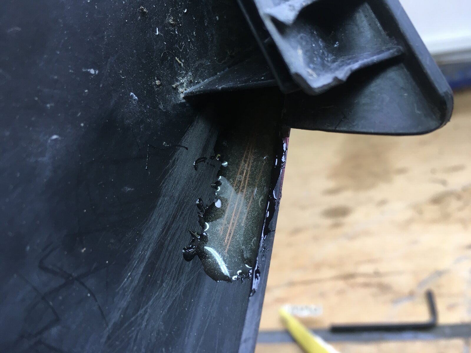

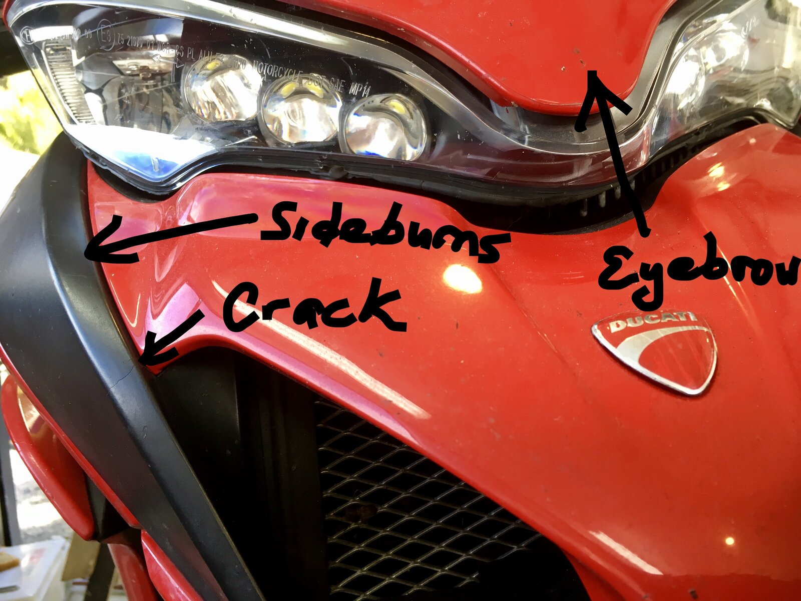

  1. IMG_1531.JPG IMG_1532.JPG So I had removed the sideburns, eyebrow, screen and bracket and headlight so I could shim out the headlight unit to lower the low beam. I have been procrastinating about this for ages.
    Anyhow I noticed a small crack and took the opportunity to repair it before refitting it. I sanded it out and then laid some strands of wire in a bed of araldite to reinforce it. Hope it holds ok, knowing how these fairing plastics are notoriously hard to glue up...
