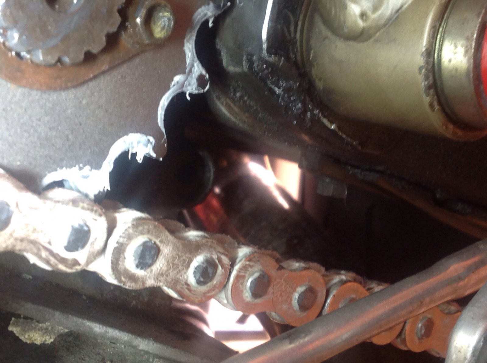

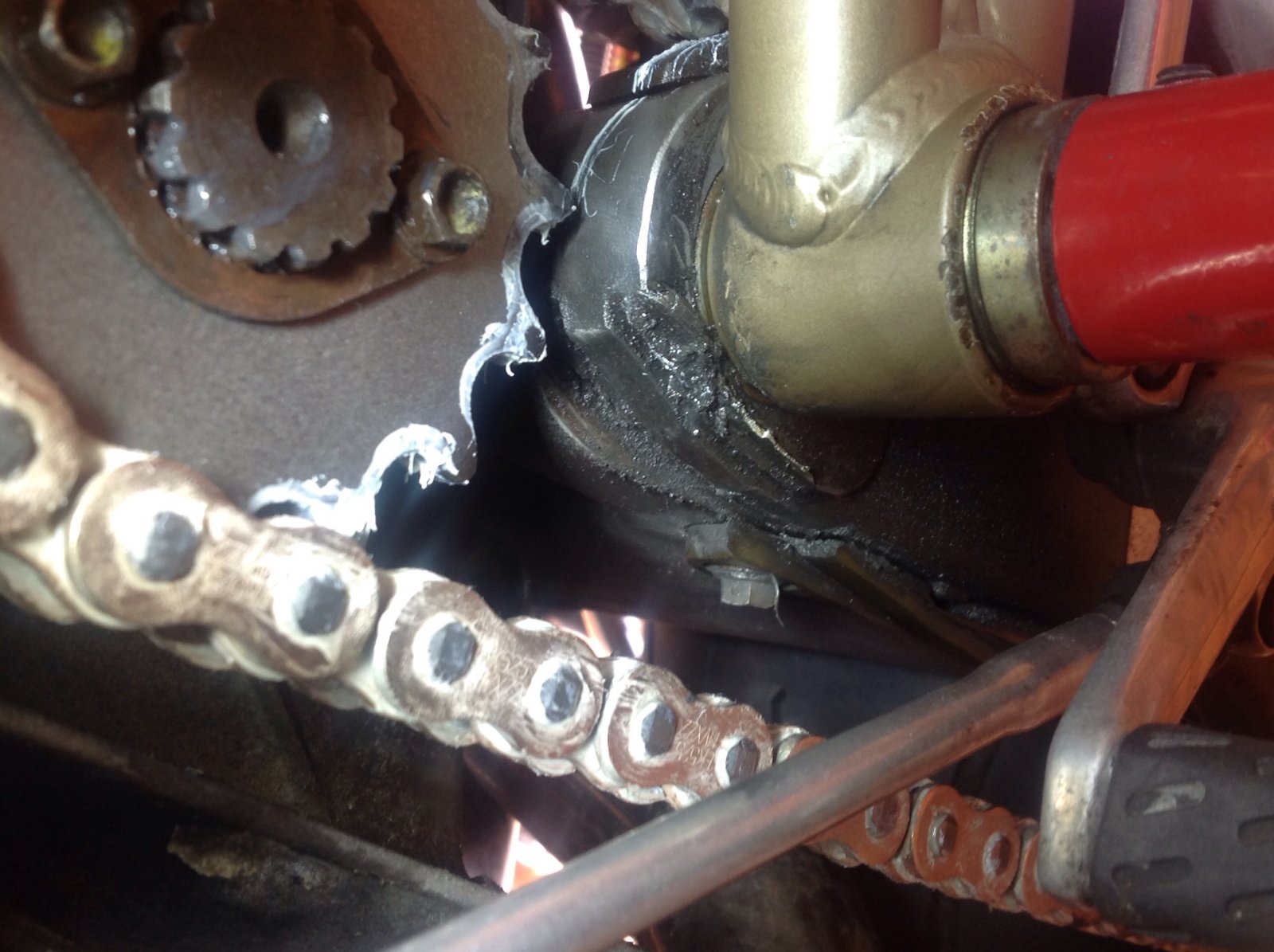

  1. Combination of smaller front sprocket 14 tooth and a knackered chain / poor chain adjustment
    Check yours now
  2. Ai, doesn't look good
  3. What is the damage? Can't quite tell from the pic.
  4. Swinging arm is worn down almost to the bearing
    It's worn right at the edge of the arm will probably work ok for ever
