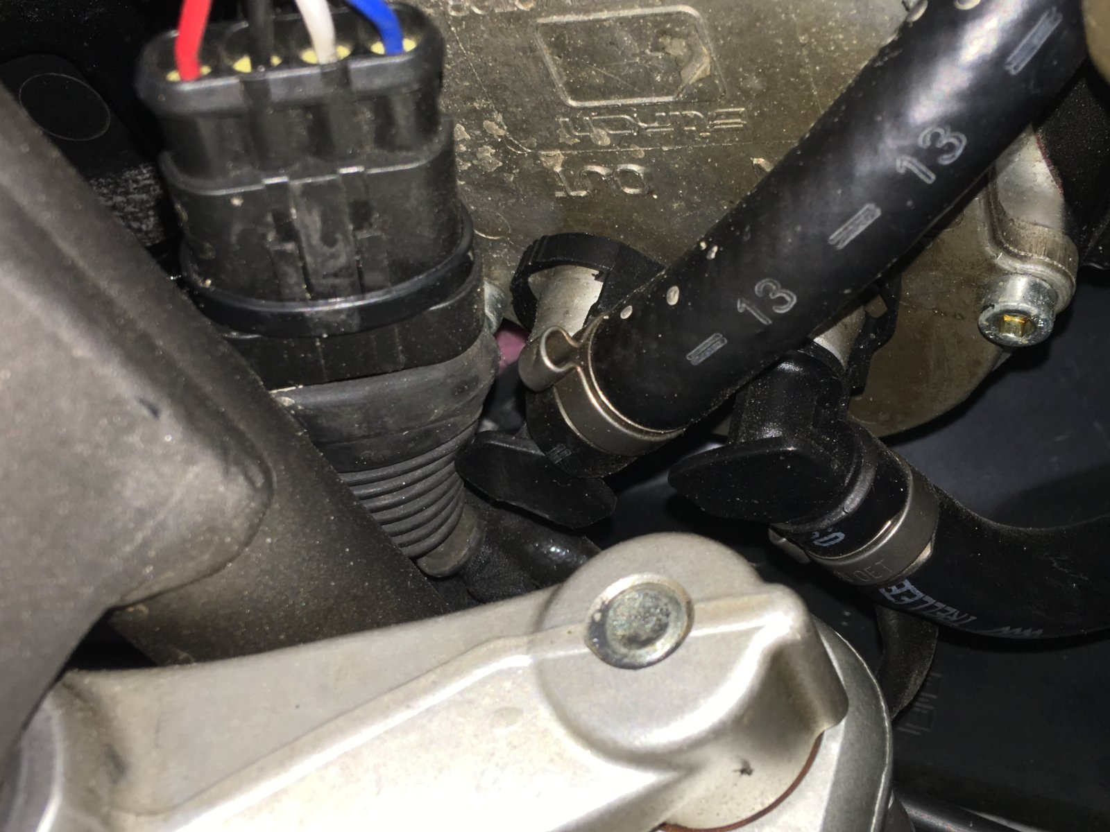

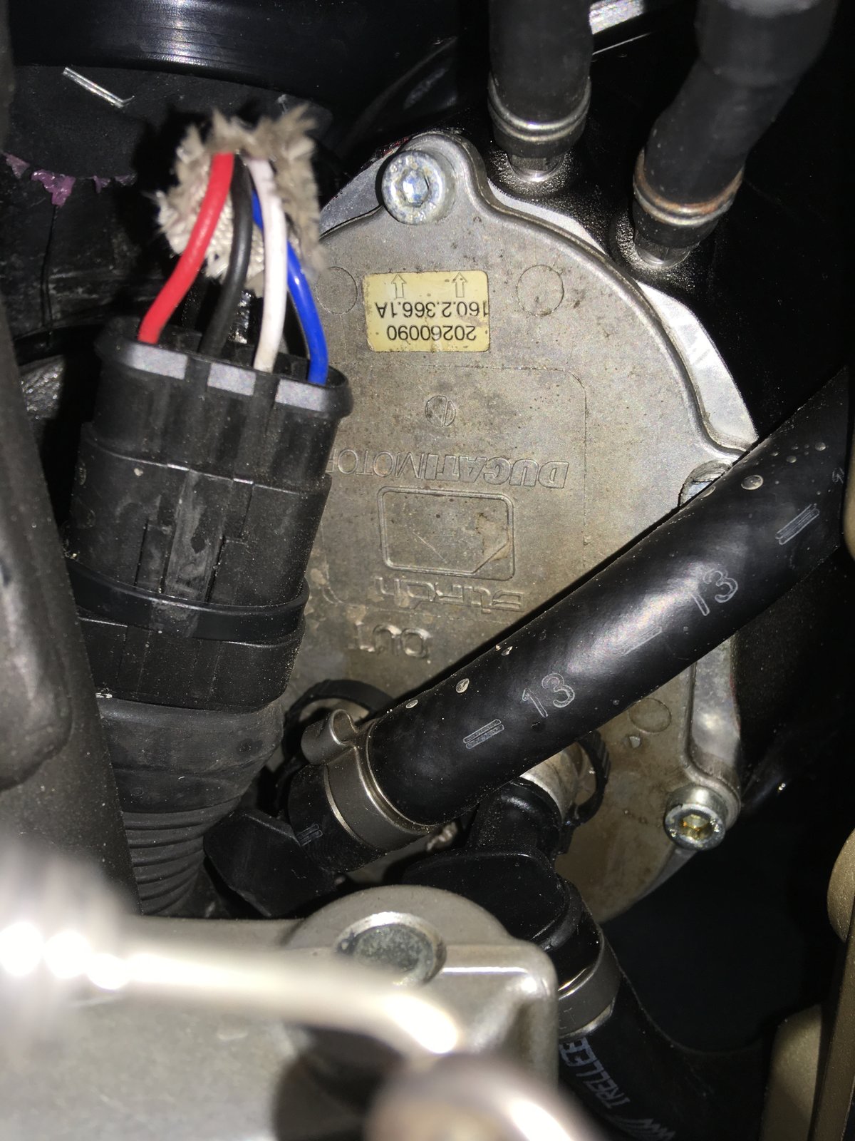

  7. But if the o ring is damaged then you see a leakage i thouht so?
    85DA8AF0-73C6-4738-9FB8-F52603CFC623.jpeg 1871E6DA-5ABA-4512-8A18-6777ABD8161D.jpeg
  8. Not necessarily as it only needs to be the slightest of weeps. A small amount of petrol vapour goes a long way. Andy
  9. Ok and How can i resolve this problem? Buy new fuel hoses or can i change the o rings?
  10. if in doubt, change the o rings ( always good to have a spare set in the garage toolbox )
    and also check the Tank filler cap, as if the breather is blocked you can get a vapour release form the tank cap, and thats just under your nose when riding.
    also see if the tank is pressurising, when the pump is running, you shouldn't really hear a pressure release when you open the filler cap
  11. The 'o' ring is a consumable and easily changed. It won't be the hose. Nathanhu's call on the fuel cap is also a common problem. Andy
  12. Those goddamned green o rings are a right pain. Ive snagged it twice when putting the hose back. Buy spares is good advice.
