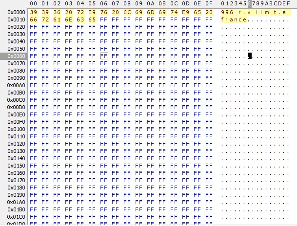

  5. If you cannot find anything then you could flash
    39 39 36 20 72 E9 76 20 6C 69 6D 69 74 E9 65 20 66 72 61 6E 63 65
    To the first 2 lines of the bin showing all FF
    That would read
    996 rév limitée france
