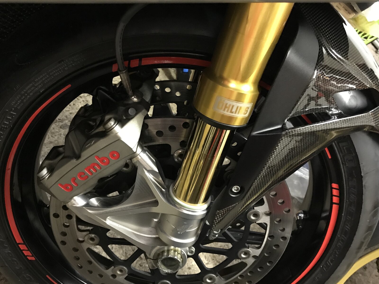

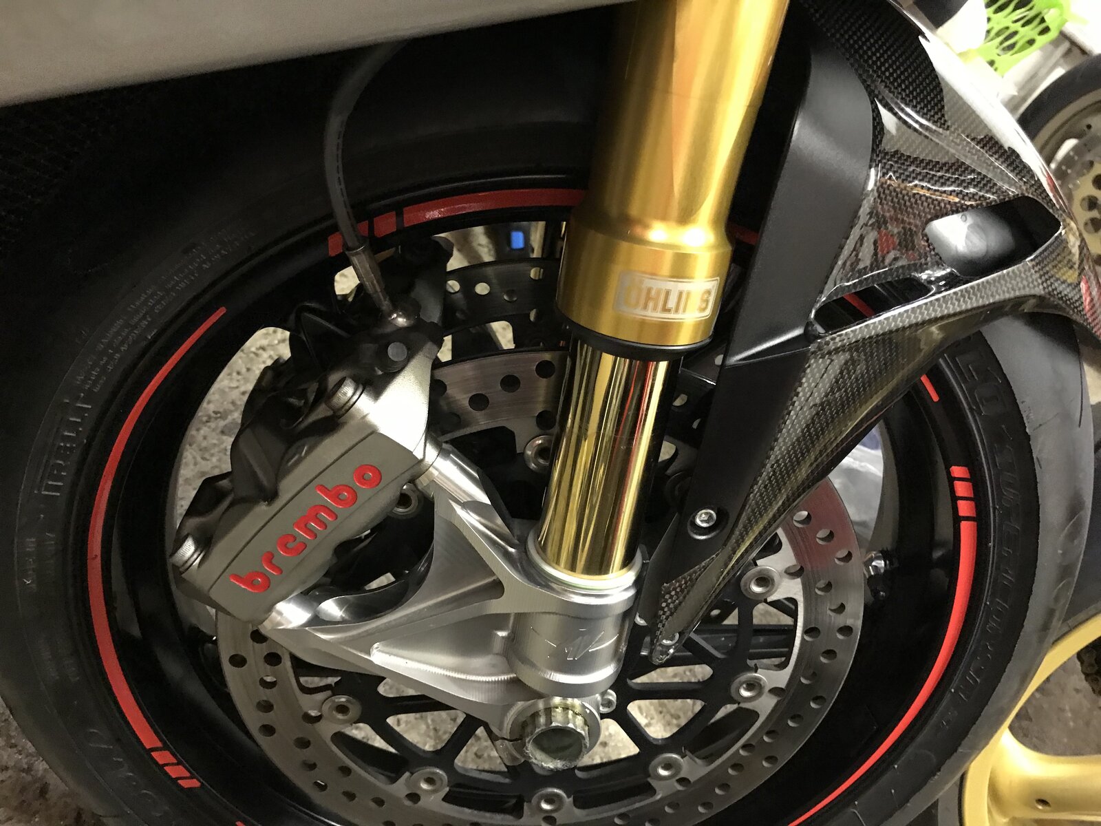

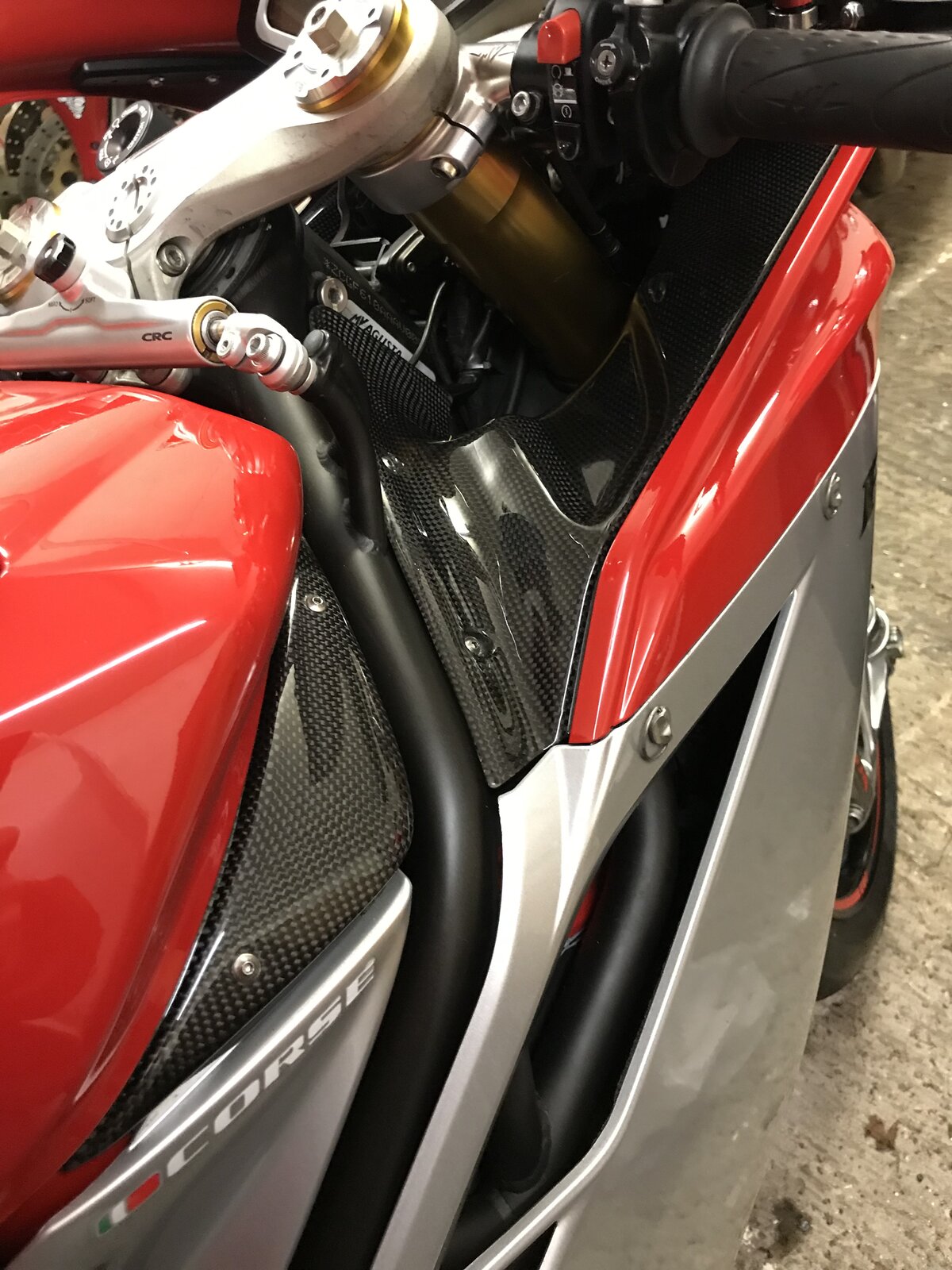

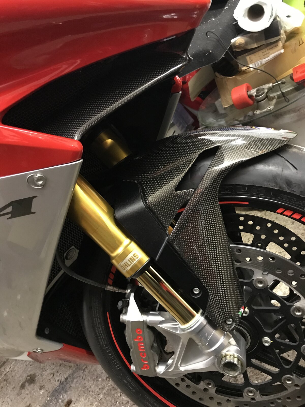

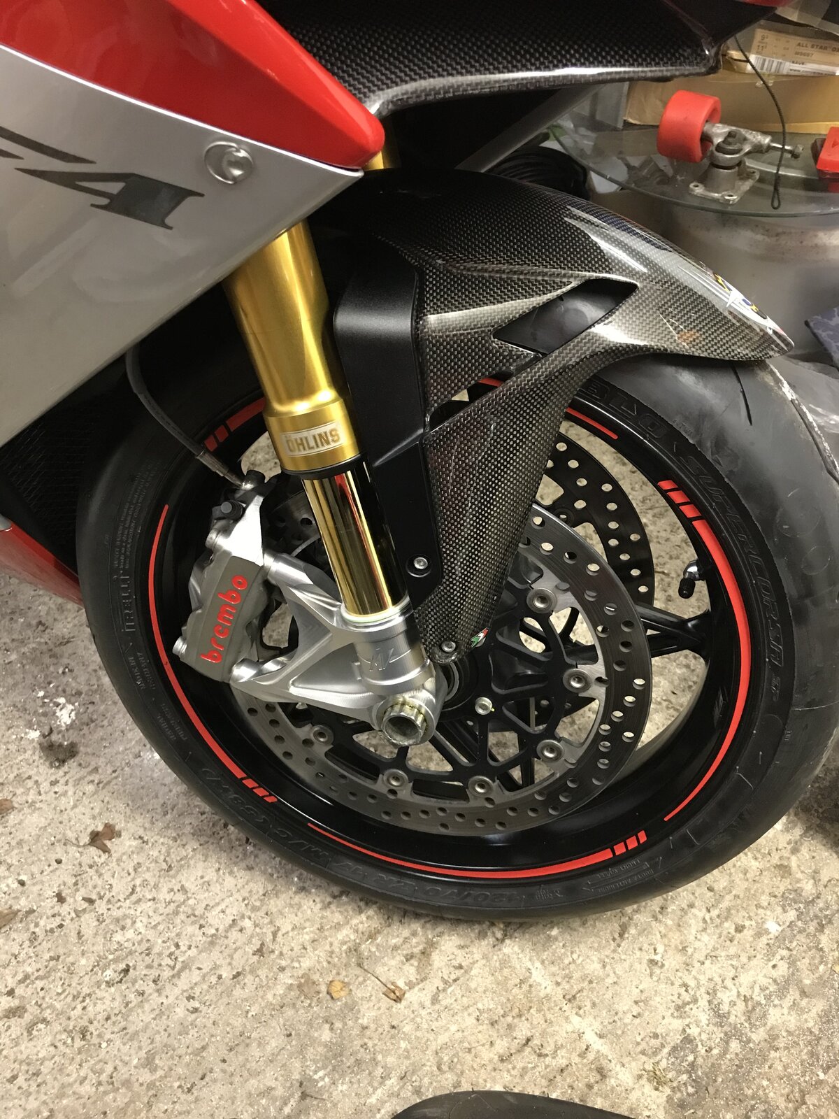

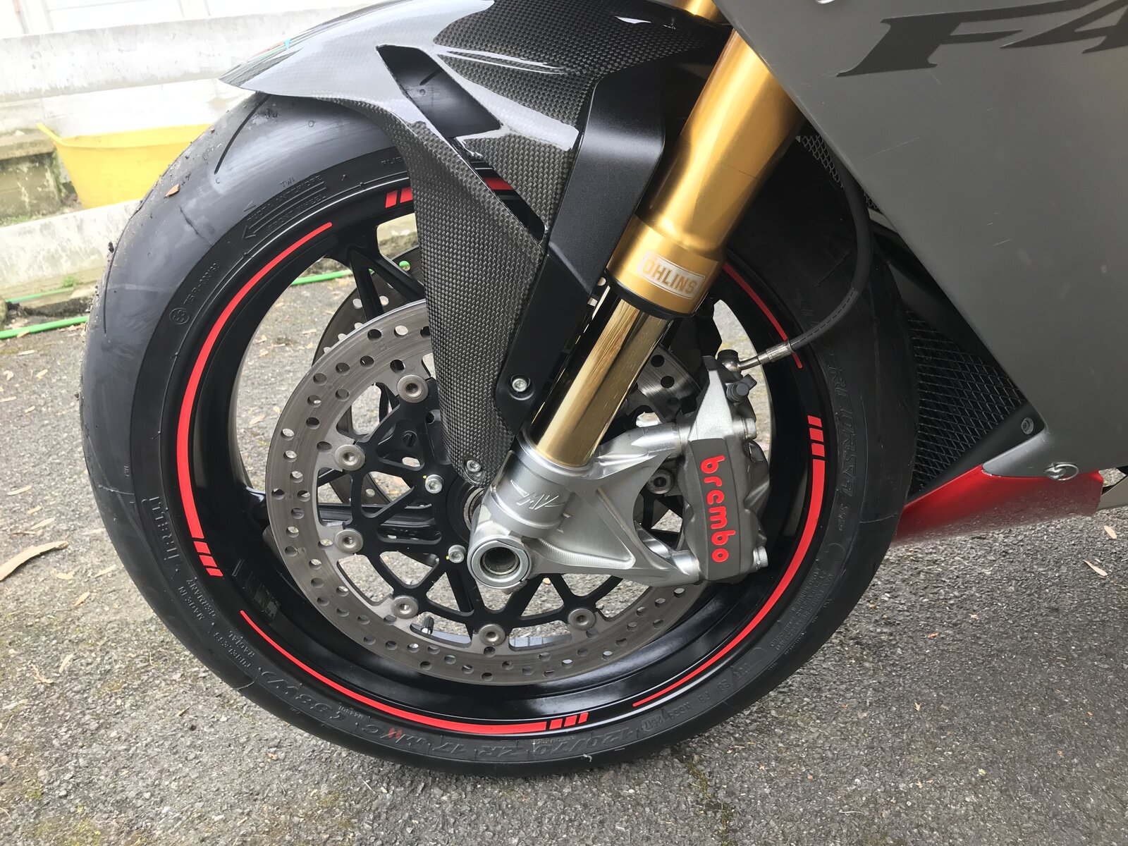

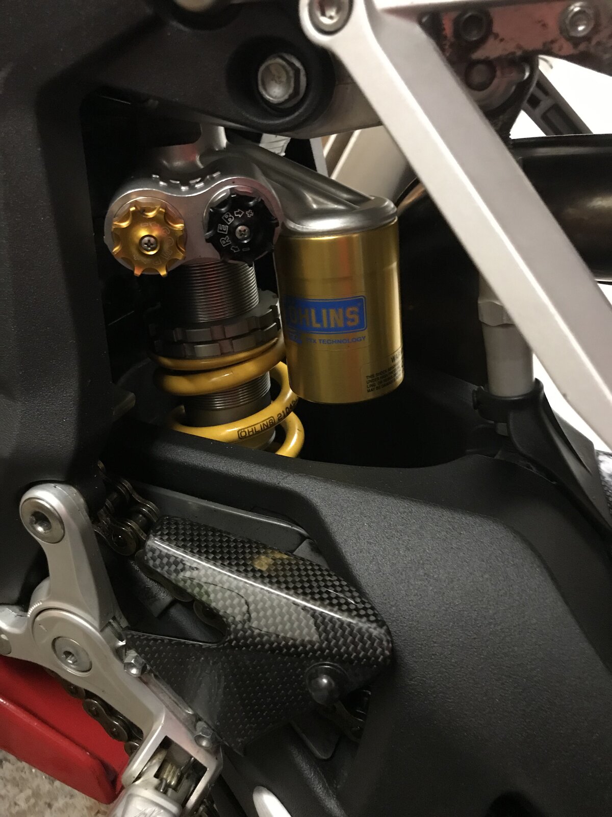

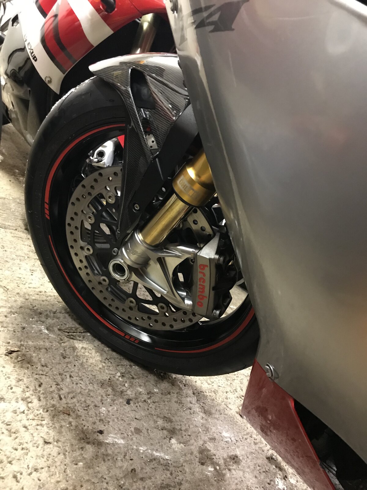

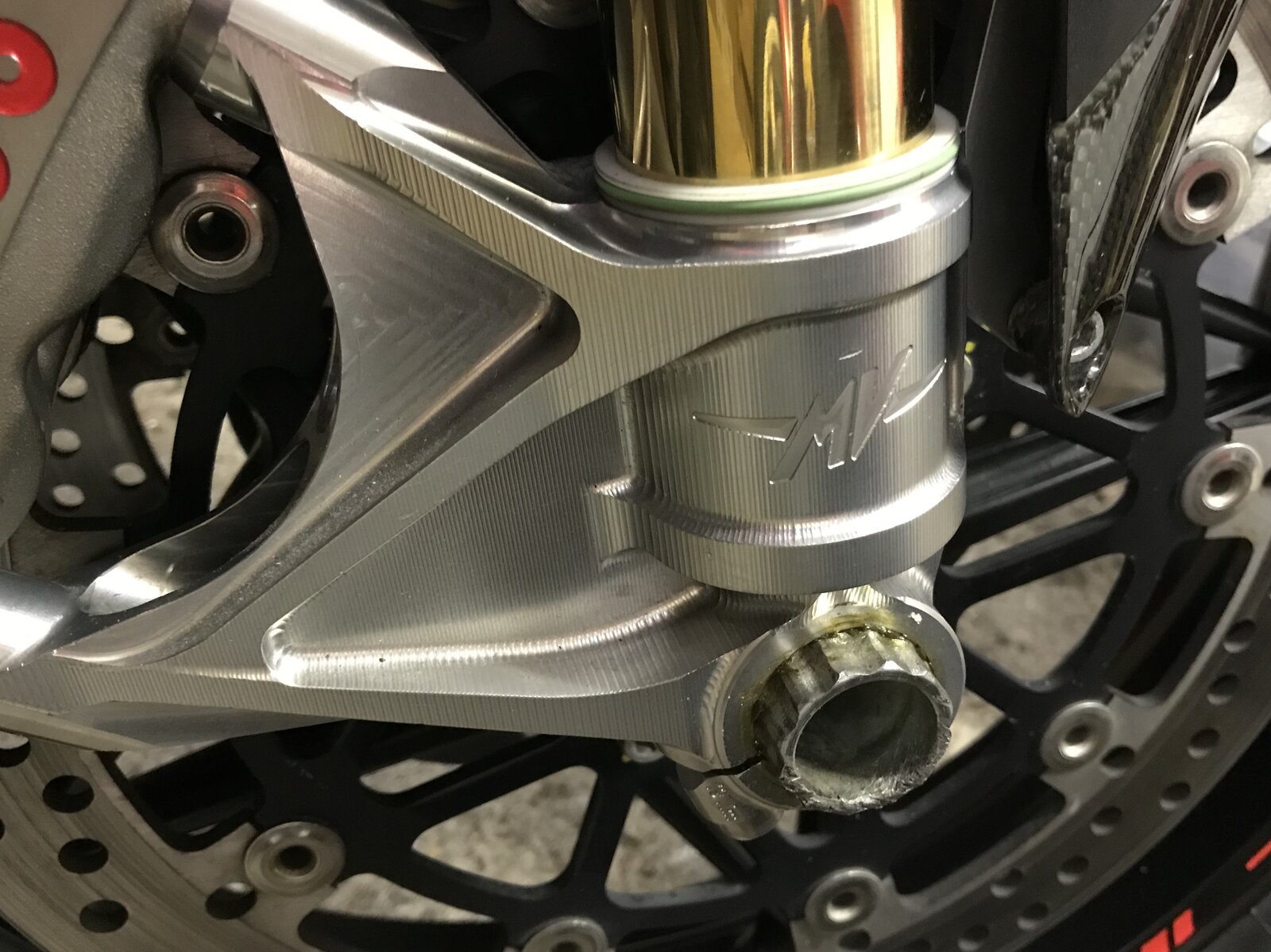

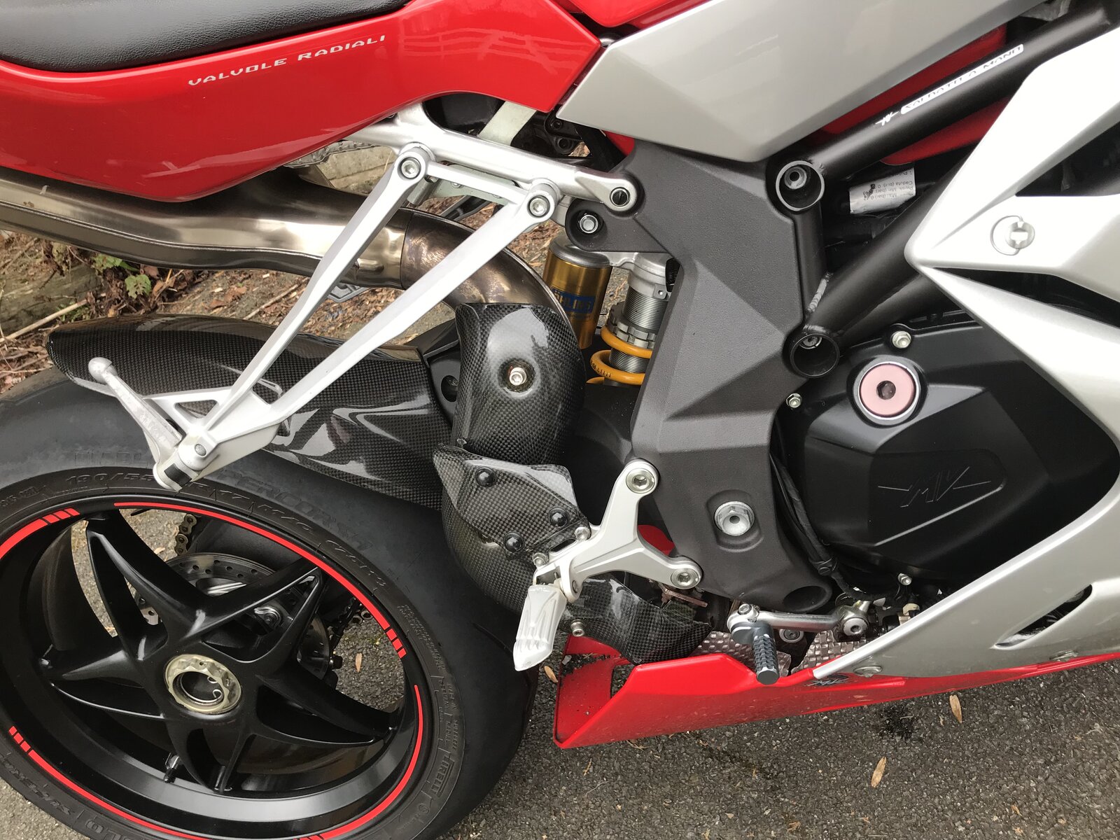

  1. 347D0AF5-B074-4DCB-ACD5-8D584D21BE9B.jpeg 696CCFC6-605B-444C-B5ED-96FE8940450B.jpeg D0D5C8BE-1CD1-4FFB-9878-1CF63420CE38.jpeg B191AFCF-B8F5-4BA8-9B02-283772727130.jpeg 32E18D7F-D5C7-460E-B238-221157410E30.jpeg 1EB3E706-A904-4D32-8864-528E90D50E38.jpeg 50A214BF-D7E4-407D-BA91-E9A1E97229FC.jpeg 2E71C21A-460D-4F23-928B-041562287A22.jpeg just got my 2010 f4 1000r Agusta back having been serviced and valve clearances checked and also having the suspension changed , I bought quite a few items from someone who had a 2011 f4 RR which had been written off due to someone leaving a small screwdriver in the air box and it going into the engine when bike was doing 80ish :astonished:, anyway the rr has full ohlins suspension whereas mine has Marzocchi forks and Sachs rear shock, I bought quite a few spares off him as the RR is very similar just a sort of upgraded version of the r , the ohlins forks weren’t a direct swap but luckily the bits which were different I had already bought off the written off rr , items needed to fit the forks on mine were the rr front wheel spindle and the rr top yoke and also the handlebars needed to be changed , the ohlins look amazing on the Mv , I love the cnc’ing on the ends and the gold on them ,

  2. Nothing to be sorry about, that is a thing of beauty :upyeah:.
  3. Only MV would bother to engrave the bottom of the fork leg.

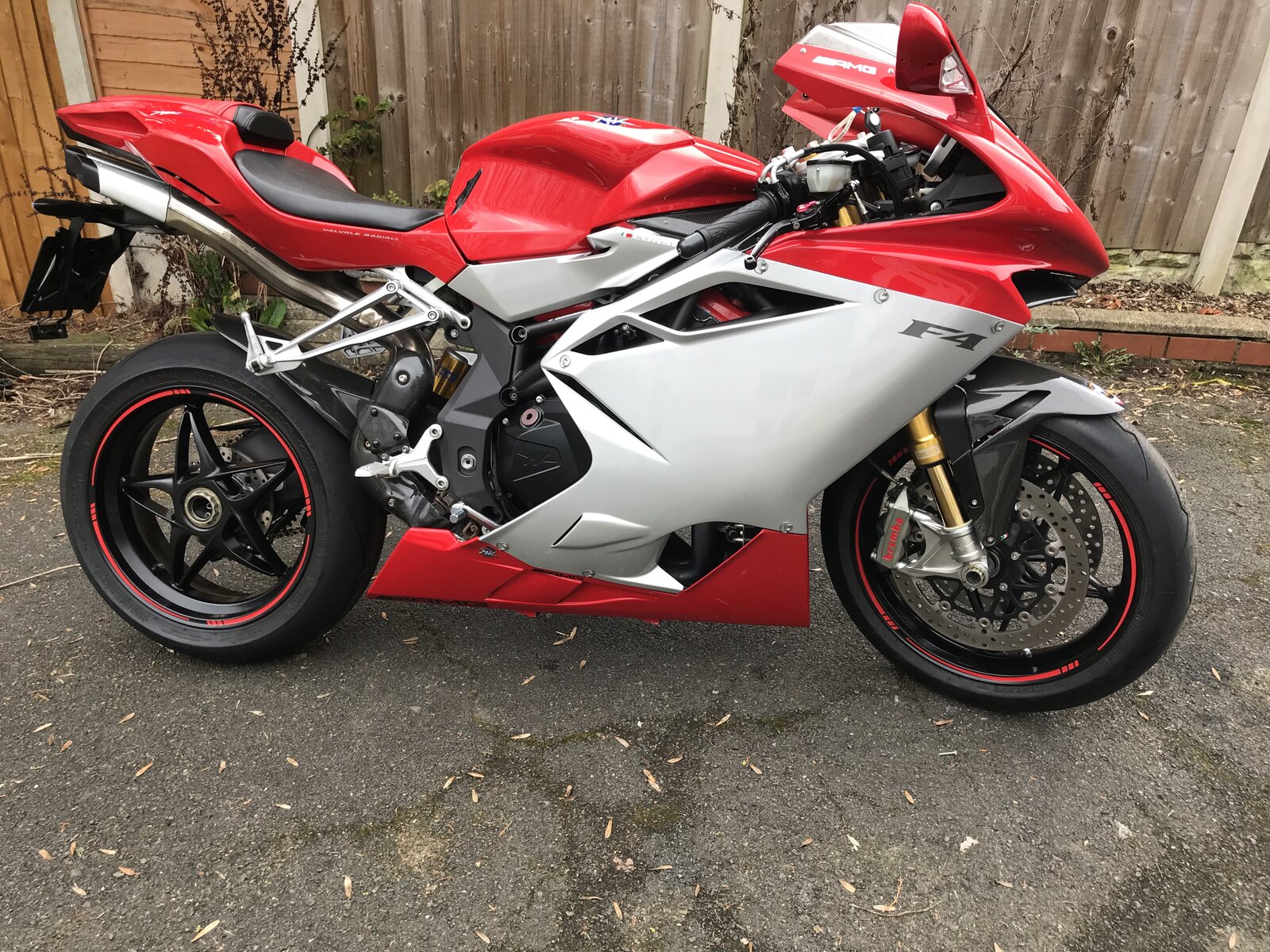

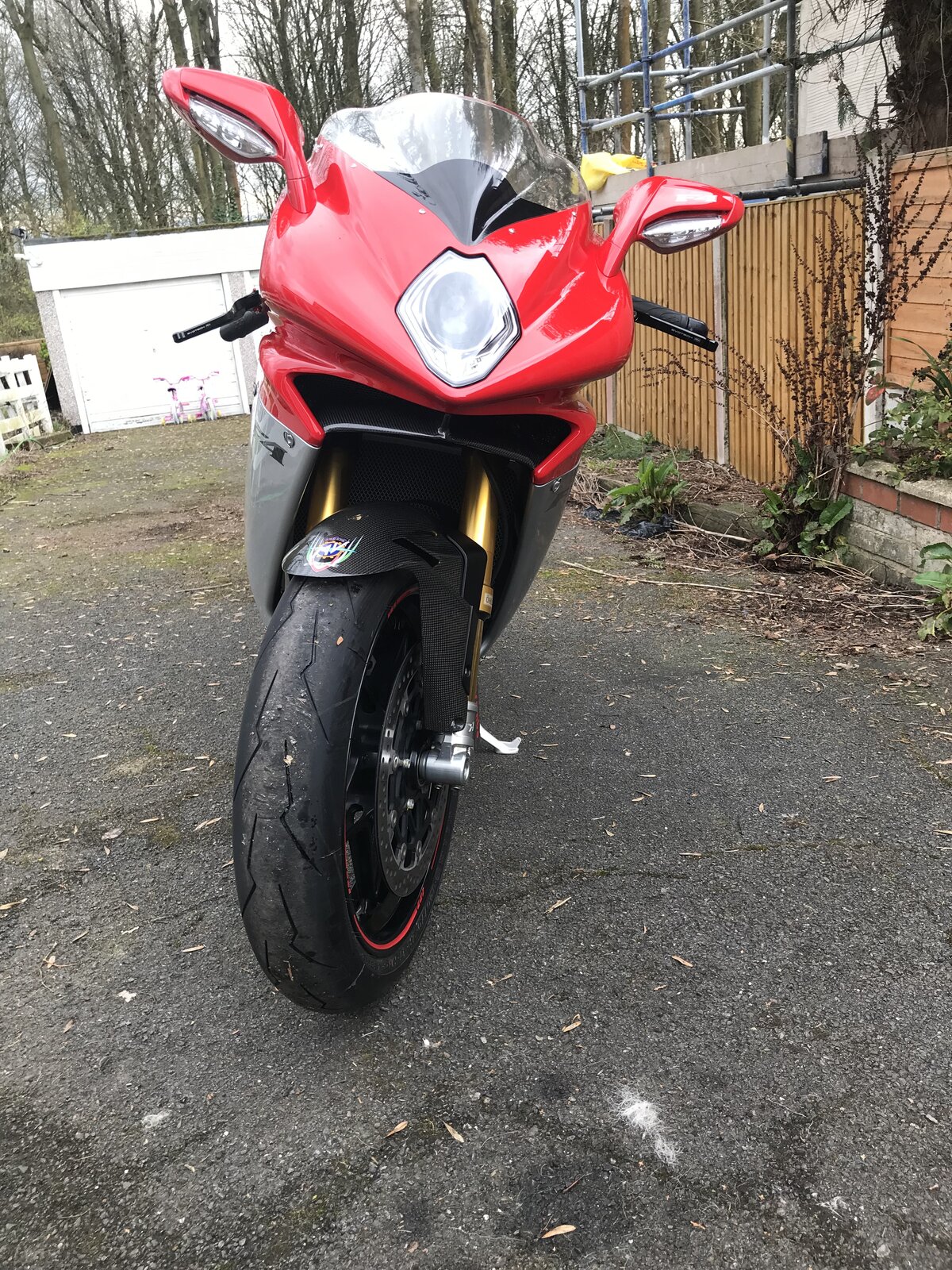

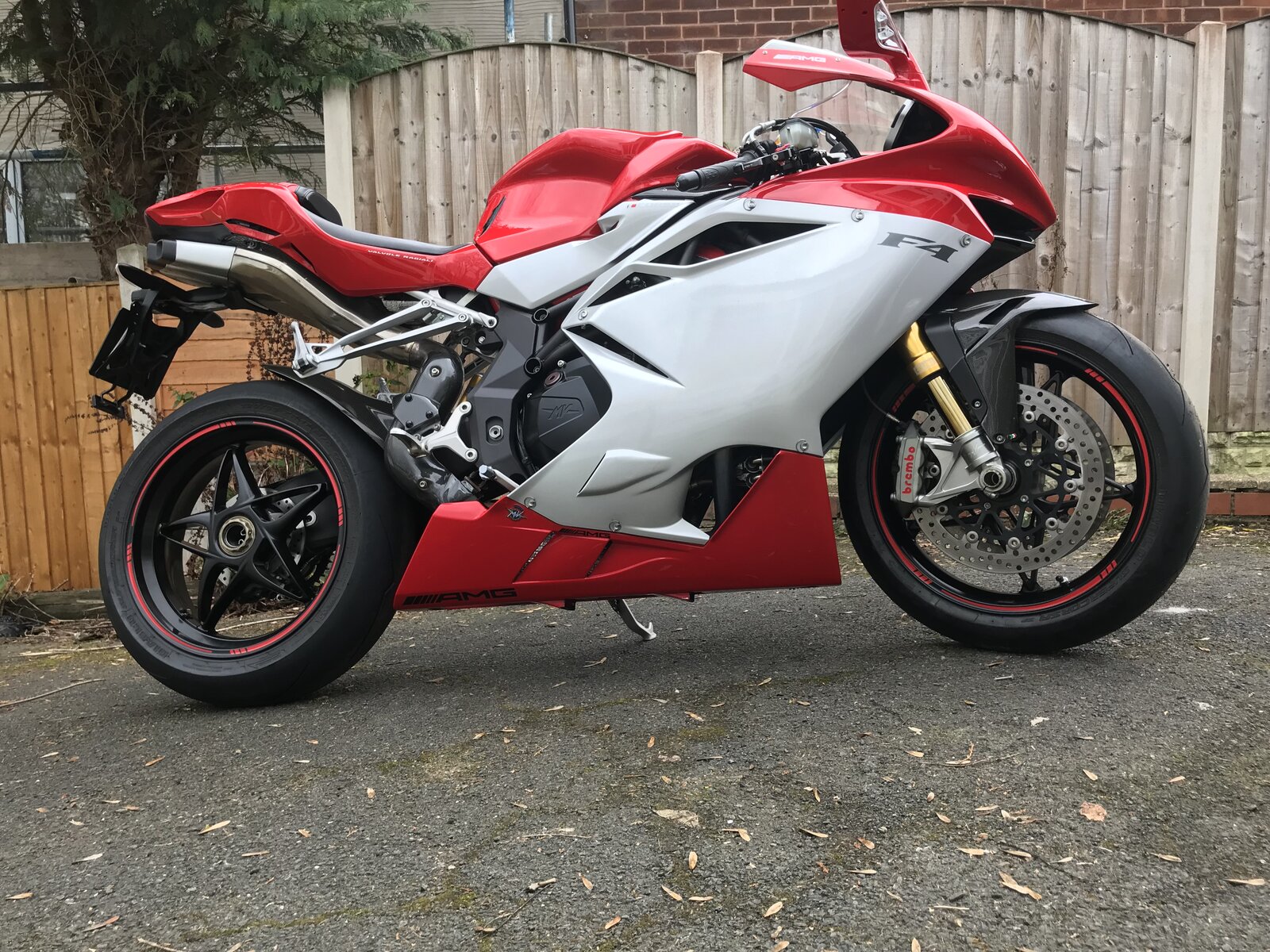

  4. A few pictures of the whole bike would be nice :)

  6. Chummy that... have you enough grease on the front spindle! also how about some EXUP pics too:grinning:... Nice work....
  7. More pics from a distance please!

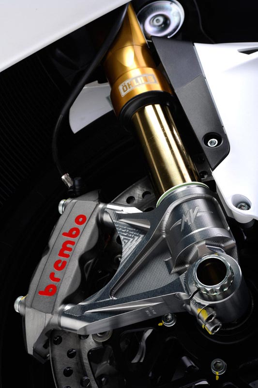

    How does that spindle stay in? Is there a nut to go on it?

  9. Very nice... More pics of the whole bike please :upyeah:
  10. I will fire some more pics of the whole bike , looking forward to seeing if it actually seems any different on the new suspension the Marzocchi and Sachs are pretty hard, it’s a crazy bike it looks nice sat there but when you are on it it’s a real animal really , scares the crap out of me to be honest :joy: in a nice way , yes the other bike in background is 2000 r1 which is so easy and nice to ride , the spindle on the Mv just pushes in on one side it’s a dead stop then it’s held in from the bottom of the fork it sort of tightens up on the spindle
  11. That spindle set-up look like a dogs breakfast.
  12. I prefer the 5JJ
  13. It should have a nut at the end to compress the wheel bearings.
    No that’s how they are supposed to be
    Above is a pic from a then new 2012 rr which shows a bit closer how the spindles held to the forks
  15. There must be a way of putting torque onto the spindle. Either the fork is threaded or a nut is used on the end of the spindle.
  16. I take it the bi-hex is a nut that goes into the forks then
  17. The
    The other side of spindle might be threaded I never Fitted the forks lee at mototechnica fitted them but it’s all how it’s supposed to be there’s nothing missing off it
