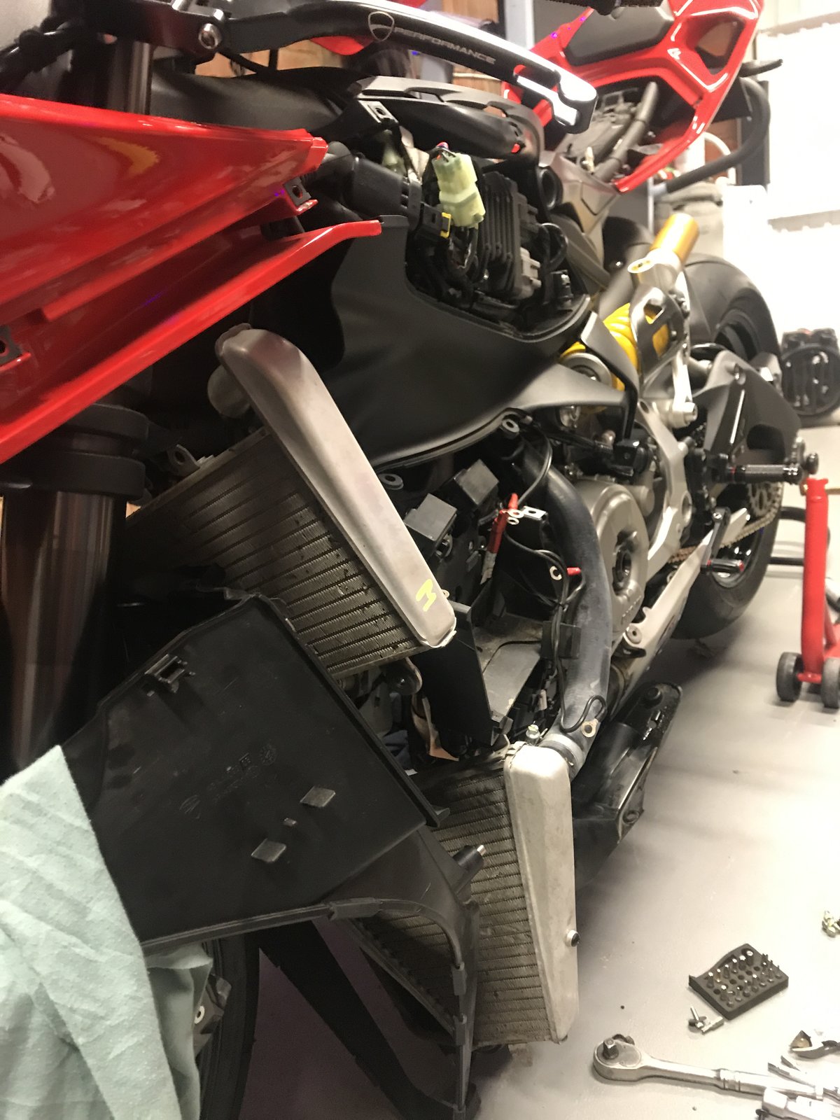

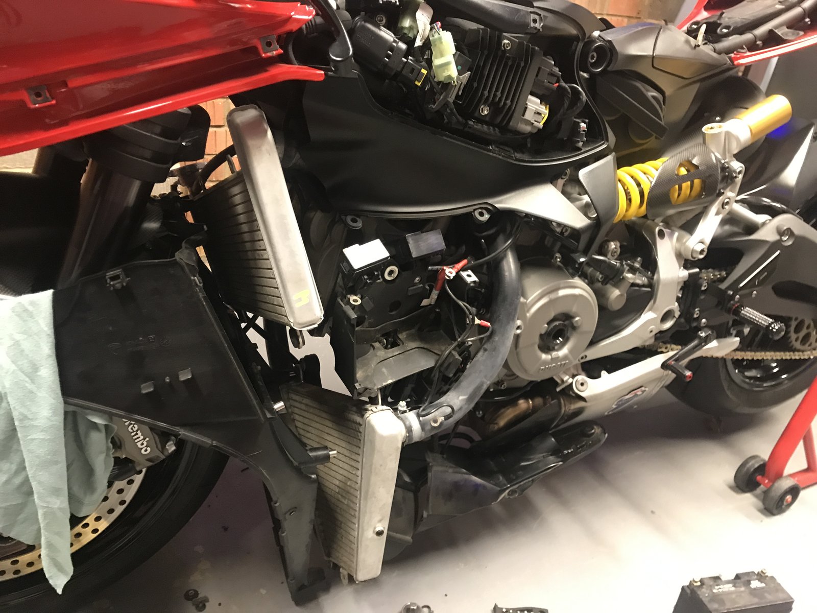

  3. I will happily send you some photos. What should be a five minute job took me approx 3 hours. I didn't fully take the rad out, but pulled it enough out of the way to get access to the plugs. To access the rad though and be able to drop it you will have to remove the fan and cowling under the lower fairings. I think I have some pictures somewhere so you can see the extent of the job.

  5. No the access panel isn't big enough I can 100% confirm, but as per the photos you can just remove the rad gaurd and split the rads rather than removing fully and this gives you enough clearance to get the socket and extension bar in. Just remember, you will need a spark plug socket with thin walls too as the spark plug access in the head is very tight.
