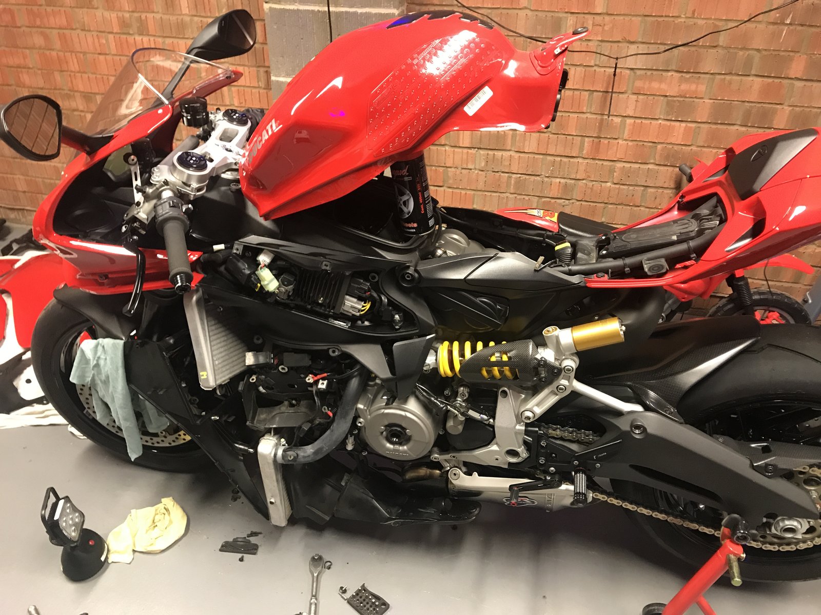

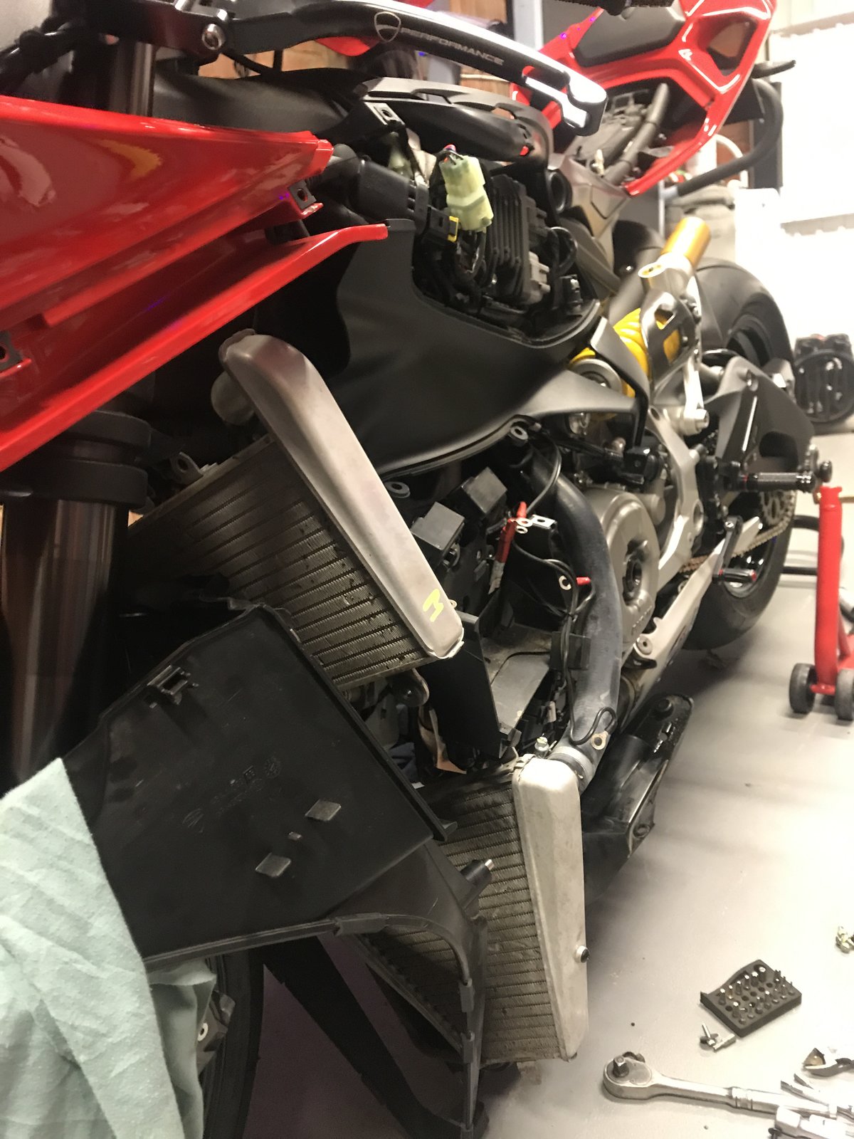

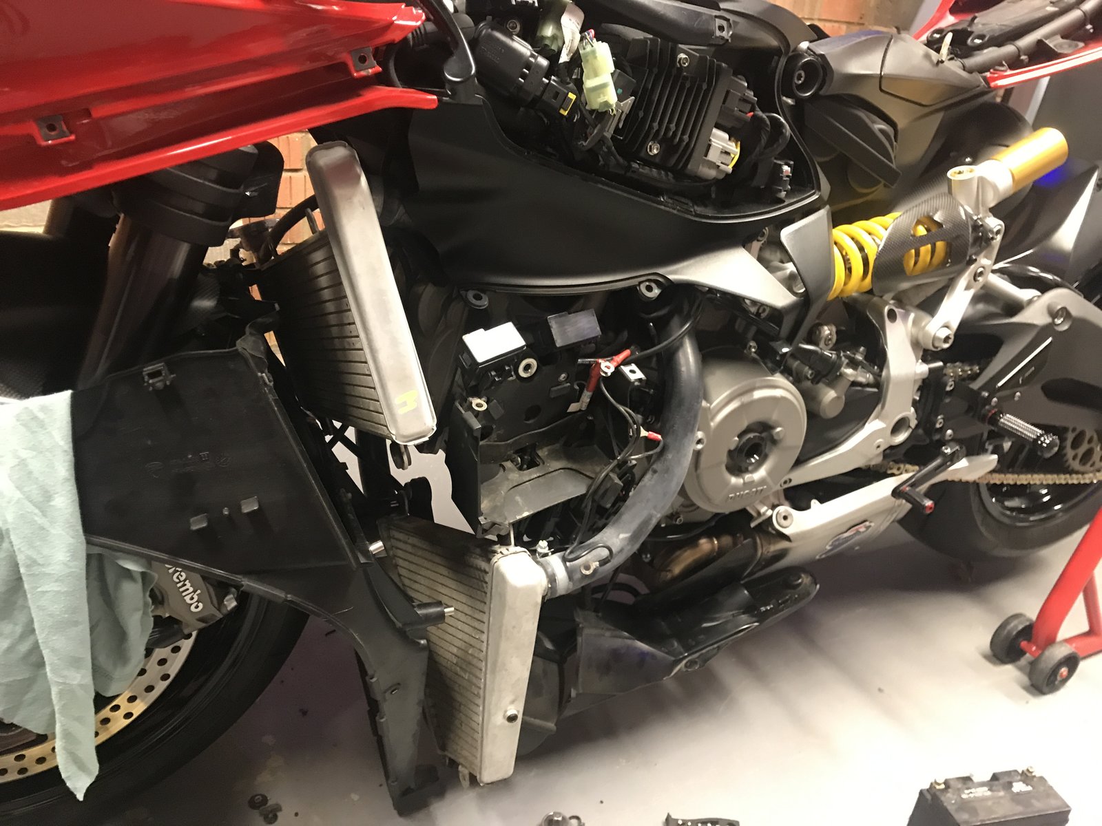

  4. You weren’t wrong!!! What a absolute arse ache!! But now in and putting it back together....thanks again for your advice
    7845FF39-B5D0-46DE-9BEA-BCE360009B37.jpeg 490B8A5A-BF49-4FF3-B74B-615C0AE88DB5.jpeg 6701B2E9-CC54-4F8C-9BFB-D60D3847A4A9.jpeg 7AA96229-3CF8-4D8B-8E08-C033E8E6C626.jpeg 8588D50A-A6DE-4DDC-93EE-3F9FBAFB1688.jpeg
