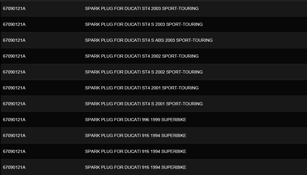

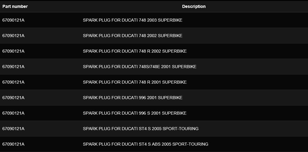

  5. These are all the same Ducati part number if that helps:

  7. You're R is on the list above...
  8. That's what web sites say when Googling the Ducati part Number too.
