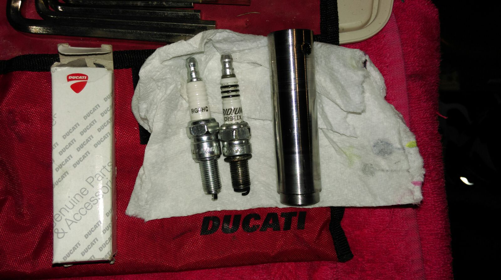

  2. See pic . Explanation given in album under user albums. Spark plug body length can cause an issue unless you have a thin walled plug socket. Just my experience but if it saves you dime pain....
  3. I use Iridium plugs in my 998 set to a large gap, about 0.030"\0.032". I have never had a problem using this type of plug although some may disagree.
    The large spark plug gap is to allow a fatter\stronger spark, according to theory.
    I use NGK plugs and machined down a conventional socket on a lathe to allow for the need to use a thin walled socket.

  7. For what it's worth, I did a service on my 998s this year and the original plugs are Champion RG4HC. I bought the listed equivalent NGK CR9EB plugs and they are longer that the Campion plugs so they now sit on my shelf as I'm trying to get some more Champion plugs. I would welcome comments as to other peoples experiences with different makes of plugs.

  11. Perhaps I should have made myself clear. its the threaded part that goes into the head further, ie it sticks into the combustion chamber further than the OE Champions.
