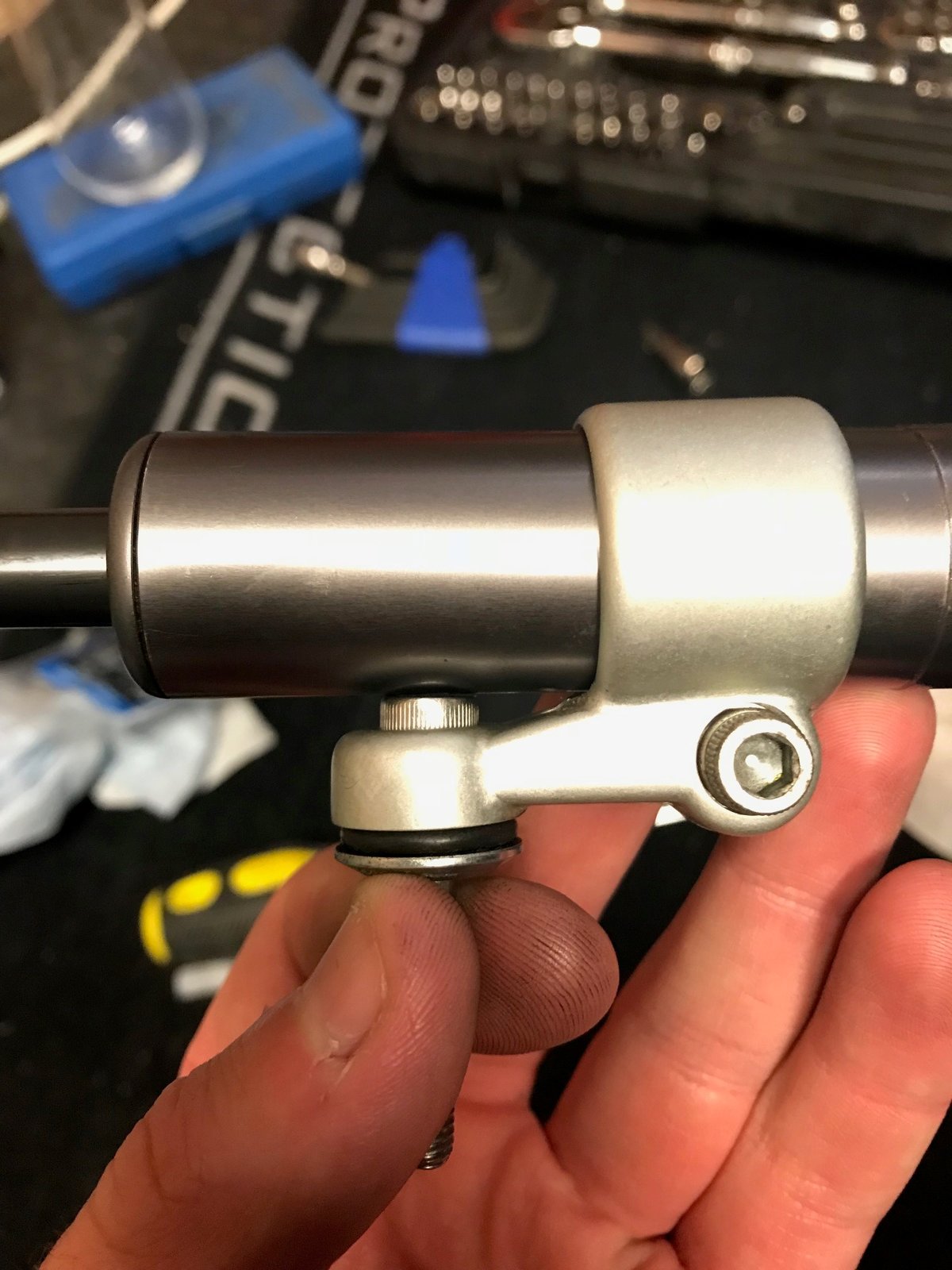

  1. So, brace yourselves! What should have been a really simple job on my 848 turned into a bit of a nightmare. Basically the bolt supplied for the steering damper has a head on it that's about 1mm oversized in both height and OD. This means that you can't actually get the steering damper back in it's clamp without scratching it which in turn stops the rose joint from moving.
    I know it's weird, others have had no issues but me and my buddy were in the garage for 2 hours measuring bolts and figuring it out. The instructions say "use the supplied 25mm bolt for 848", there isn't one, it's 22mm there abouts and is no where near long enough and even if it was it has the same issue with the head.
    The answer was to grind the head of the bolt flat, which ultimately removes some surface area for the allen key to grip (as the depth of the head inner is also very shallow compared to OEM). And also to grind 1mm off the diameter so that when fitted it allows the steering damper to move enough to give free play.

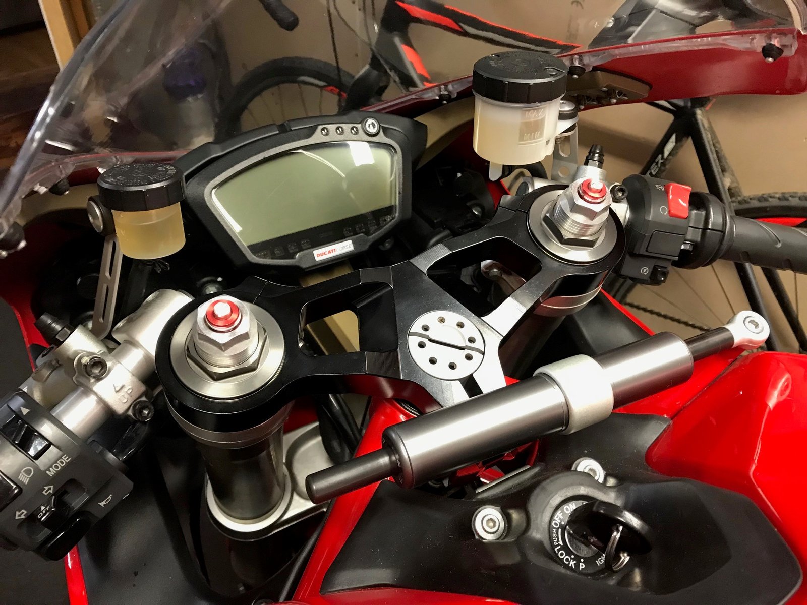

    We fitted it all eventually....

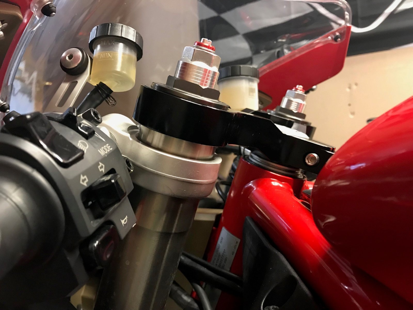

    and you can see the difference in height it provides..
