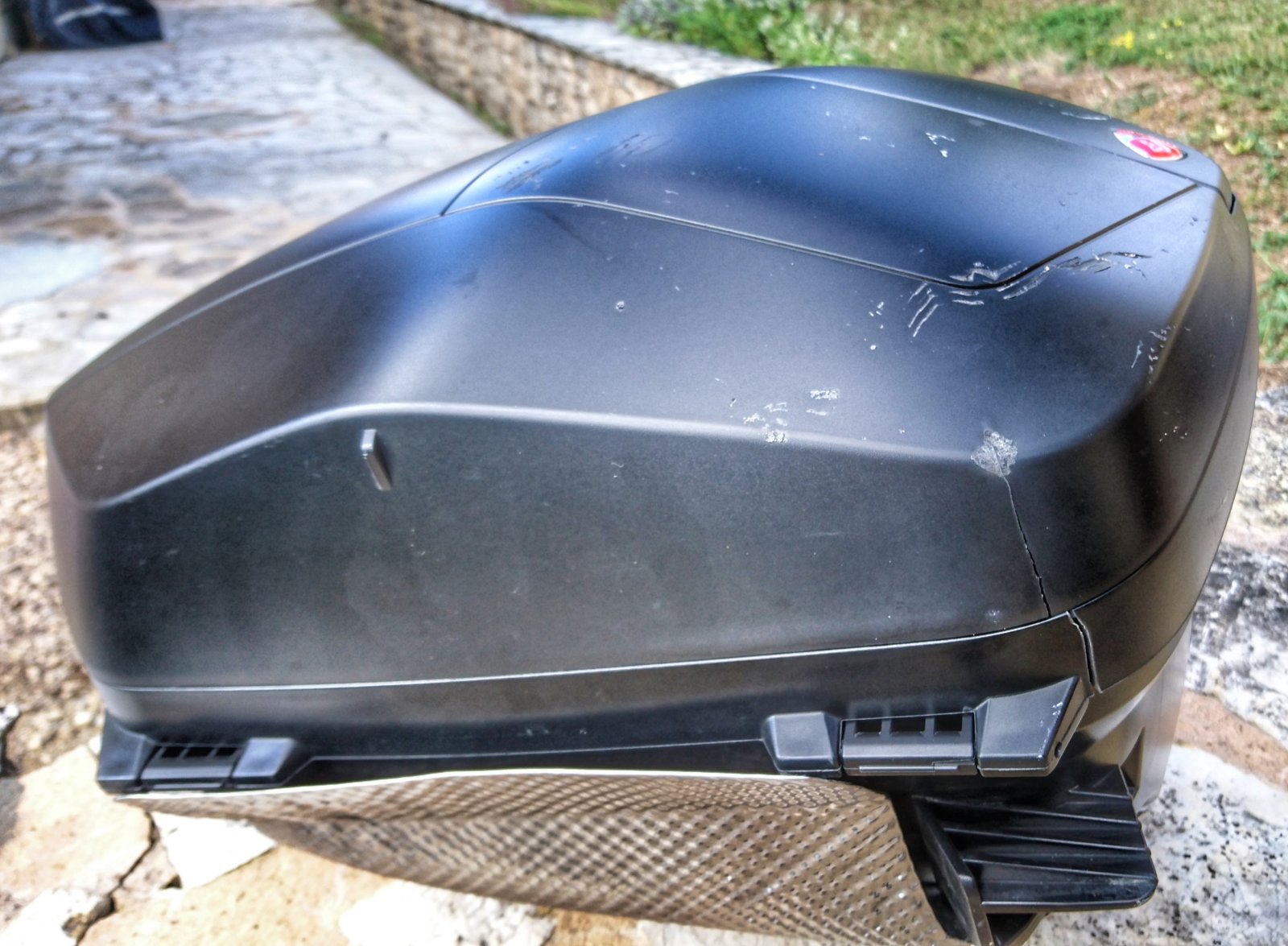

  1. Hi all,
    Does anyone here know how to split the panniers into two e.g. Separating the section that attaches to the bike and the lid?
    There is a guide pin in each which I'm assuming should knock out, but I don't want to break anything before attempting this.

  3. Easy - just get a pin or screwdriver narrow enough to slip down the bore and drift out the hinge pin. I always tap mine out towards the middle - there's a knurled end to the pin that locks into (IIRC) the outer end. Refitting is just the reverse. I've switched several times between the big and small lids and not had a problem.
    Edit: just realised that yours may be the DVT panniers - mine are the earlier ones. but, from your photograph, the hinges look very similar.

    It's dead easy, knock the pins out as as mentioned above and remove the straps that limit the open angle.
    One point to note is that the easiest approach is to knock the pins through from the outside end in, pushing the pins towards each other. However the pins are designed to ideally be knocked through the opposite direction.
    You can push them through either way but the optimum approach (and a bit more fiddly) is to knock from the middle out.
