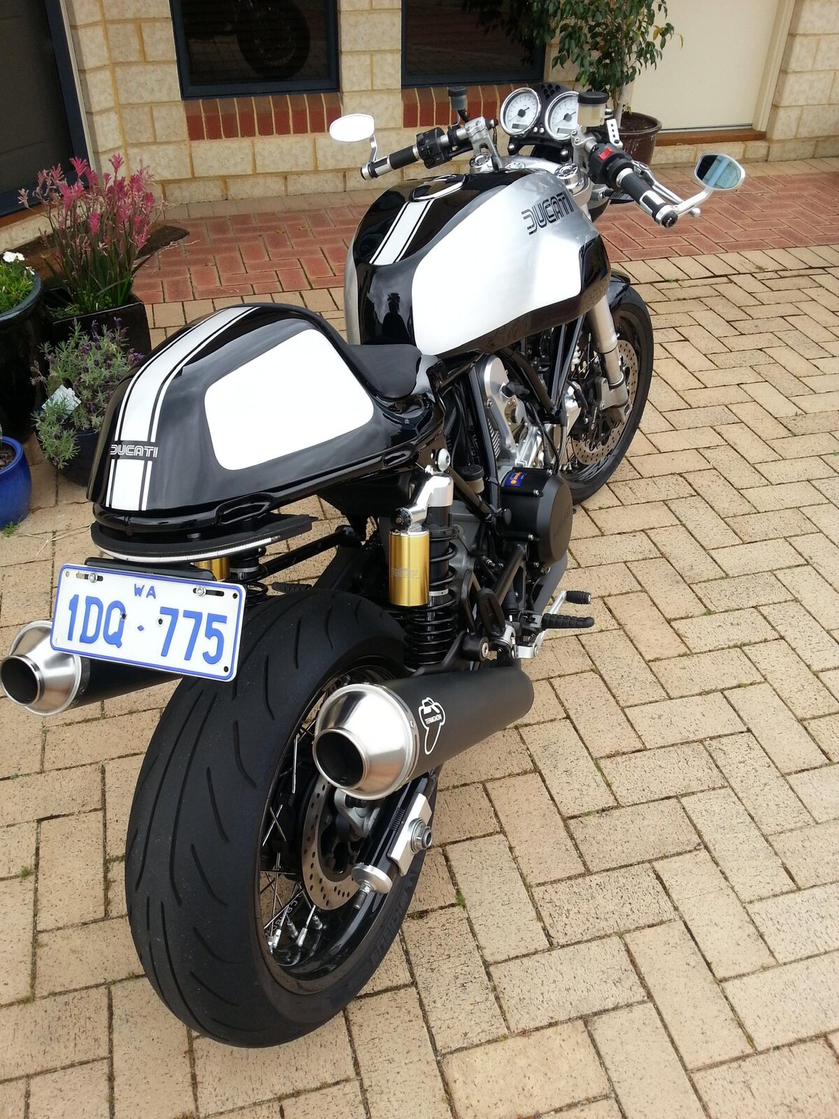

  5. Here’s a pic the guy that made the alloy tank recently for my monster sent me to highlight his work fitted to a sport classic. Both tank and tail unit are alloy fabricated by him.
  6. NICE WORK!!:upyeah:
  7. That’s nice. I think the OP was asking about the original tanks fitted from the factory, but that alloy tank is a nice option if anyone wants to future proof against petrol with higher ethanol content.
  8. Who fabricated this and what was the cost?
