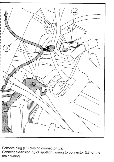

  1. I have bought a set of non OEM spot lights which are very nice and work perfectly with the supplied rocker switch.. However I have the genuine Ducati switch, which will not switch the relay in the supplied loom or if i power the Lights direct from the switch they are dim. Anybody know the reason? Is there a limiting resistor or something in the switch or do you need the Ducati Loom which is stupid money!
    Thanks in advance.
  2. If its the same as the Enduro it has to be activated by Ducati dealer via the ECU.
  3. Cheers Chris, will ring Ducati. Don’t have this problem with the SP5!
  4. Switching is all Canbus isn't it? So operating at 5volts or something? Whereas the relay will need 12volts presumably.
  5. Jasper, is this a DVT or Pre-DVT ?
    If it is pre-dvt it is an additional switch attached to the left handlebar. The supplied loom plugs into the switch, lighhts, and the satnav connector.
    It takes its power from the same fuse as satnav and the accessory sockets.
    On the DVT I have no idea, except there is a dedicated switch.
  6. As @John W says, on the pre-DVT models (2010-2014) the loom supplied with the aux lights plugs into the satnav connector and has a separate switch (it also has another connector so you can plug in a satnav). The circuit does not need to be enabled as it's on the switched power circuit (10 A) shared with the accessory sockets.
    On the DVT models (2015+) there is a dedicated socket under the cover at the front of the tank (same place as the satnav connector). A Y cable is supplied with the aux lights and the circuit uses the dedicated switch on the l/h bar switch cluster. The circuit is CAN bus controlled and has to be enabled by the dealer. I had a fault on the Y cable which through up an error on the dash, so I don't know if third party lights would work even if the circuit has been enabled.
  7. Thanks guys. In the end wired my own fused switch, with relay into the sat nav connector. Not paying £100+ for a piece of wire!
