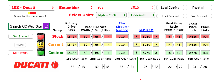

  5. It's pretty simple really. You select the brand - DUCATI, the model - Scrambler, the Variant - 803.
    The enter your sprocket sizes in the CURRENT or CUSTOM in the table with the values for front and rear sprockets.
    This is the table with OEM, 14/46 and 15/44 values.

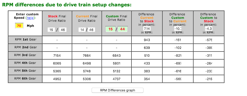

    And scrolling further down, this shows the RPM differences.
    As you can see, at 70mph the 14/46 is running 354rpm faster than standard while my bike at 15/44 is running 574rpm slower than standard. So my bike is running over 900rpm slower than yours at the same speed.

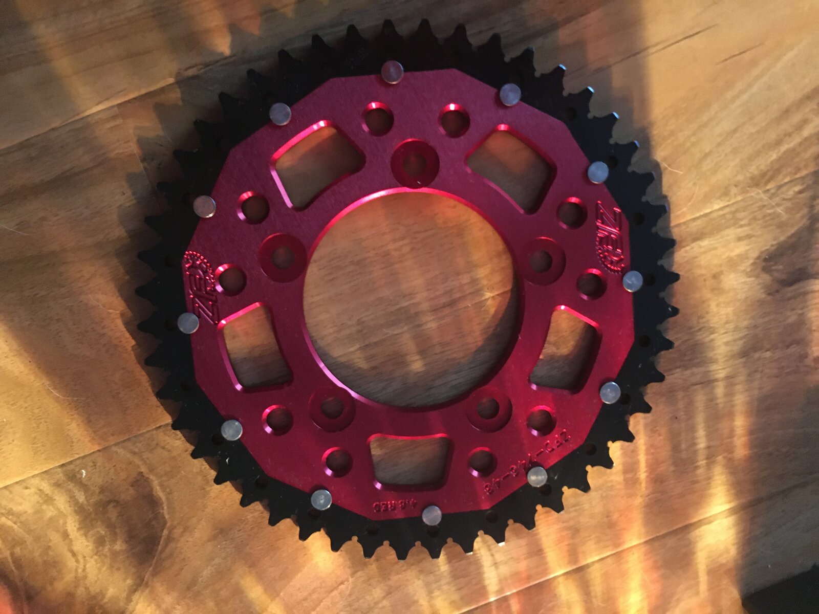

  7. Well it finally stopped raining long enough for the roads to dry so I’ve been out, I expected 1st to feel really short but it doesn’t, 70mph in top shows 2 more bars on the Rev counter, it feels fine at that speed, no more buzzy than before really, where I can mainly feel a difference is in mid range pick up, because I am at slightly higher revs at a given speed I suppose , so all in all I’m happy with the swap, I might however replace the 15t front and get a 48 tooth rear sprocket, mainly because I fancy one of those new fangled alloy centred jobs, might need a longer chain though so that’ll add to the cost, hmmmm!

  8. New fangled? Pics? Link?
  9. just bought it, would’ve preferred silver but they were £46, I can always spray the red bit if it looks too gaudy.
    PS as an experiment I’ll leave the 14t on the front initially and see how it rides, that should get the revs up!
    #11 Mark9, Feb 22, 2020
  10. Nice bit of kit for £36, I’ll get it fitted tomorrow if I have time and report back on how 14/48 feels (like a trials bike?), if I have to go back to 15 on the front I’m hoping the chain will be long enough but it probably won’t!
    #12 Mark9, Feb 28, 2020

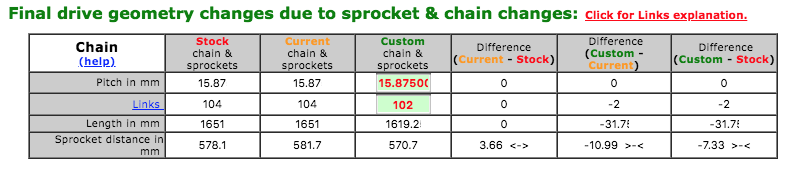

  11. Can't say I'm enamoured of the colour or the squarish holes Mark but with a 1 tooth change at the gearbox sprocket the chain should be ok. With the OEM sprockets I went from a 46 to a 44 at the rear without shortening the chain, although it is getting near to the end of it's adjustment.
  12. Yes fingers crossed on that Derek, the red is what they call “an acquired taste” I believe:)
  13. Gearing Commander to the rescue again. :)
    You can see that the sprocket centre distance only reduces by 3.66mm going from the current (14:46) to stock (15:46). In my case it increased by 7.33mm in going to a 15:44 set up. So I don't think you'll have any problem

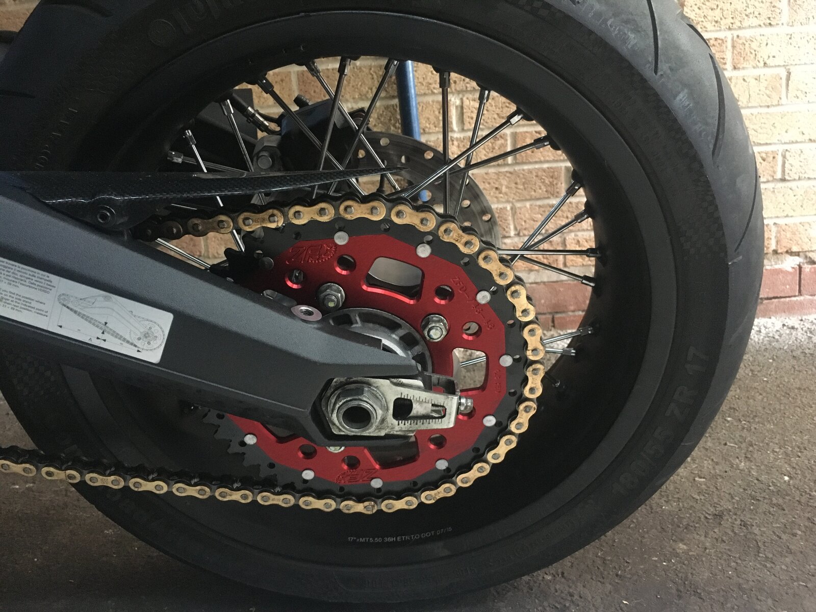

  14. when you say "acquired" i think you mean bad..... lol... if you want to do a proper back to back you should buy my scrambler as well coz its still got standard gearing!
  15. Maybe it’s just my newly acquired bad taste then!, the plan is see how it looks on the bike and paint it out if it looks too crass, have you put your bike up for sale anywhere but this forum yet Chizel?
  16. How do I change my ID on the forum to “Mr tasteless” ? ED8EE330-413B-41DD-844E-5021D9C16707.jpeg
  17. sorry dude, not feeling it.
  18. Yes, I’m not immediately loving the look, the Matt black spray (or silver) might be coming out soon:)
