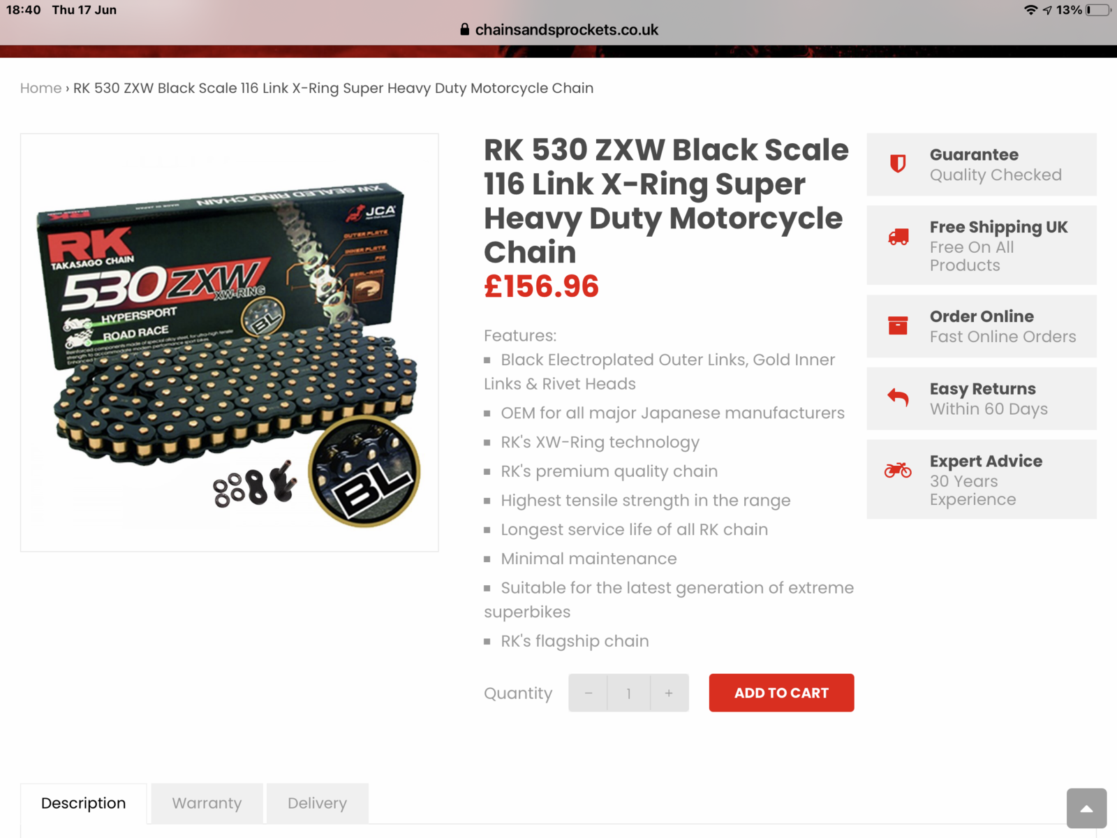

  4. Chainwise I’m going with this one:-
    Purely for the aesthetics.
  5. Thanks, I might look into that. Sort of inverse bling, though the DID silver is, if I can get it, probably about the same price and more understated.
