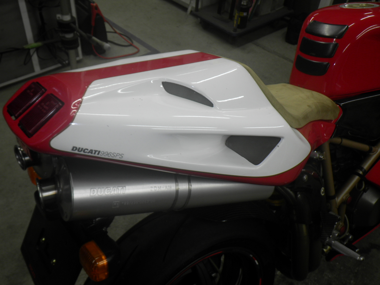

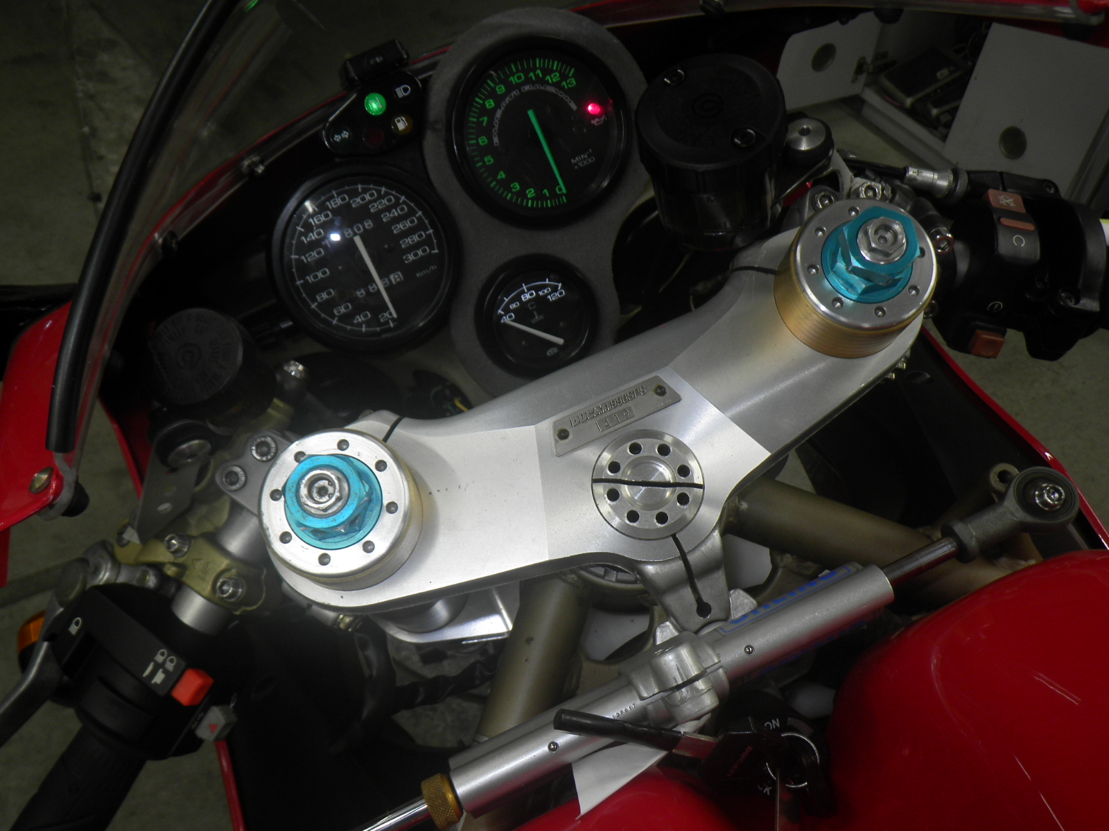

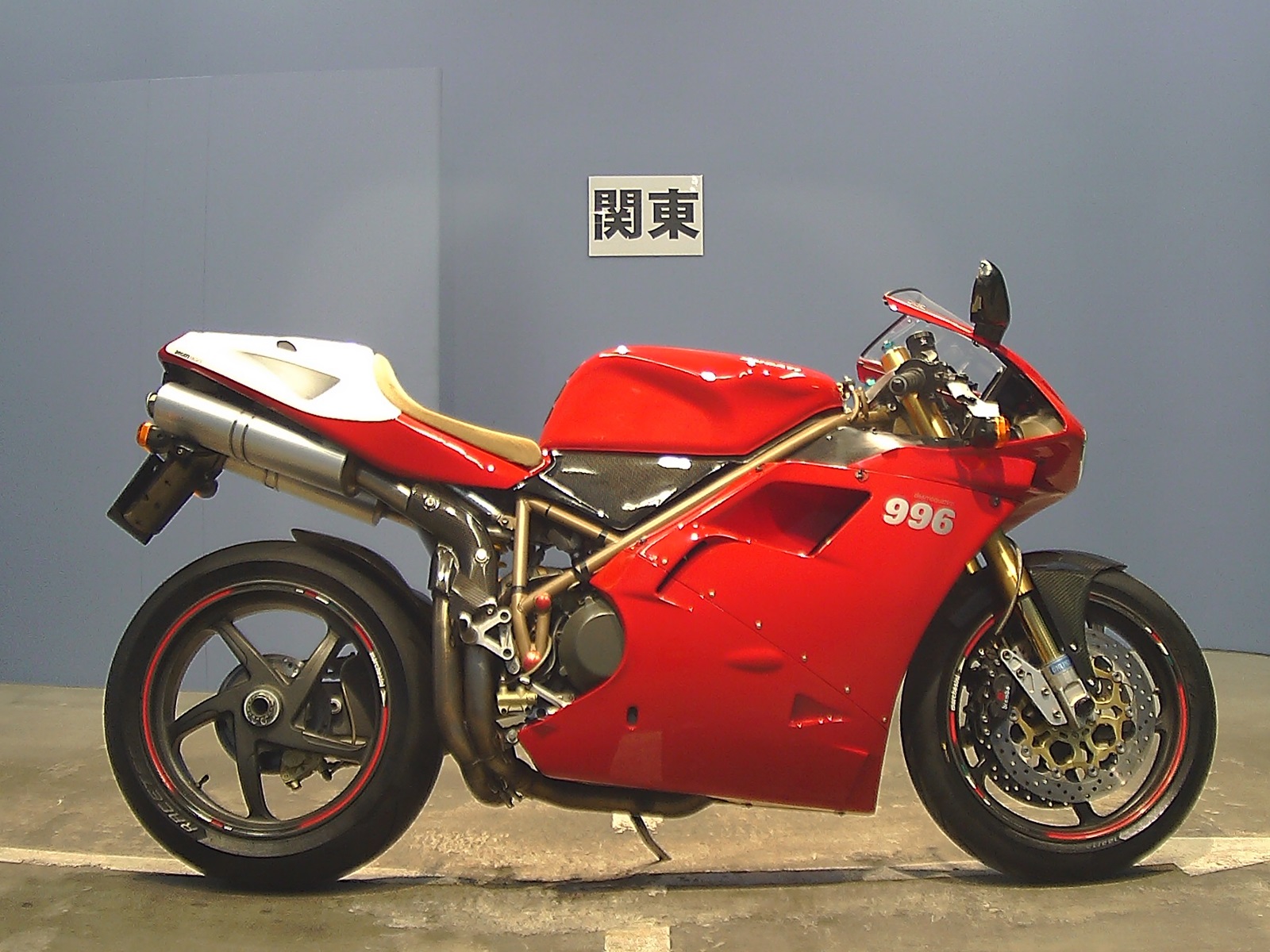

    Im looking to bid on this but can not see it in person. Have been reading as much as I can but still have so much to learn so looking for some help if possible. The obvious key issue I can see with this bike is the incorrect forks although stock ones come with it. Seat cover is another obvious issue. For those of you familar with the 1998 996SPS is there anything else that doesnt ring true? Bike has approx 10k KMs on it.

  2. They didn't do a 2008 sps

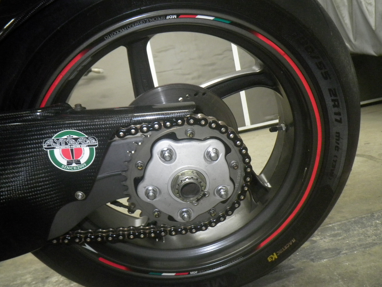

  3. Are 3 spokes meant to be fitted to the gold framed bikes?
  4. Photos aren't much to go on, but check computer under seat, check for twin ignition pickups and head casting should not have DOHC cast in if it's an SPS.
    On the good side, the connecting exhaust pipes look correct, and it's a mono rear subframe..

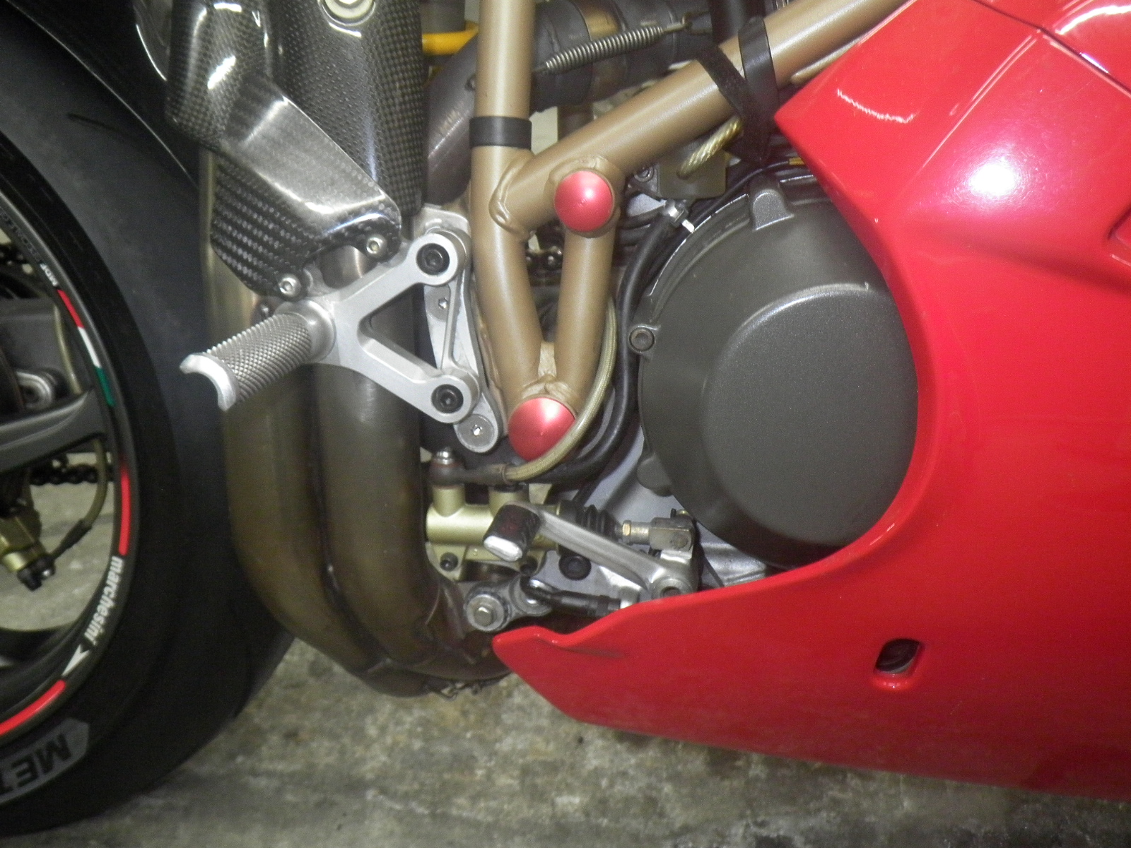

    If your after a standard SPS there are other little bits e.g. footrests that look aftermarket.

  5. My 99 gold frame SPS has 5 spokes.
  6. Not original forks, should be showa.

  8. You could get £1500 back for those forks which look way to high.
    Nice STM rear sprocket carrier means one less thing to worry about. Has a few after market mods but looks better for it.
  9. Mine too. This bike looks genuine as far as I can see, bar the forks and the seat as already mentioned.

  11. I thought the 916SPS had 3 spokes and the 996 had 5 spokes.
    Of course I suppose it also depended on what Giuseppe had in the parts box at the time, same as with the carbon parts....

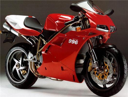

  12. It should look like this one,
    Footpegs are incorrect on your one.

  15. that model year had those dark anthracite wheels fitted, i remember lusting after one on display when i ordered my first 996 in 2000
