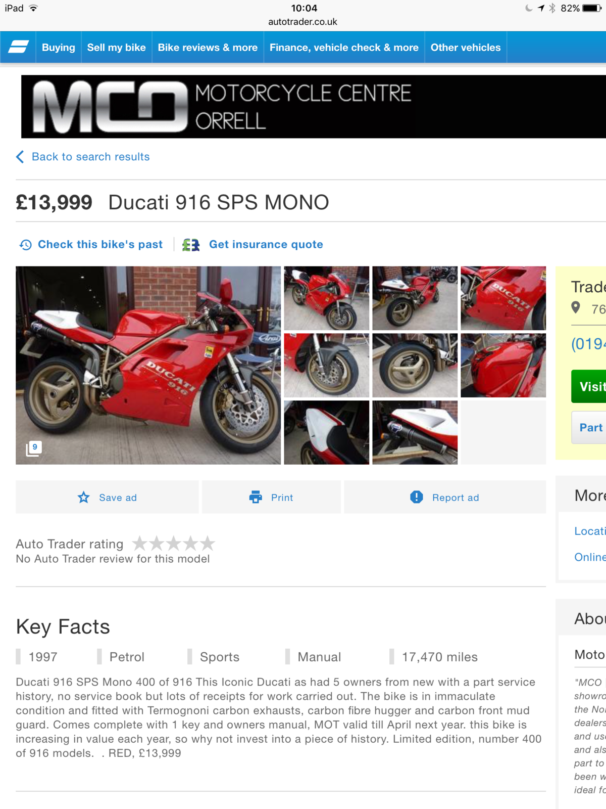

  1. Looks nice but the 916 SPS wasn't a numbered edition was it ? Did the 97 model have the 996 engine ? What's with those discs.....only asking before I travel 100 miles to have a look.
    Anything else not original ?
  2. They look to be the correct discs for an SPS, think the mirrors should have been matte black though. Engine is 996cc, look at front head through the splashguard, casings should be blank. Thats a salty price for a 5 owner bike with 1 key and patchy service history.........
