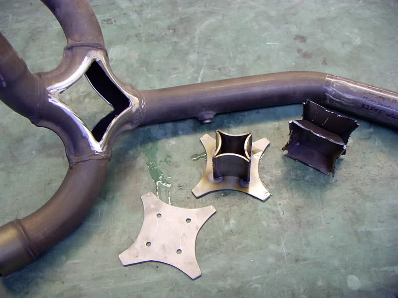

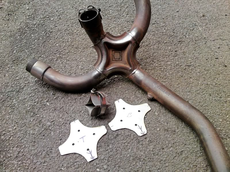

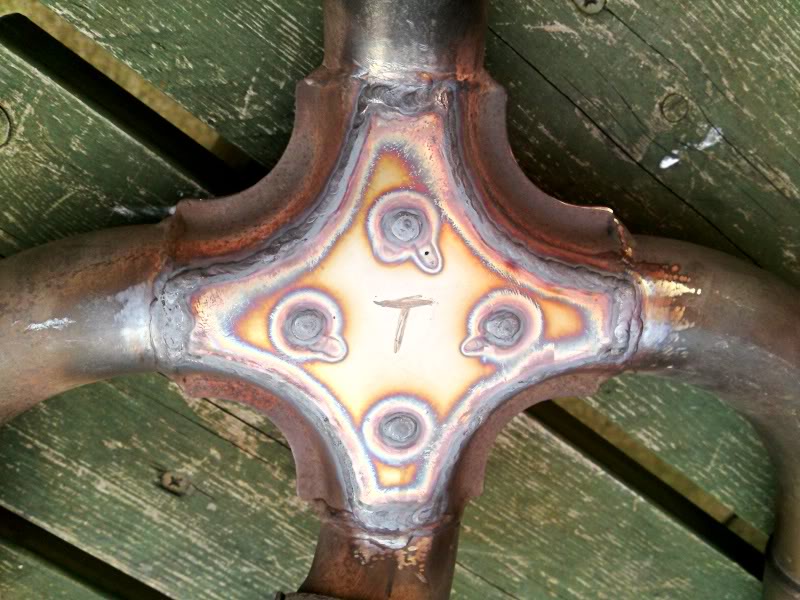

  1. Has anyone on here had any real experience with the exhaust mod below which I found mentioned several times on an American based Ducati forum?
    The restriction in the crossover section shown would appear to make it worth while.
    It's an easy one for me to do in my workshop, but I'm wondering if it's worth doing.
    Thanks
    Nasher
  2. Absolutely do NOT do it. We tried it on race bikes as did others, all with the same result. It creates some kind of echo/reverb in the pipes and buggers up the running. We lost midrange power and wouldn't rev past 7k. Admittedly this was on 600 and 620 engines but I wouldn't be surprised to see similar on a 900. I'm guessing the guys at Ducati actually got it right when they designed it that way.
    Sent from my SM-G925F using Tapatalk
  3. I spoke to Geoff at Baines racing about this a few years ago, he said it wasnt worth it, the pipes are designed that way for a reason and the 888 has a similar crucifix and puts out more power that our Supersports. The downpipes on the 600 are smaller in diameter but I dont think that would make much difference. I would personally not bother. Get a Sil system ;)
    Geoff did say that these exhausts are not as restrictive as folk make out. He should know.
  4. Thanks guys, you've saved me a bit of work.

  8. I got the mod done on a 1000SS, - it improved the low/midrange pick-up.
    Remus cans is the only other mod.
