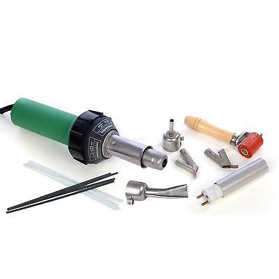

  10. We use something similar to this at work (plastic welder) with the nozzle on you can control what it warms up.
    If you warm the end of the strainer up you should be able to colapse it and pull it out with some needle nose pliers.
  11. Thanks Keith Mac, that's what I'll do then.
  12. As has already been suggested, I'd opt for the heat and squash method of removal.
    Just take your time as you have already suspected, you really don't want broken mesh and plastic floating around in the sump and oil galleries. Especially as the filter you are removing is meant to prevent that sort I thing. That would be really ironic!
