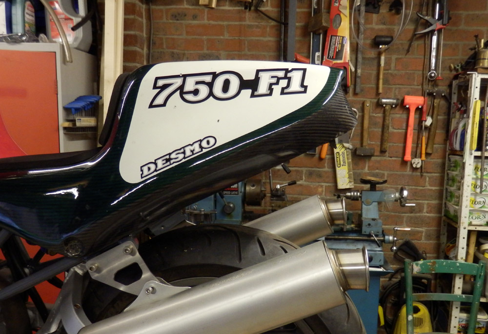

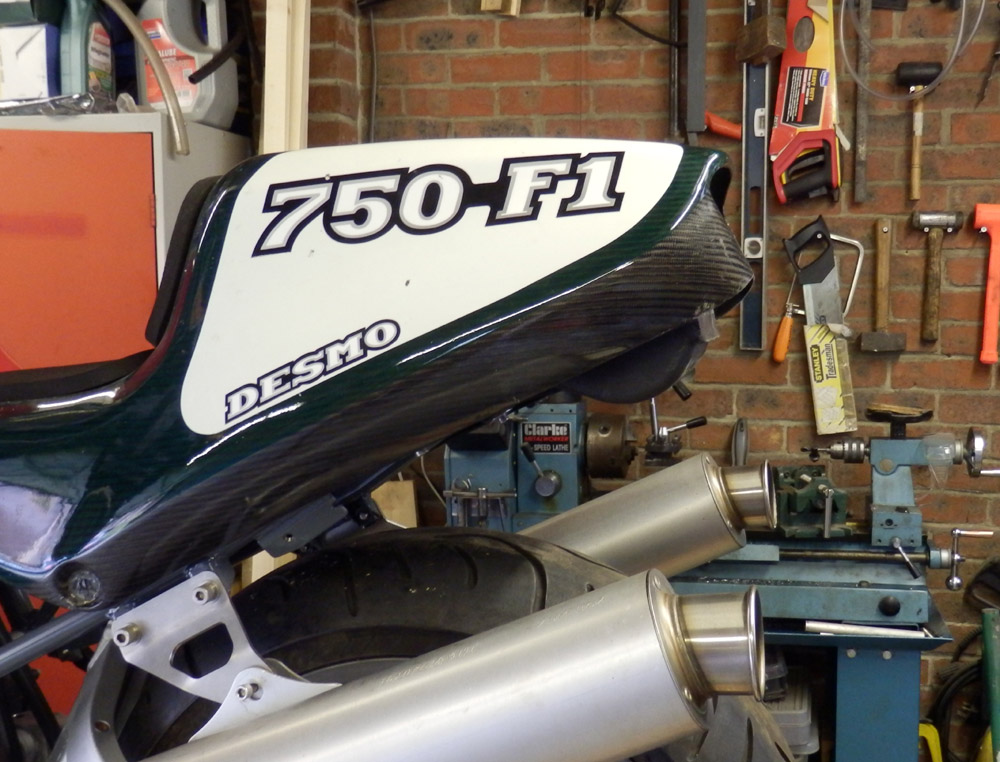

  1. I’m really struggling to get time in the garage at the moment to work on my 900SS Mongrel build, so when I had a couple of hours to myself this afternoon I had a better look at the rear end.
    I’ve adapted a Carbon Superlight seat unit to fit the bike so it comes on and off with the key as I want to use the standard storage locker under the seat:
    https://www.ducatiforum.co.uk/threads/images-wanted-ss-with-non-standard-seat-units.50464/

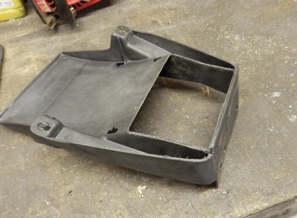

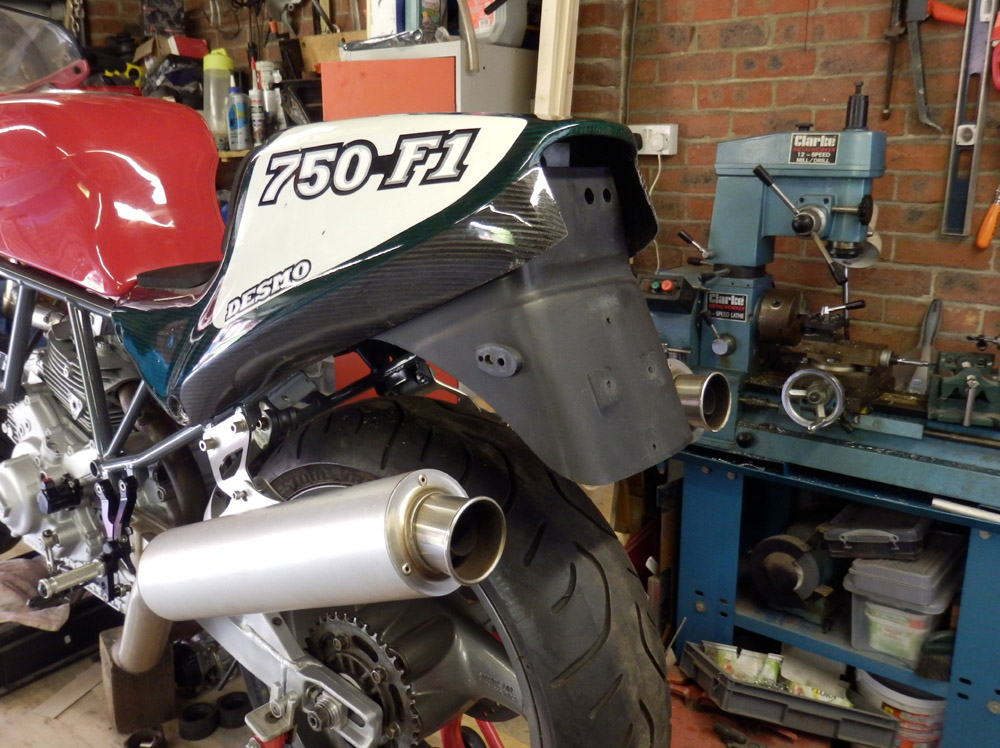

    The standard storage unit comes as part of the rear mudguard which looks a bit big:
    But when you cut it off you’re left with the bottom of the storage area sticking out, which also looks crap:

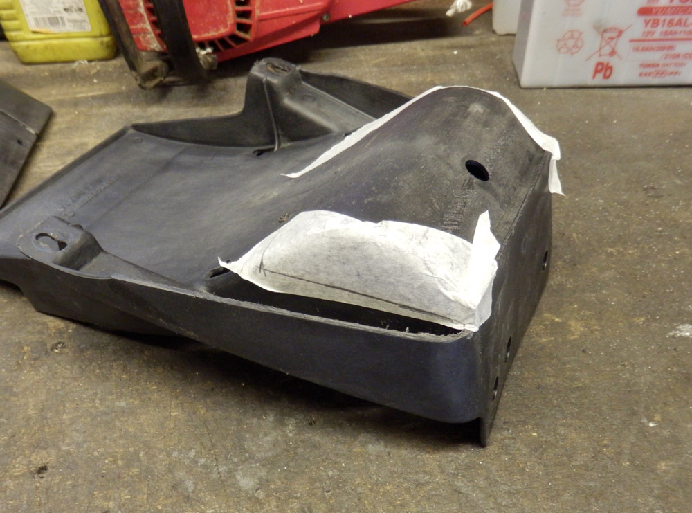

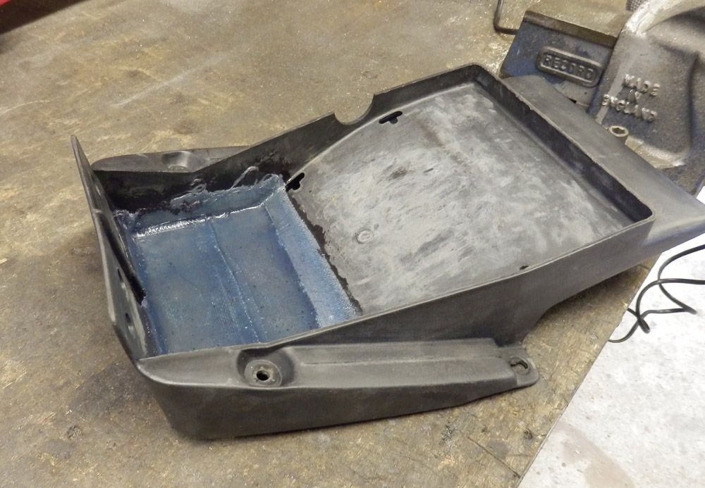

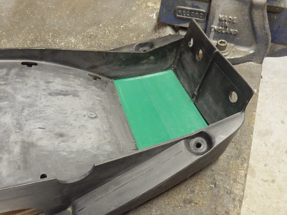

    I decided to cut it out and create a new ‘floor’ using fibreglass.
    Here it’s taped down to a piece of wood covered in green parcel tape that the resin won’t stick to.

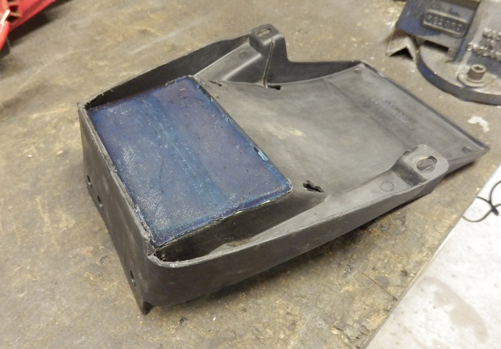

    And here it is 1/2hr after the resin and fibreglass mat went in.
    It obviously needs a bit of black flowcoat to finish it off, but I’ll do that when I mix some up for another job I have planned.

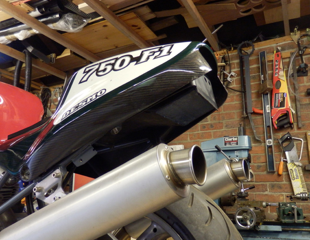

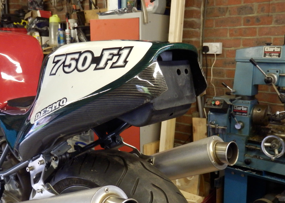

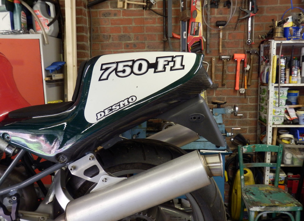

    On the bike it looks much better.

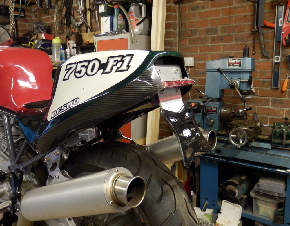

    I even managed to rough out the number plate bracket and decided how I’ll mount the minimal rear lights I’ll be using.
