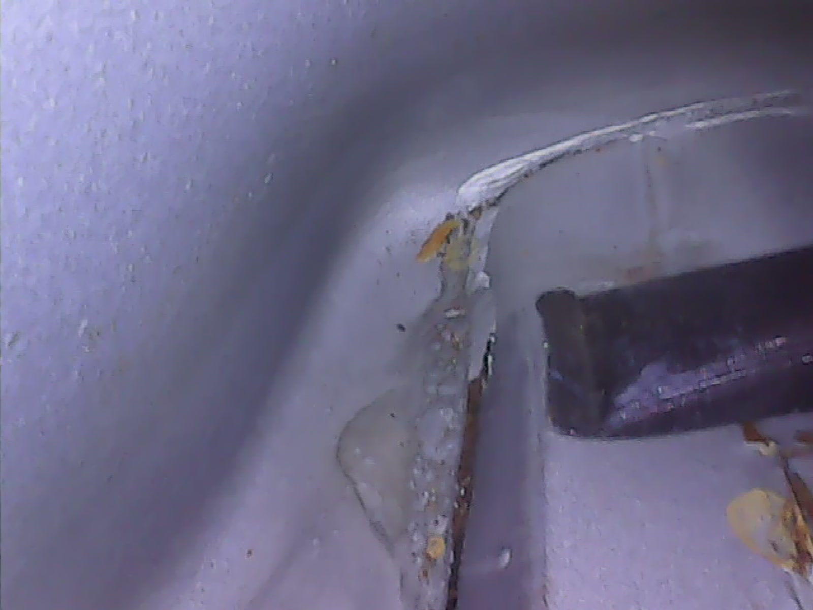

    The inside is also in very good condition compared to some, with no surface rust anywhere except a very small amount inside the seams at the rear end where they all rot out first, and a little on the Fuel Pump bracket.
    The limited amount is purely surface rust and has not yet got bad enough for it to burst the seam open.
    I’ve had my endoscope in the tank and the seams further forward all look perfect.
    But what I’m not sure of is that there appears to be a small amount of seam sealer in the seams that looks to have been put in by hand just in the seams, it’s definitely not epoxy sealant sloshed in to repair the tank.
    Some of it has popped out due to the rust and I’ve removed it.
    Is this Seam sealer standard and put in from new?
    Also, the inside of the tank appears to have been sprayed Silver, again it’s definitely not sloshed in epoxy sealant.
    Is the Silver paint standard from new?

    I’ll try to get some better images later, but this one from my Endoscope makes it look far worse than it looks in real life now I’ve got the filler neck removed.

  2. I don't recall them, especially around 1990, being painted inside, but may be wrong. However, as you can reach inside, is it worth buying a tin of ethanol-proof sealant - the type that gets sloshed around - and daubing some on, exactly where you want it, with a paint brush?
  3. My 1993 tank is completely bare metal inside and no seam sealer. My now sold 97 was the same.
  4. Some ethanol proofing sealers are more ethanol proof than others. Caswells do one that seems to work, others less so. It is about 70 quid after delivery and VAT for two pots that treat about an 18 litre tank

  6. I've used POR15 tank sealer on 3 x SS tanks. Works very well and had no issues. I'd do the whole tank though, kinda makes sense to me.
  7. Ditto my 1997.
