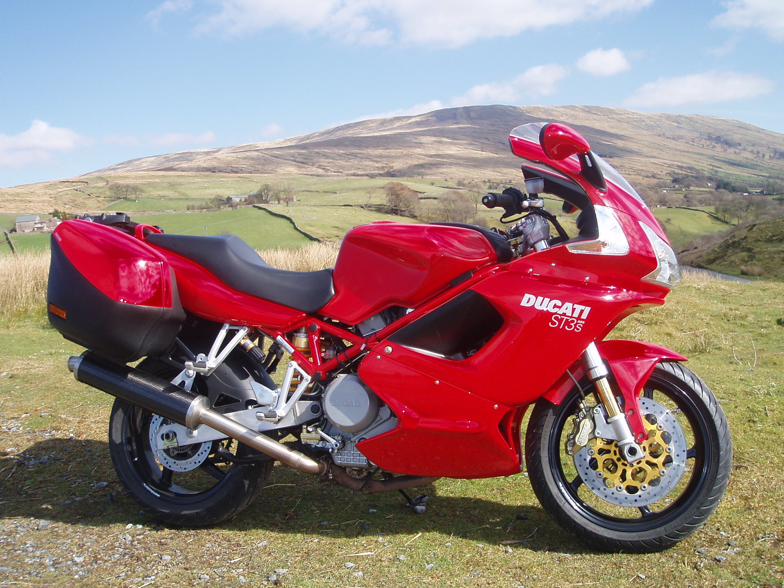

  14. I've had the st2,4 and still have the 3s.
    47k miles on the st3 now and the only thing to watch are front wheel bearings.Mines been two up fully laden for all of those miles.
    It's not as comfy as you'd expect as it's more sports than tourer.
    I now have the 939ss and this is actually more comfortable for the rider but not passenger.However I would never be without the st3.
    I've given it a hard life but looked after it and I still get comments of how well it looks.
    Buy one, any you won't regret it. The st3 has better fuelung for around town.
