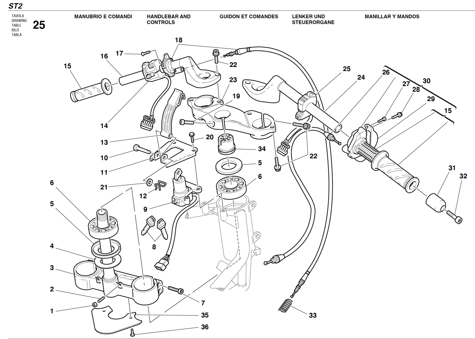

  2. No chance, unless you drilled and tapped the SS top yoke. You might get away with fitting the ST top yoke as both the SS and ST use 50mm fork tubes, although I don't know if the offset is the same, but I doubt very much if they would clear the fairing. You might look into riser clip ons.

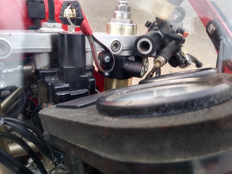

  3. ST4S bars will fit , I used to have these ones on a Sport Classic. IMG_2802 (2).jpg

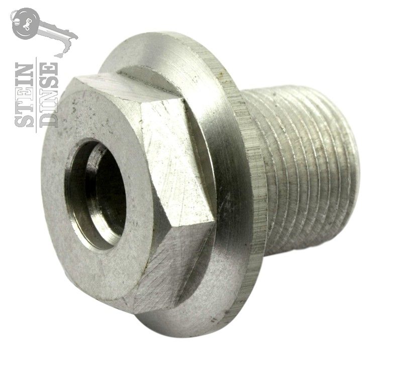

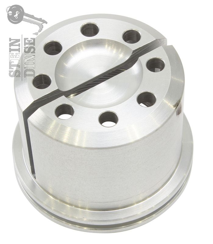

  5. as others have advised, suspect clearance of fairing maybe problematic, the ST bars are fixed in place, also the steering stem arrangement will differ, simple nut on your SS whereas the ST has the larger captive boss type fitting, from memory offset is same, best of luck with it, be interesting to see how you get on.

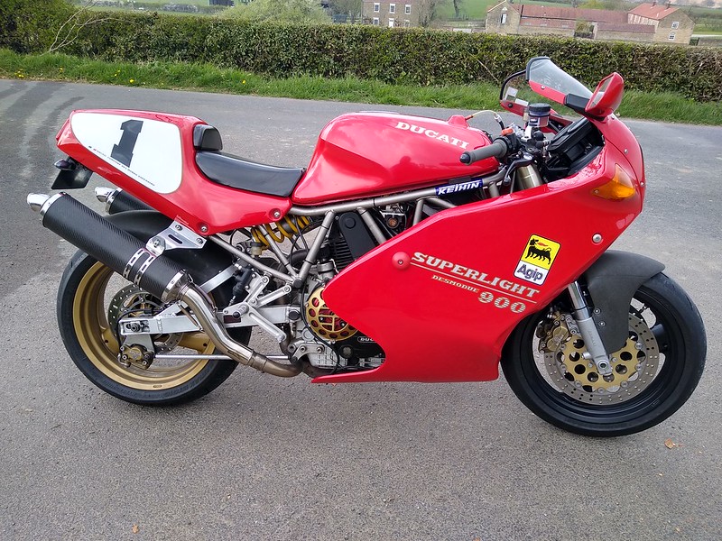

  7. I have Woodcraft clip ons with separate tubes on my Superlight. I suffer with arthritis so I simply swapped the clamps over to make the bars almost flat and it made a world of difference. It looks strange but it's the difference between not being able to ride the bike and being actually comfortable!

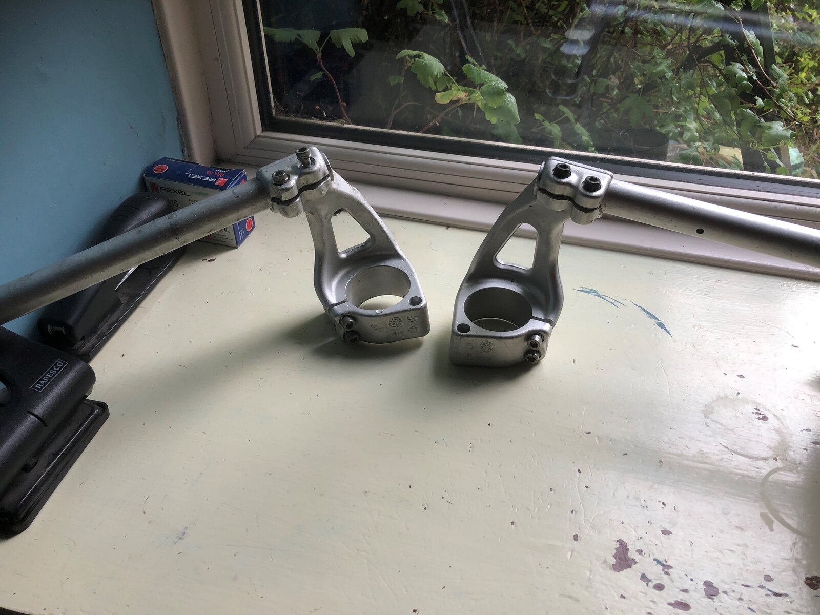

  9. It's probably hard to tell from these photos, but hopefully you'll notice how flat the bars are.
    Woodcraft clip ons aren't cheap, particularly after import duty, but you can get several different heights.
