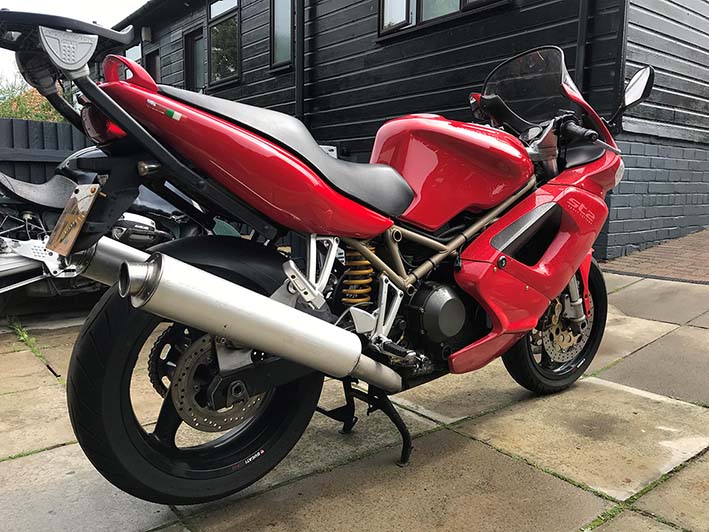

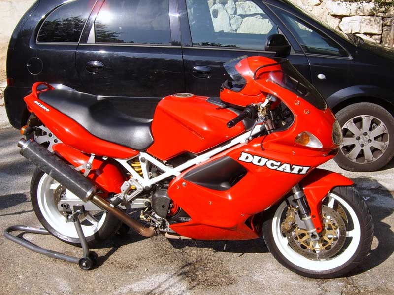

    So… Wish me luck and please follow my progress. I have already bought the bike and made a start…. And here it is. She does appear to be quite photogenic, but don't let that fool you.

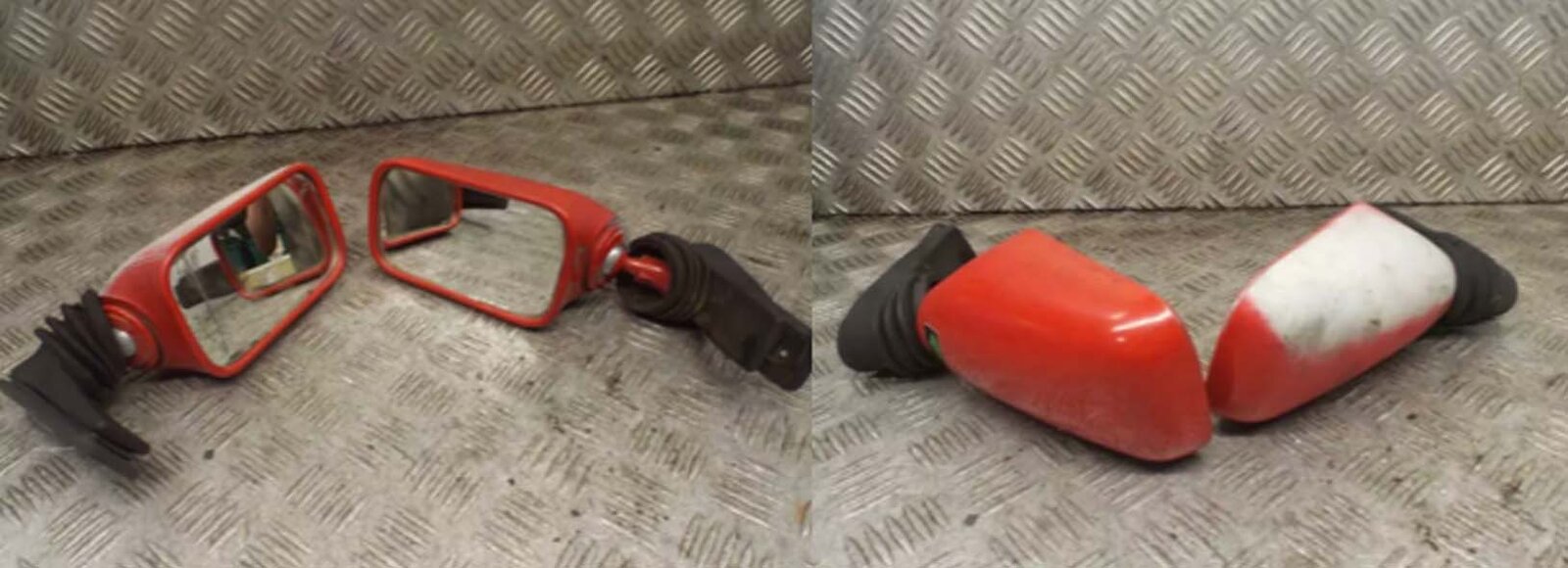

    I also found a lovely set of Vitaloni mirrors on ebay, which were rough when I bought them, but have subsequently been repainted (pic to follow) so I'm committed!

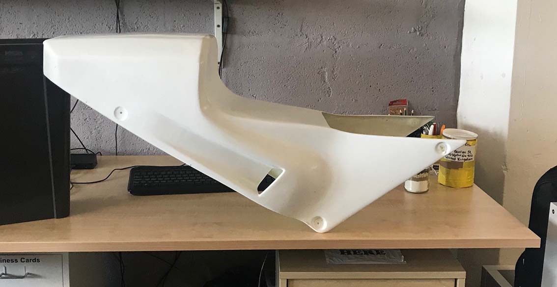

    The logical next step was to purchase the single seat tail unit used on the 851... The 888 one, just doesn't look as neat (again personal opinion). This one was snaffled on ebay for a decent price.

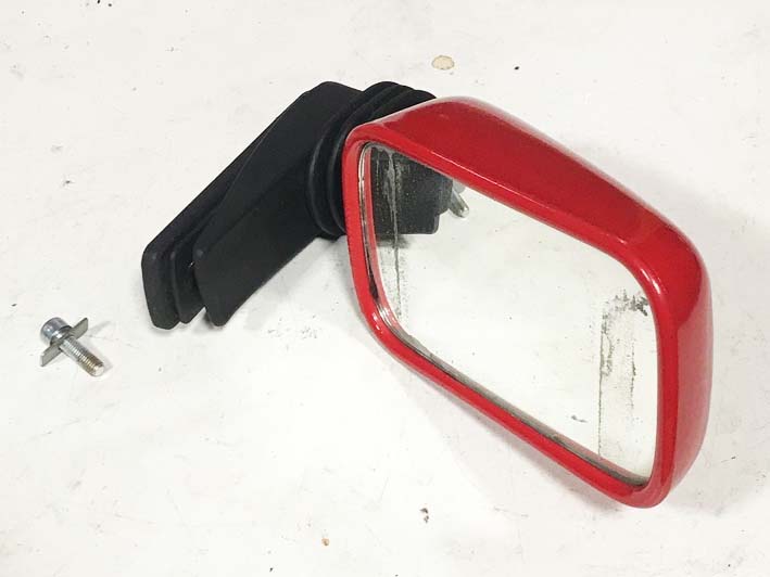

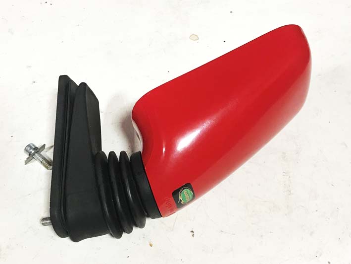

  8. Before I did anything significant with the bike, I bought a set of Vitaloni mirrors (as seen above), which were a little worse for wear. They looked faded and the mirror glass was stained, as if de-laminating, so I made the decision to clean up and paint the outer shells, clean up the rubber, but leave the glass.
    It has kind of set the tone for the whole build.

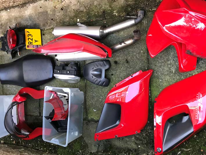

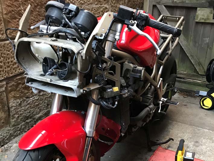

  10. I didn’t get a chance to ride the bike, because it had no MOT and had been sitting on old belts. Keen to crack on, I have just stripped all the parts I knew I wouldn’t want or be able to use and had a good look round the chassis. My top tip here is not to get rid of anything... I might need a bracket or a fitting later that I can salvage from the bits.
    When you see the amount of stuff that comes off, you realise just how simple the bike could be. The 851 race bikes didn’t have 6 piece fairings, or vanity panels around the clocks and looked far better for it. One of the worst parts (for me) is the crappy plastic Batman cod piece sitting in the centre of shot here. It surrounds the ignition and serves NO purpose.
    As I pulled it apart, I was beginning to realise how many parts I’ll need to source. Clip ons, front fairings, screen, headlight, taillight and indicators, but these things crop up on ebay all the time. I am intending to use the existing headlight frame, because it has all the wiring and instrument mounts and will hopefully only require a bit of modifying to suit the 851 headlight.
    It should be said, one thing I do know about Ducati’s is they share a lot of components. 851 headlights, taillights and indicators are the same as the far more popular SS series, so parts should be easy to get hold of. I am however under no illusion that there will be some tricky parts to source.

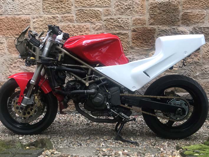

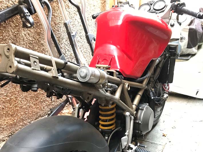

    I pulled a lot of stuff apart, so to finish off I thought I'd test fit my 'Thunderbird' tail.... I want to use the ST2 tank, because as I've said I really like it and it will save a shit-load of hassle and cost, not having to source / modify an 851 tank. It is clear however that the tail unit will need to be modified.
    I need to trim and fibreglass the seat unit to sit neatly against the tank, but that will be relatively straight forward. Also, I was pleased to see the rear frame was completely hidden, meaning I don't need to cut steel. That might have been a show-stopper for me, because I don't want to 'force' the build. I want it to look like it was meant to be together.

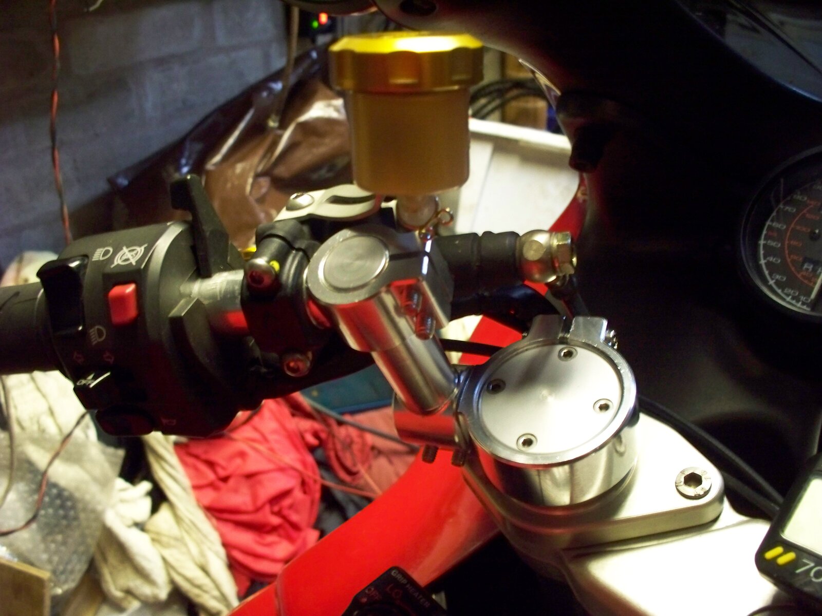

  14. Thanks for this... I have only really managed to mock up the position, by clamping tube (to represent clip-ons) on and it seems 'comfortable' (I used to have a 748, so my whole body has been recalibrated)... I'll try hanging actual clip-ons under the top yoke and see if that works, failing that I'll go for on top of the yoke. You are absolutely right though, I need to be able to ride the thing, without folding myself over the tank.
  15. When I had my ST4s Mike Shannon, who posts on here sometimes, manufactured a pair of stubs for me to fit on the top yoke in place of the handlebars. They enabled me to fit clip-ons above the top yoke.
