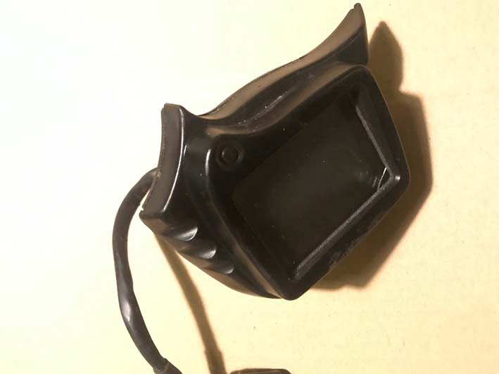

    Going over my mods to the bike, I removed the digital display... this one:
    I don't like it, so i put an analogue temp gauge in instead. The LCD did display some fuel data when the ignition was on, so just wondered if removing it has confused the CPU?
