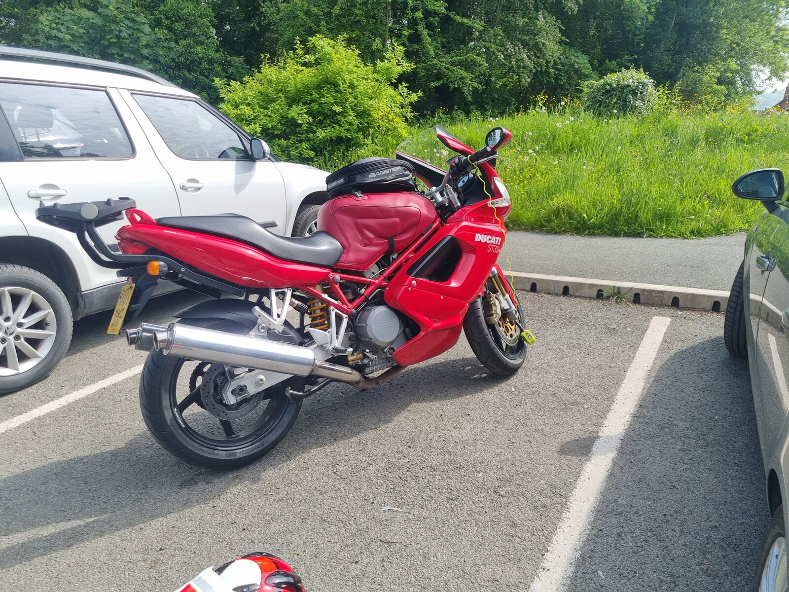

  2. I went with the ABM top yoke super helpful seller - stopped fiddling now and riding to work meetings as much as possible

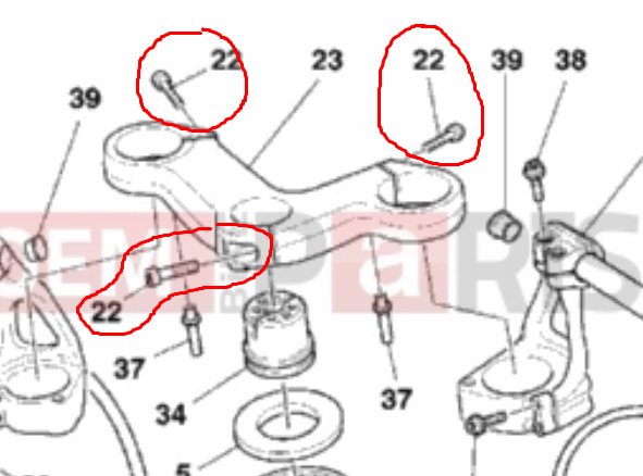

  6. I'm inclined to do the conversion myself, but I don't have that special tool for steering axle nut. Can it be purchased on ebay or is there some other trick?
  7. You can use a monster top yoke from a similar year. I think the stem doesn’t need a tool as the yoke clamps on to it.
    At 285 the abm kit is worth it. If you don’t need any other parts.
    #8 broadie, Mar 12, 2026
  8. Ahh...right, I just loosen these 3 bolts and remove yoke... upload_2026-3-12_17-40-37.png
  9. Bit of lube and a wiggle. Make sure you assemble with a torque wrench.
