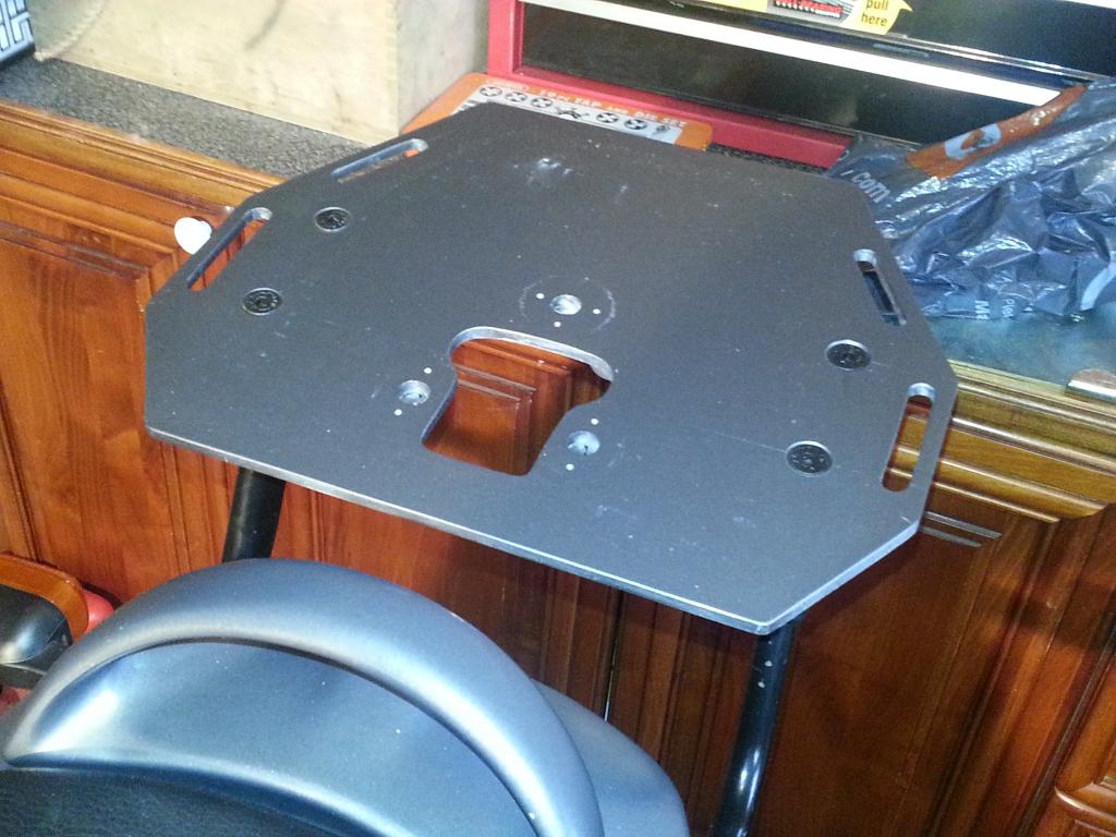

    Bought what i believe was the last genuine Ducati top box frame that's compatible with their panniers and then simply drilled the Givi top plate to suit the rack.

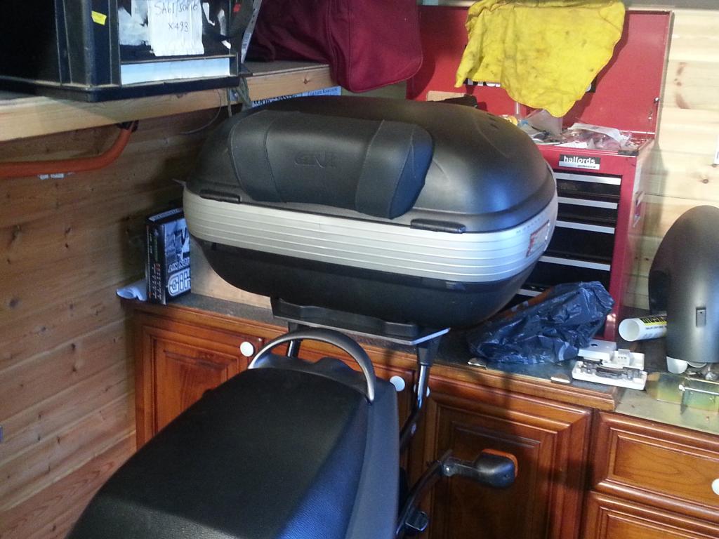

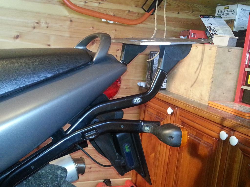

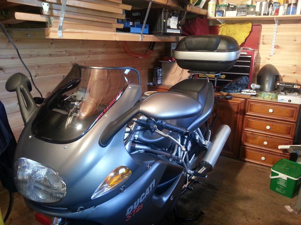

  3. I had same issue with my ST4s - was lucky enough to have the problem solved through the generosity of fellow member archer17.
    A pair of nonfango arms with sw motech adapter plate. I had to fabricate a new top plate but otherwise a perfect fit.

    great pics bolsover..thanks for that
    looking at the nonfango arms attatching to the side pannier carriers am i right in thinking its just a bolt straight on??
  5. Nonfangfo arms just bolt on - using same top two points as the side carriers. Bit of a fiddle - easiest to remove the side carriers and then re-fit with the top carrier arms.
