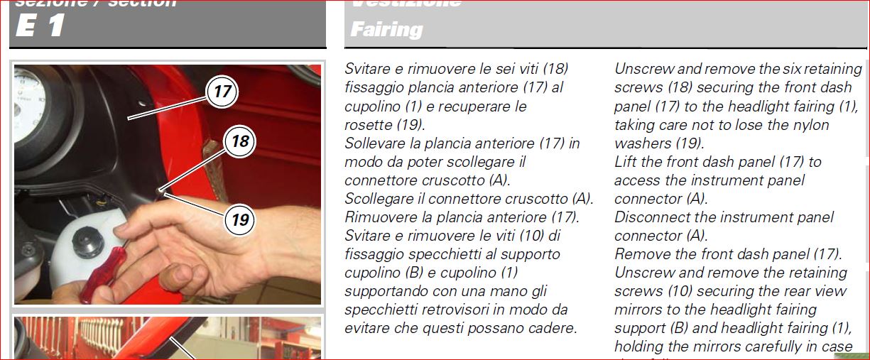

  1. To replace the screen, I need to remove the instrument cluster and surround. I have removed the 6 bolts as per the manual. It is still not budging. Faced with destroying the surround as that will be cheaper than the headlamp fairing cracking. The bottom surround is off - no problem. I cannot take the whole fairing off as I need the instrument surround off to get to the mirror bolts. The whole fairing has been off before just to replace a headlamp bulb and battery. That time it was simple but now it is not! Anybody got any (sensible) ideas?
  2. You have to remove the windshield bolts first. Didn't read manual carefully enough!
