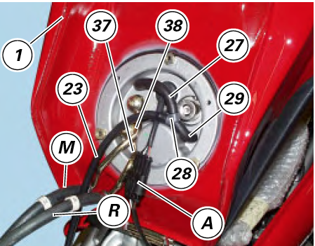

    I stripped of most parts for them before, including the tank as that needed cleaning out. I marked both rubber pipes L & R but when it came back all markings had gone. I have noticed there is a white ring on both pipes, 1 marked "M" the other "R".. Anyone know which rubber pipe goes on which metal outlet pipe from the tank?

  4. This is from the ST3 manual which uses the same tank. 38 is the feed, 37 is the return.
  5. cheers thats all ok
