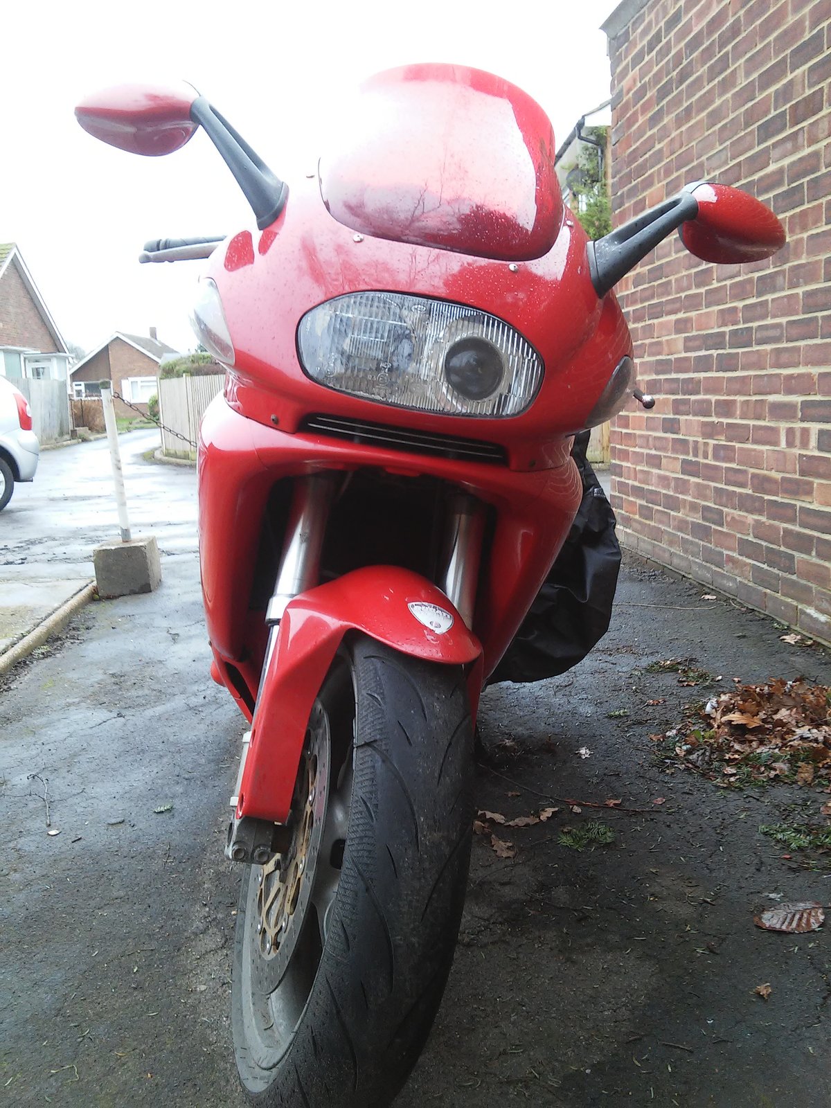

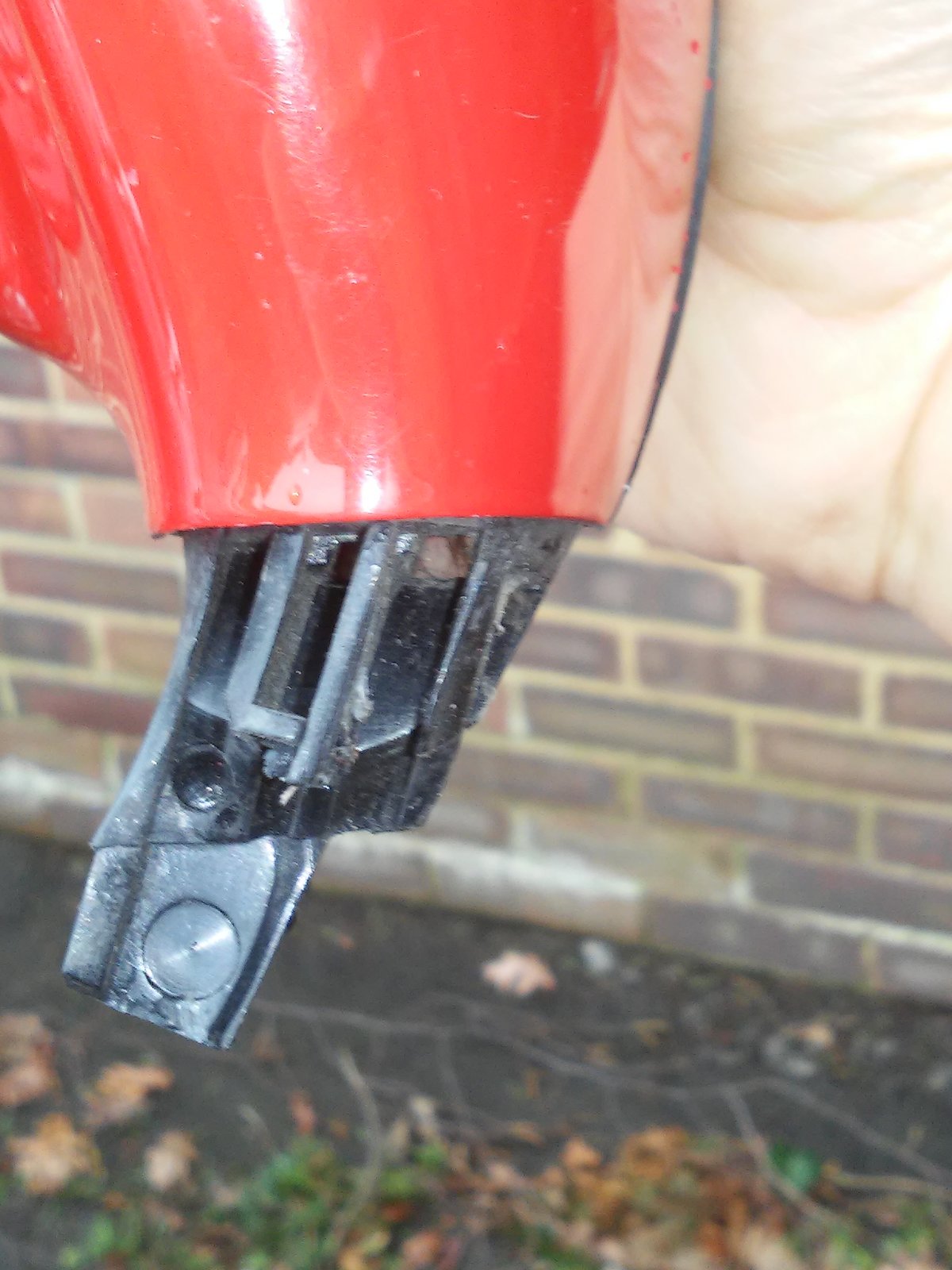

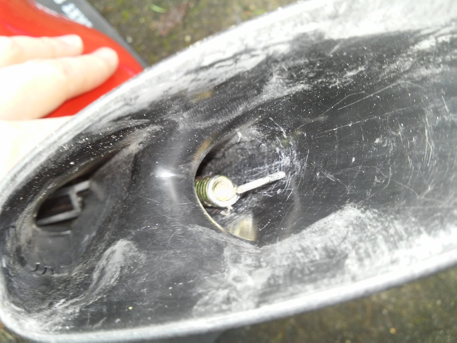

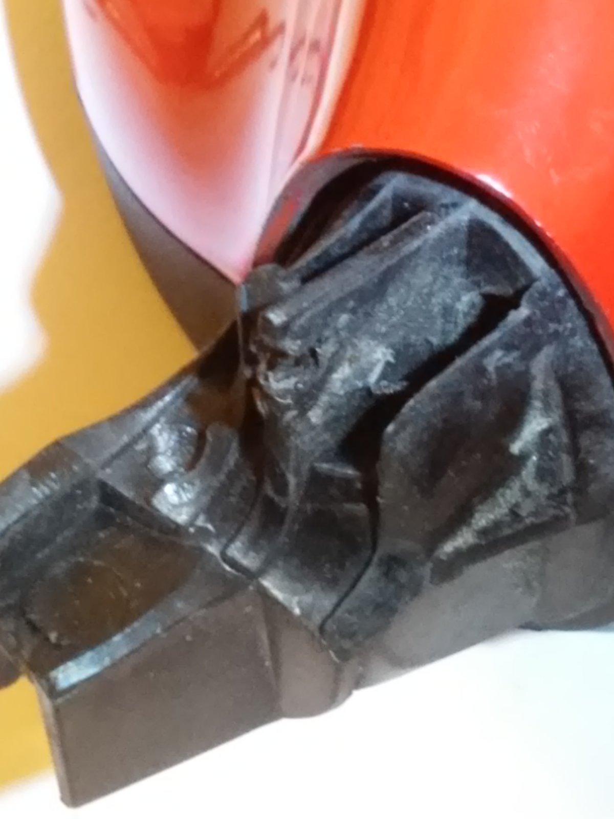

  1. My bike went over in high winds the other day, minor damage. worst if the rh mirror.

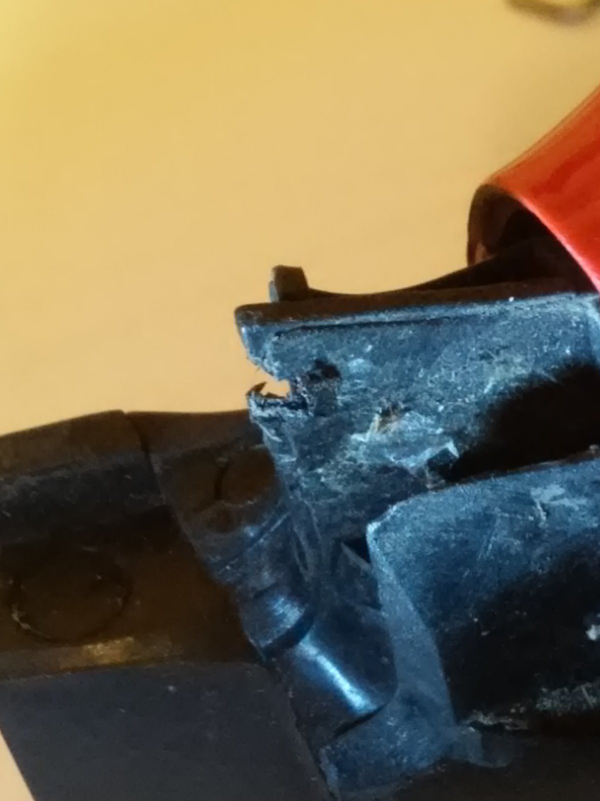

    as these are a bit thin on the ground I was thinking of trying to fix the existing one. The issue is that the hole for the spring has broken. what are your thoughts on drilling a new hole? will it be ok?
  2. Build it back up with Qbond and drill in the right place.

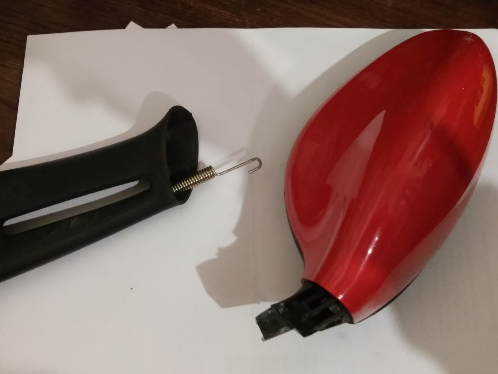

  4. It can be fixed! turns out I was wrong, the bit I thought had broken must be from the moulding process. The spring hooks in under the plastic casing.
    here's how I did it.

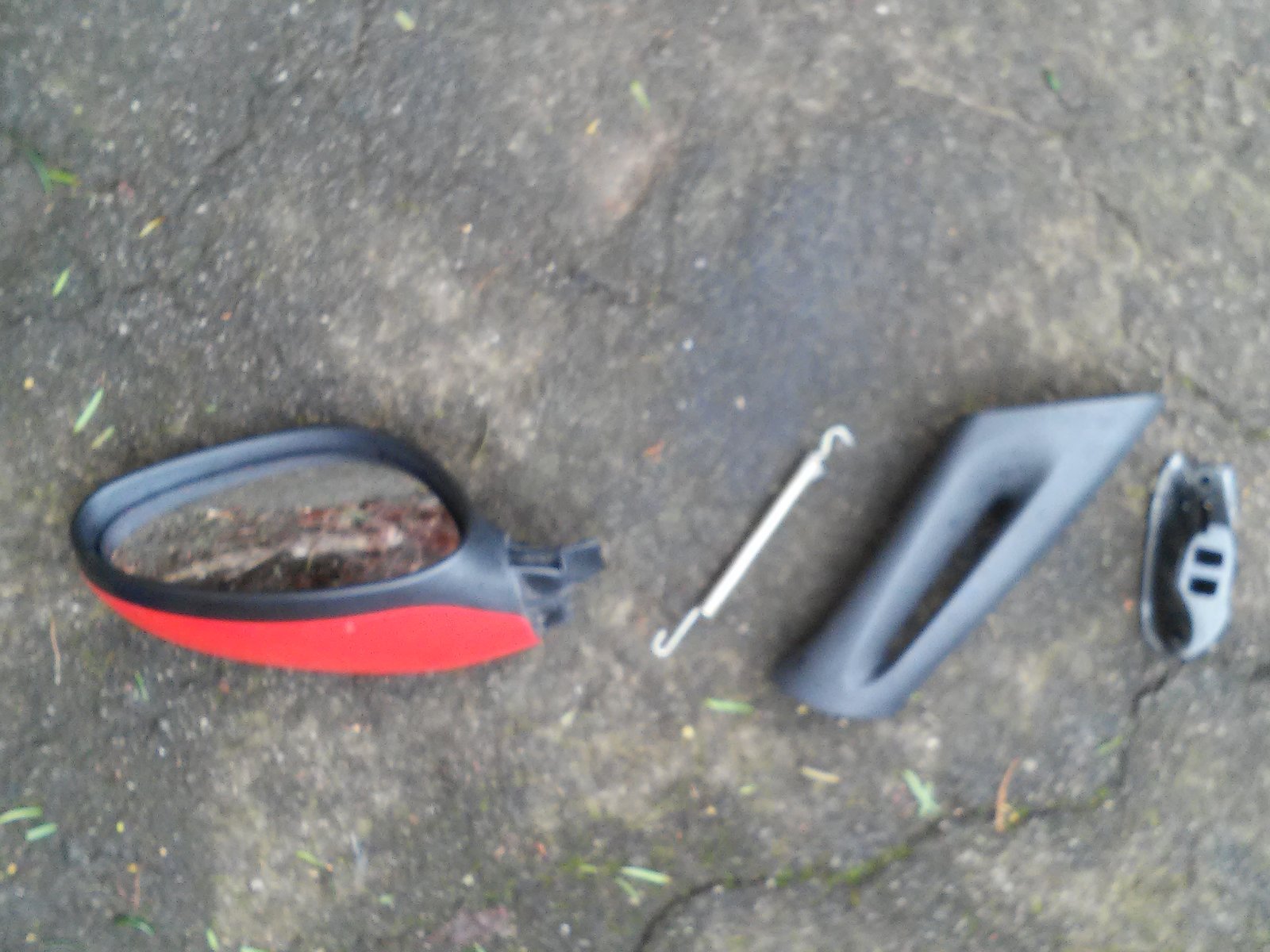

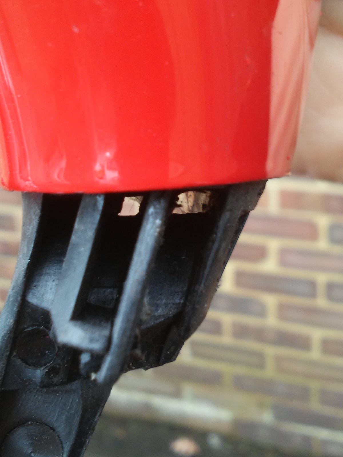

    1. Remove the miror base from the bike, you should have 4 components (mirror, spring, pillar, base)
    2. locate the eye just below the plastic case on the mirror where it would fit onto the pillar.
    3. insert the long hook end of the spring into the eye. this is an up and over motion (video too large to upload, sorry)

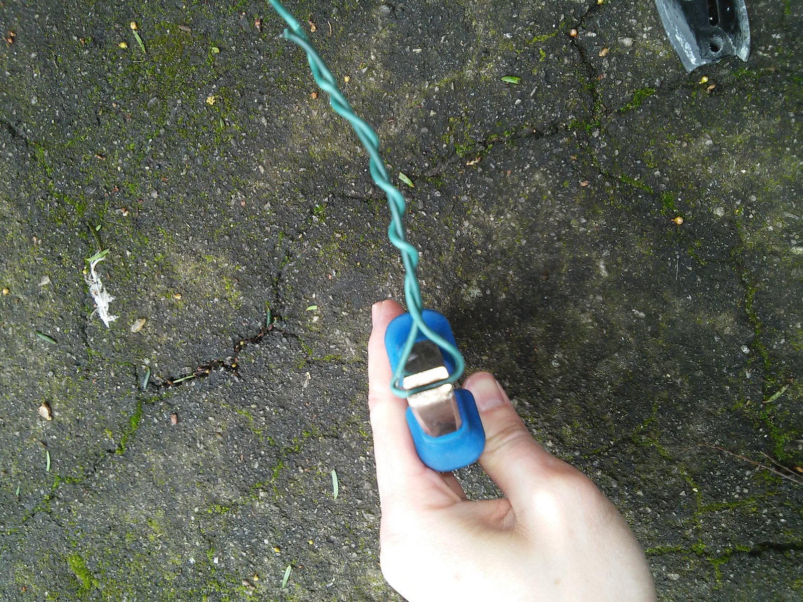

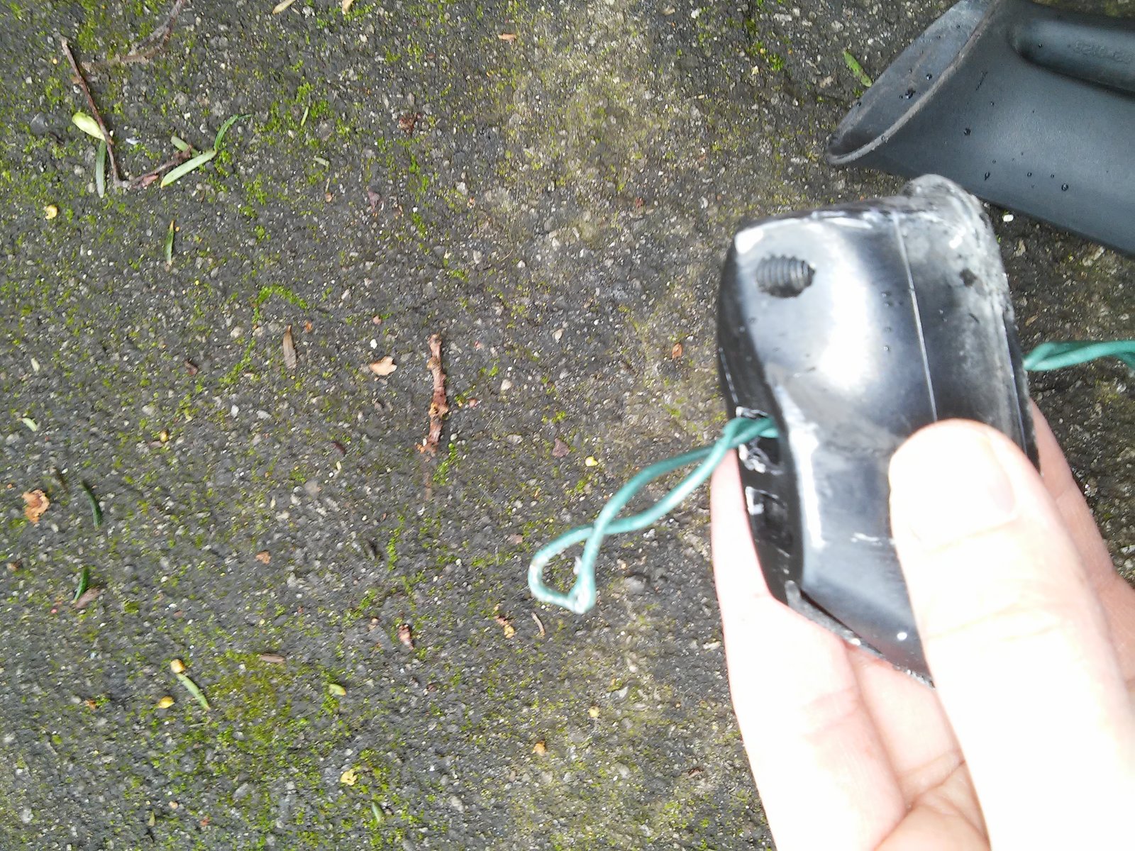

    4. the tricky bit - if you just put the pillar on the spring will be up against the wall of the pillar. You will either need a spring puller, or you will have to make one. I used some garden wire and a pair of pliers.
    If you make one, the loop will need to fit through the middle hole in the mirror base.
    5. hook the loop to the bottom end of the mirror spring and feed the rest of the wire through the pillar (choose the smaller of the holes), then feed the wire through the middle hole of the mirror base.
    6. Push the pieces together
    7. wrap the wire around the pliers, hold the mirror upside down (so you can see the spring) and pull until the spring hooks over the mirror base.
    Congratulations you've fixed your mirror!
