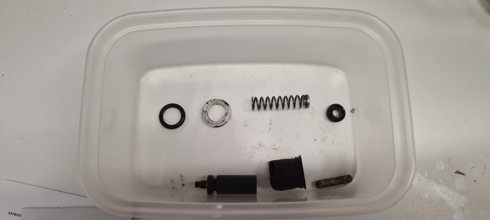

    I have the replacement kit and disassembled the old one
    Bottom Picture shows what came out in order from bottom left to top right

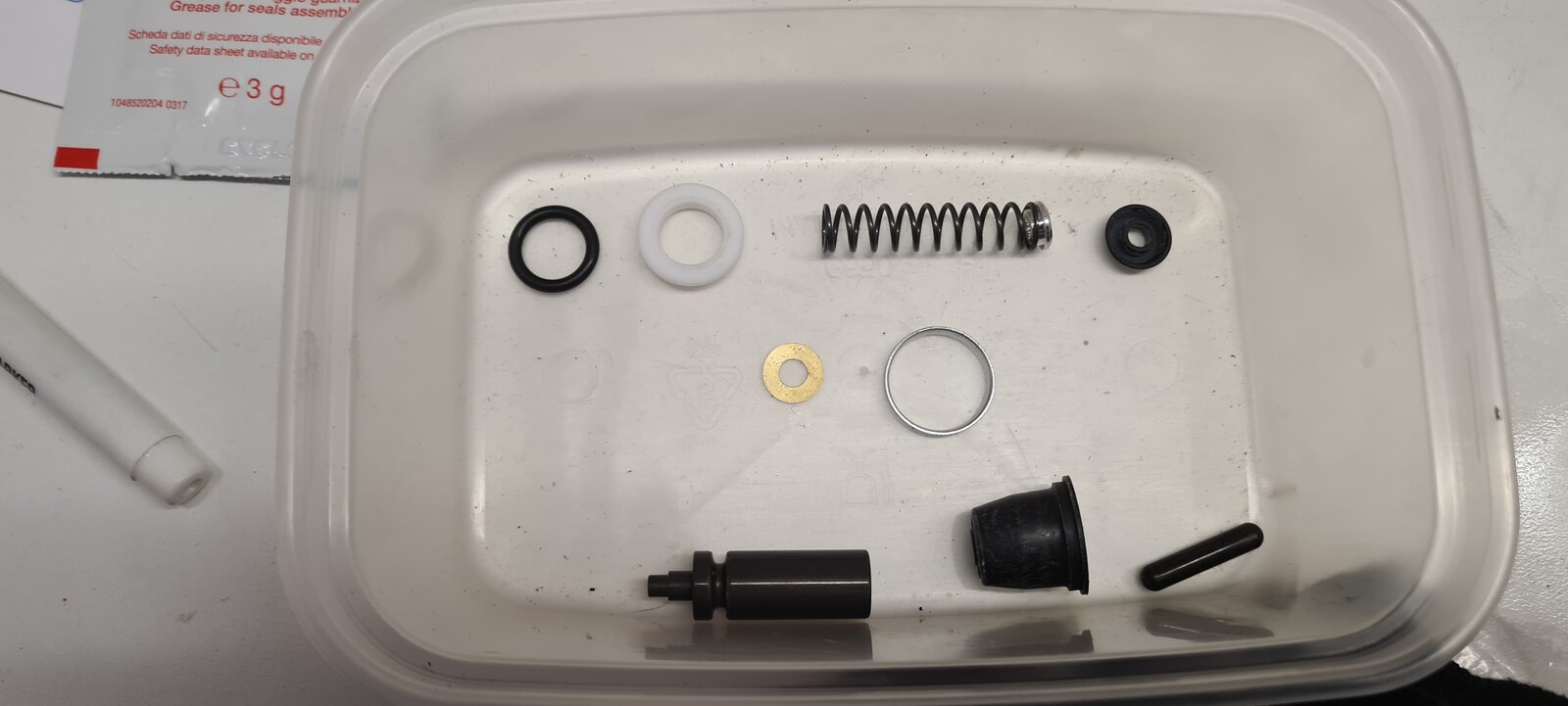

    Middle Picture shows the new kit but with extra bits in the middle.

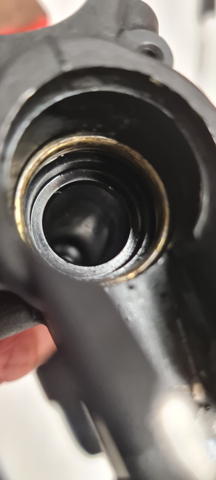

    Top Picture shows the empty slave
    The instructions show a Circlip of the barrel type (pushing out) and the need to use Circlip pliers to remove that. I don’t have this in old or new kit.
    What is going on? In top picture I think the gold ring is still in place which equates to the silver ring in the new kit. Am I right and how do I remove it (pic?)
    Where does the small gold washer go?

  3. Thanks Paul, I have like for like in the new kit. I think the spare small gold washer is for the outlet pipe which can be removed. The silver circlip looks spot on for the gold in place, its just I can't get the gold thing out! how do you get a blind circlip with no "ears" out? I may have already damaged the body !
