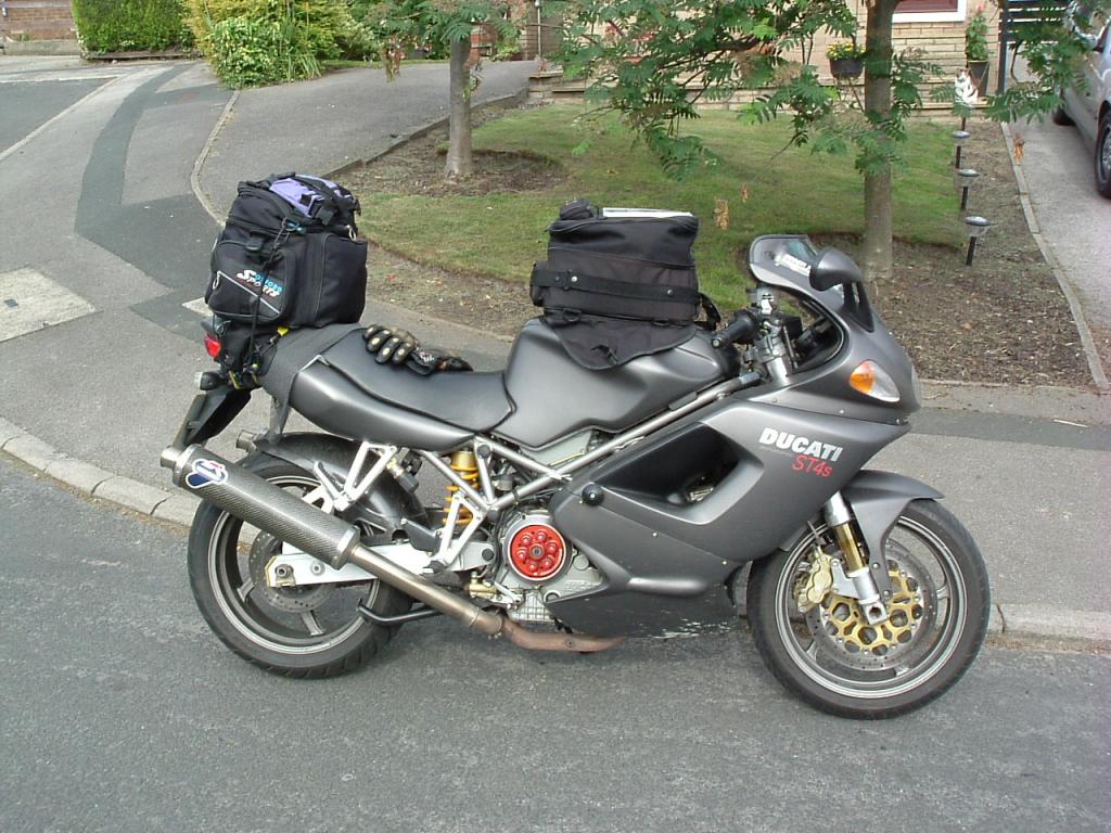

The bike that got me into Ducatis. One of the first ST4S registered in the UK in 2001. Bought new from Motorcycle World in Manchester when they were in business and a Ducati dealer.
