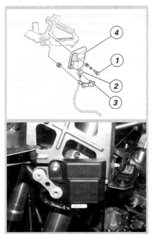

  9. Yes, often they are rotten with verdigris. Water runs down the subloom and collects inside the rubber boot at the bottom.
    Check also the two connectors of the immobiliser. (Item 4 in the pic)
    The terminals can get corroded and cause starting problems.
