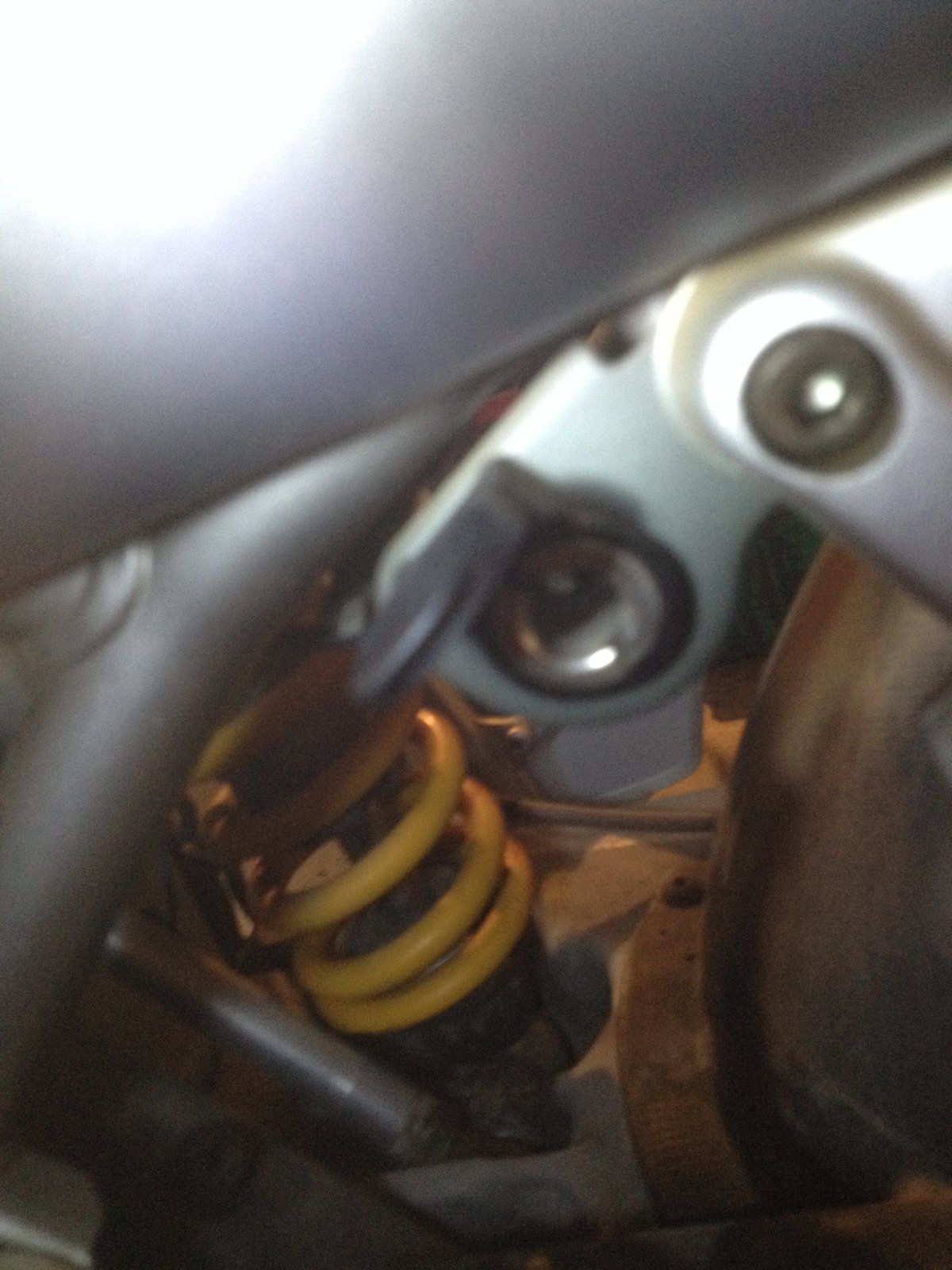

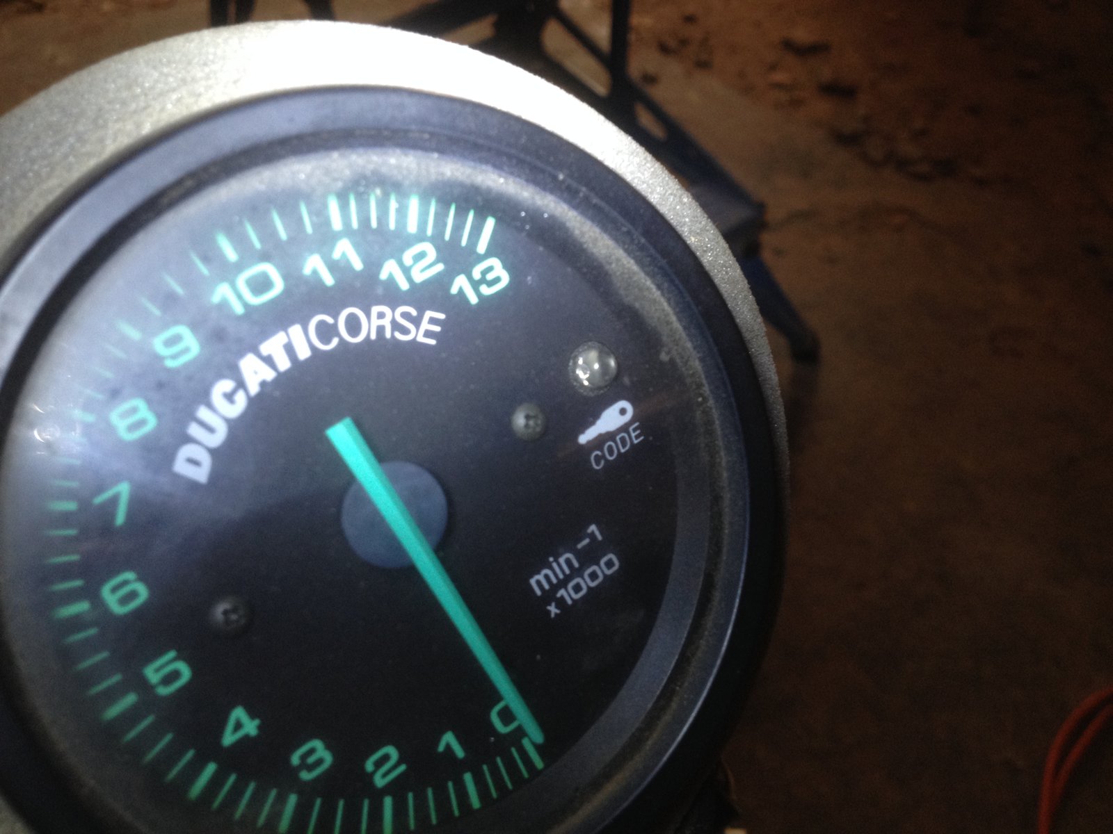

    Please can anyone advise me what the key code symbol is in the clocks and what looks like an immobilizer near the rear foot peg, as i don't have a key for it?? thanks
  2. The key symbol in the clocks relates to the immobiliser. If it doesn't recognise the key or develops a fault the LED will light up or blink a series of flashes. The immobiliser is under the top fairing at the LH side. It is linked to the ECU and keys. If you have no keys your best option is to have the ECU re-flashed to remove the immobiliser function.
    I don't know what is near you rear footpeg as I can't make anything out from that photo.
  3. Thanks Derek, have just found it on google but thanks again.
  4. Isn't the rear foot peg thing a micro DIN charge point? My Mutley had 2; one either side.
