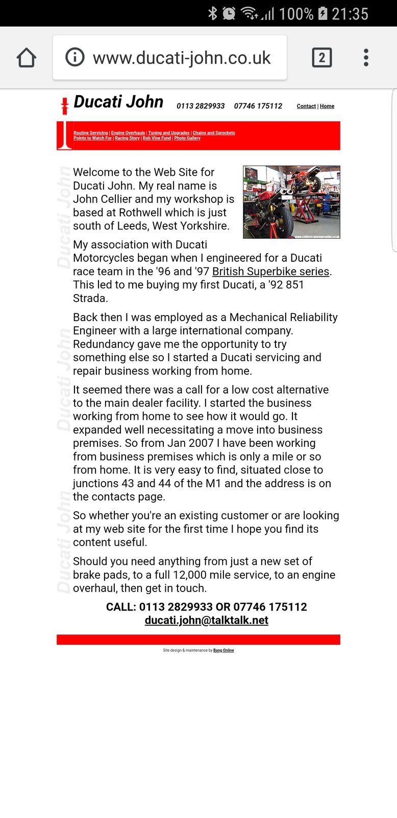

    Would it be possible to pass on Ducati Johns details please

  17. Spoke to Ducati John ref my starting issue , most grateful for his feed back and knowledge . Also thank you for your comments
